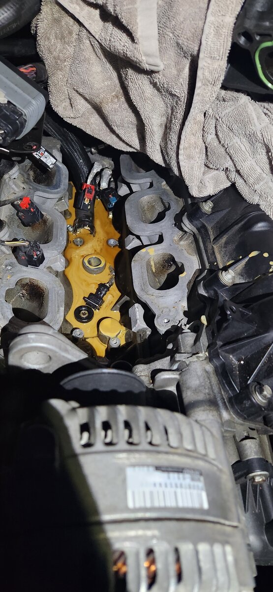

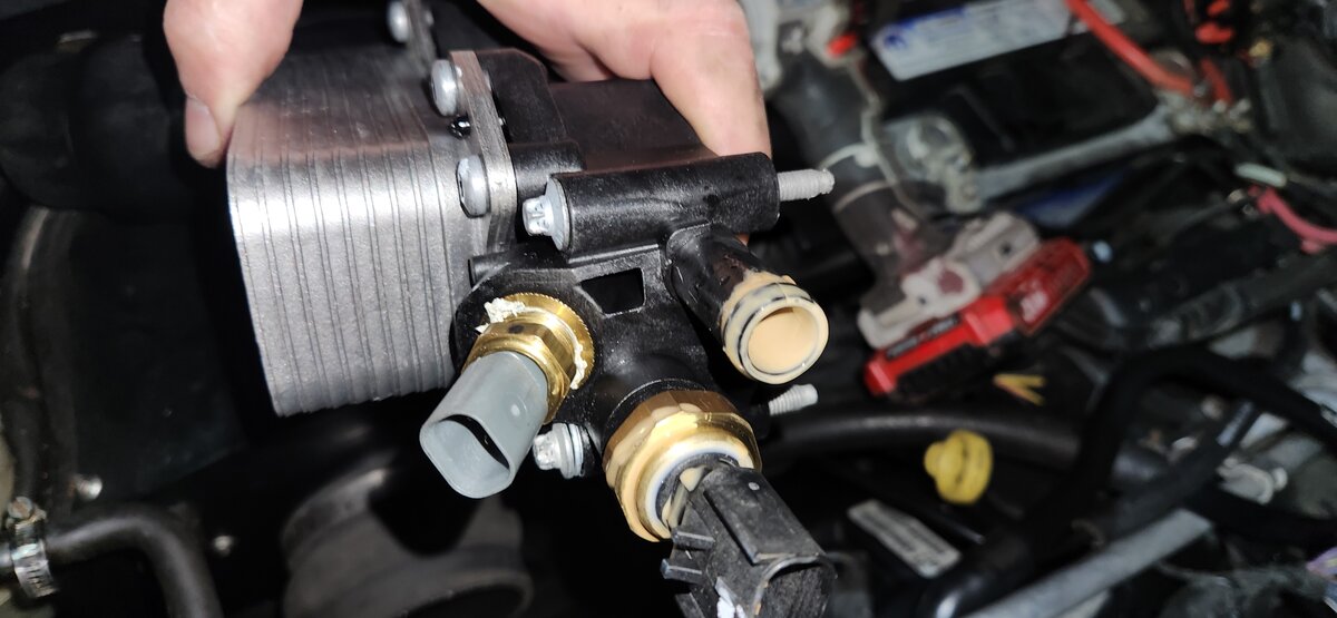

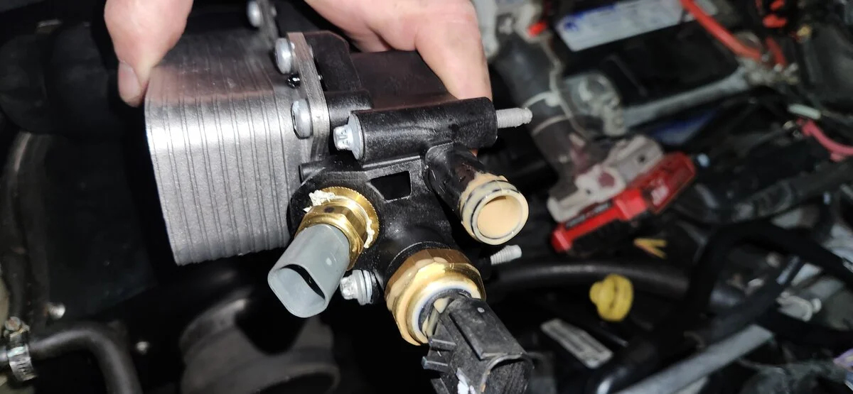

Oil cooler had failed. I had a shop install a new one. Six months later I had oil in my radiator again. Cooler was still under warranty so I took it back in. They told me it wasnt the cooler, it was the head gasket. Needed a new engine. My jeep has been parked for months until I had money for an engine. Had some time, pulled oil cooler. This was underneath. I'm guessing they lied because they didn't want to replace my whole cooling system? Would a head gasket cause this?

Thank you for this great answer! I'll check with the shop who determined it. It was running great, no loss of power. I noticed it was running a little hot. It never really overheated past 3/4. I let it cool off, opened the radiator, saw sludge and had it towed. Little pissed at the shop because I paid for an all aluminum oil cooler; just to find out they replaced it with the half plastic one. Plastic in an oil cooler is just asinine.
