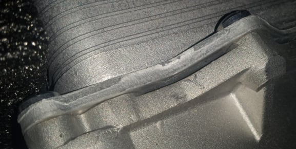

Has anyone had problems with the aluminum oil cooler when replacing theirs?

Having the oil cooler crack is something we all dealt with, but I Got an aluminum one from BELKEBIR, which is some Chinese knock off not doorman as I heard they had issues, but has anyone else had issues with theirs when replacing it with aluminum? I saw this on the side of the radiator on the unit and didn't know if this is bad casting or just apart of the molding process. The raised flat edges where the bolt goes in and around it. Anyone have any input.
Looks like the molding process to me. Mine had similar casting marks on it. No issues after 20k miles, "knock on wood".

Sounds good, never really sat up close to a cast object like this. What brand did you get? I got some unknown Chinese knock off brand not doorman.

I got the same. Doorman was on backorder when I needed 1. I do recommend if your OEM sensors still works, use it.
