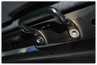

My 2014 leaked right at the footman loop dead center over the rear view where the latch is located. I took some electrical heat shrink, wrapped it around the loop and it tightened up the latch enough to stop the leak. Been good for a few years now.
It rains on my front center dash, going down hill and braking. Are you referring to that L latch, to snug the panels tighter?
That's the one.
This little POS right here (pic is not my Jeep):
Wrap a couple turns of electrical tape or electrical shrink wrap and it'll tighten the single latch that pulls both freedom panels together. Bear in mind the water coming down on the front of your dash and right over the face of your display is actually between the panels, not on the rooftop. Jeep is sitting still, rain gets down between the panels in the seam, only to find it's way onto the front of your dash the minute you hit the brakes...
