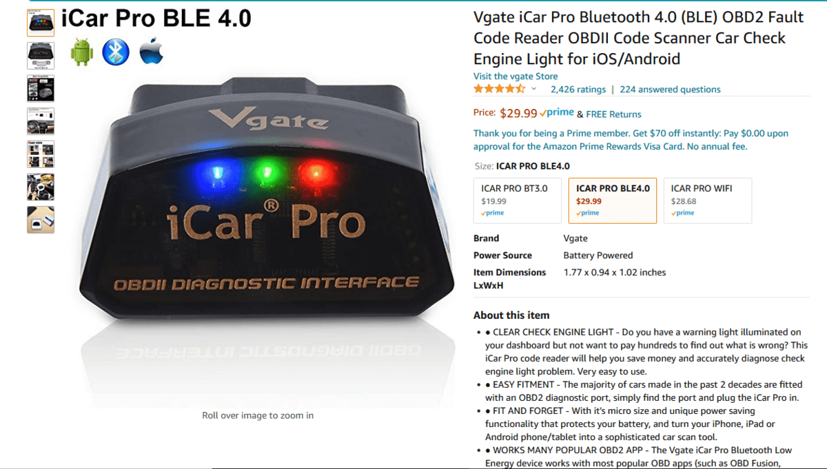

Which bt dongle do you use? Looking for one to set my tpms with app on iphone.
I just replaced my old one with this:
https://www.amazon.com/gp/product/B06XGB4873/?tag=jkforum-20
Reactions: Daddyo2373
I just purchased the iCar Pro about a month ago as well. Chris has recommended it on multiple threads and it is well worth the money.
Got my icar pro yesterday and downloaded jscan app and was super easy to turn off tpms, thanks Chris.
