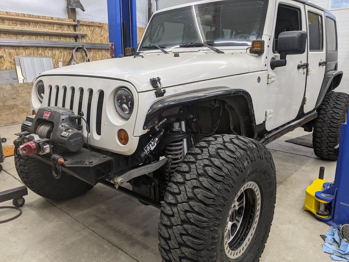

I believe a JK is in need of 2.5 inch shocks. A good remote reservoir 2.5 will have MILES better performance than any 2.0 that bolts in. Fox, Radflo, and King has OE 2.5 bolt ins. Radflo and King also have external bypass for truly smashing. :D
I run Fox IBP with DSC on my JK. I'll be getting the Radflo 2 tube bypasses when I rebuild the rear end.
