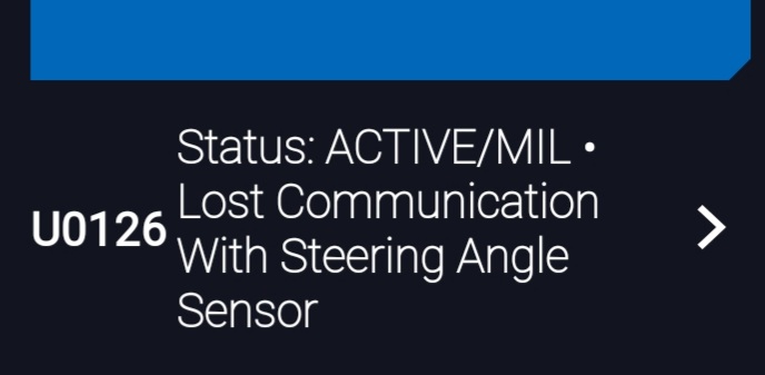

I have replaced all 4 wheel sensors & clock spring. The lights will not go off. Turned steering wheel completely left and right. Lights just won't go off. HELP!
Yes I used an OEM from Ebay because dealer OEM cost $500! Didn't ck codes. Jeep doesn't pull and steering wheel is straight. Scratching my head...Did you use OEM sensors? JK’s are very picky about that. Did you check for any codes? Also does the jeep pull in either direction and is the steering wheel straight, if not that can also cause the lights to come on.
Hey, I got a BlueDriver Jscan. It says everything is good, but it's sayd it's not reading or getting the clock spring. As I mentioned before I just replaced it with an OEM. Any suggestions where to get another besides the deal for $500?Yes I used an OEM from Ebay because dealer OEM cost $500! Didn't ck codes. Jeep doesn't pull and steering wheel is straight. Scratching my head...
Yes, seems to be perfectly straight. Doesn't pull either way while driving.You didn't answer a question in a earlier Post but is your steering wheel centered when going straight?
Yes,yes,and yes.. I'm going to dealer to.get clock spring calibrated.Did you clean the connection for the airbag? Did you unhook your battery to reset everything?
JFYI,
Turning your wheels left and right does not calibrate your clock spring. Had to take to jeep to dealer to get it fixed!
I got my Mopar rear speed sensors from Rock Auto for $40. I don't trust Ebay for sensitive electronic parts.Yes I used an OEM from Ebay because dealer OEM cost $500! Didn't ck codes. Jeep doesn't pull and steering wheel is straight. Scratching my head...
Calibrated it.If the Dealer fixed it what did they do to fix it?
