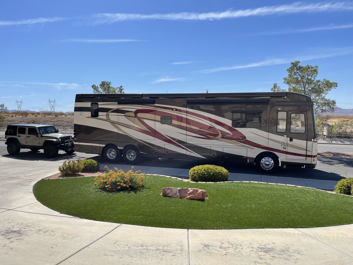

I set my jeep up last year. You basically need:
- a base plate bolted to Jeep to attach tow bar to.
- Tow bar
- braking system for jeep
- break away system
- Braking/turn lights for the jeep
- Safety cables
I found someone on craigslist that had everything except base plate
Blue Ox tow bar
Foot well motion sensing brake system - with Wifi monitor in RV
- This also tells me Jeep battery voltage
Wifi Tow lights - Can be separate light or using Jeeps
- My jeep appears to have wiring for it but was cut
RockJock tow bar plate
I had to add 3 key off electric outlets to power every thing.
It took a couple days to get it up and running

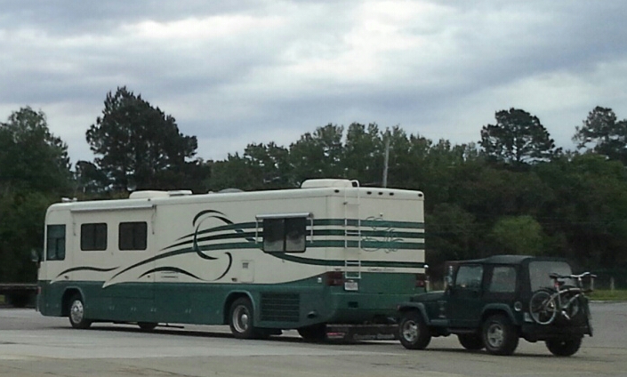

I towed TJ for 5 years. What will you be towing your Jeep with. If its something with air brakes then I suggest the air force one auxiliary braking system. It will come with a breakaway system as well. Otherwise I recommend the Stay - In - Play Duo breaking system
My TJ
