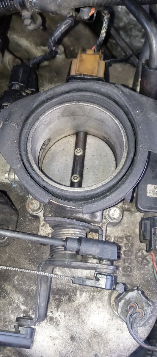

Yes it's cables but it does it when there not connected and the butterfly does not open when I crank it. It just goes wide openIs the throttle opening when it does it? It looks as though the Throttle body is a cable operated and not drive by wire, is that correct?
It must be electrical then and somethings telling the ECM to give the injectors fuel. Do you have any wires pinched anywhere?Yes it's cables but it does it when there not connected and the butterfly does not open when I crank it. It just goes wide open

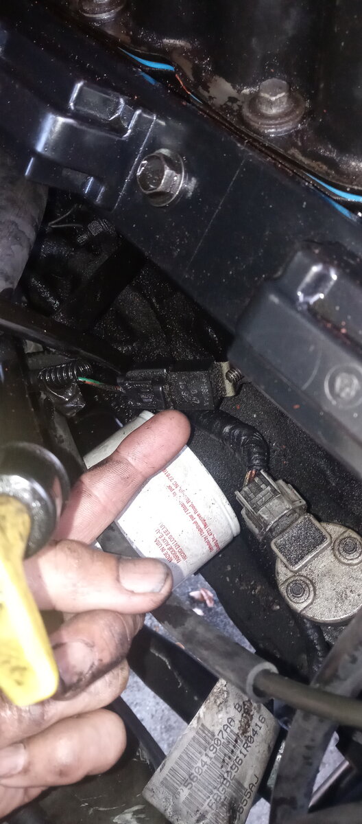

No pinch that I can find yet but I do have a wire with an eyelet that's in the cluster of wires whit the cam sensor. Does it connect to the side of the head?It must be electrical then and somethings telling the ECM to give the injectors fuel. Do you have any wires pinched anywhere?

I changed the air control module in the throttle body. Now I can't get it to idol and back firing thru the throttle body.I tried disconnecting battery overnight
