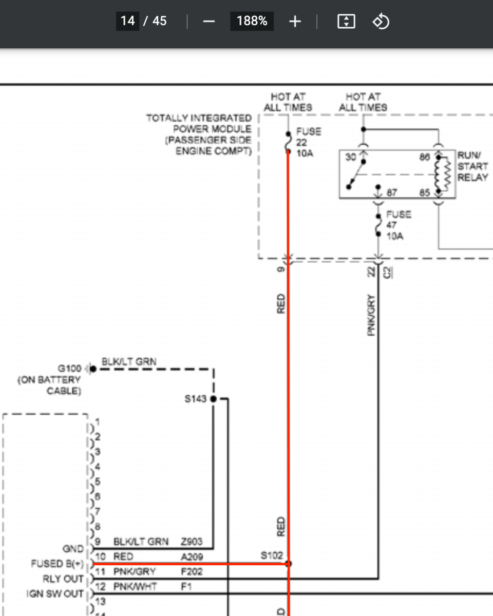

My girlfriend was driving my jeep along the freeway when she started to experience a death wobble so she pulled over to the side of the freeway to stop the vehicle but when she went to restart the jeep, the jeep wouldn't start. We had the jeep towed home and when I looked at what the problem was, I found that the Fuse M33 (NGC-GPEC) had blown. I replaced the fuse and the jeep turned over a couple of times and when it finally started, the fuse blew again. I replaced the fuse a second time, the exact same thing happened.
My theory is when my girlfriend experienced the death wobble, a wire has moved and the insulation has melted and caused a short but unfortunately, I need some help understanding what wires are connected to fuse M33 (Next Generation Controller and Global Powertrain Engine Controller.).
Can someone please assist me in providing an electrical diagram that shows the wiring for fuse M33?
