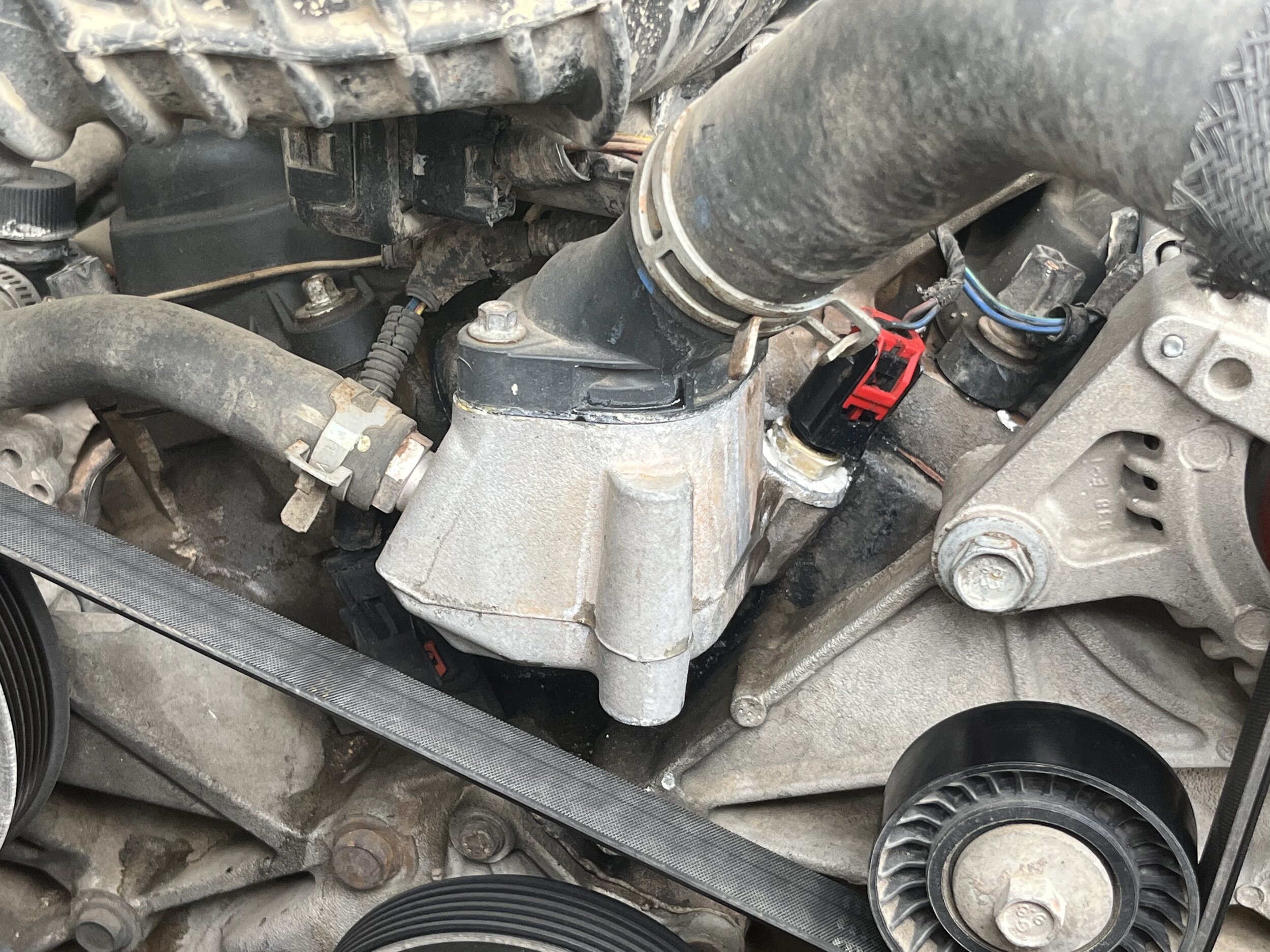

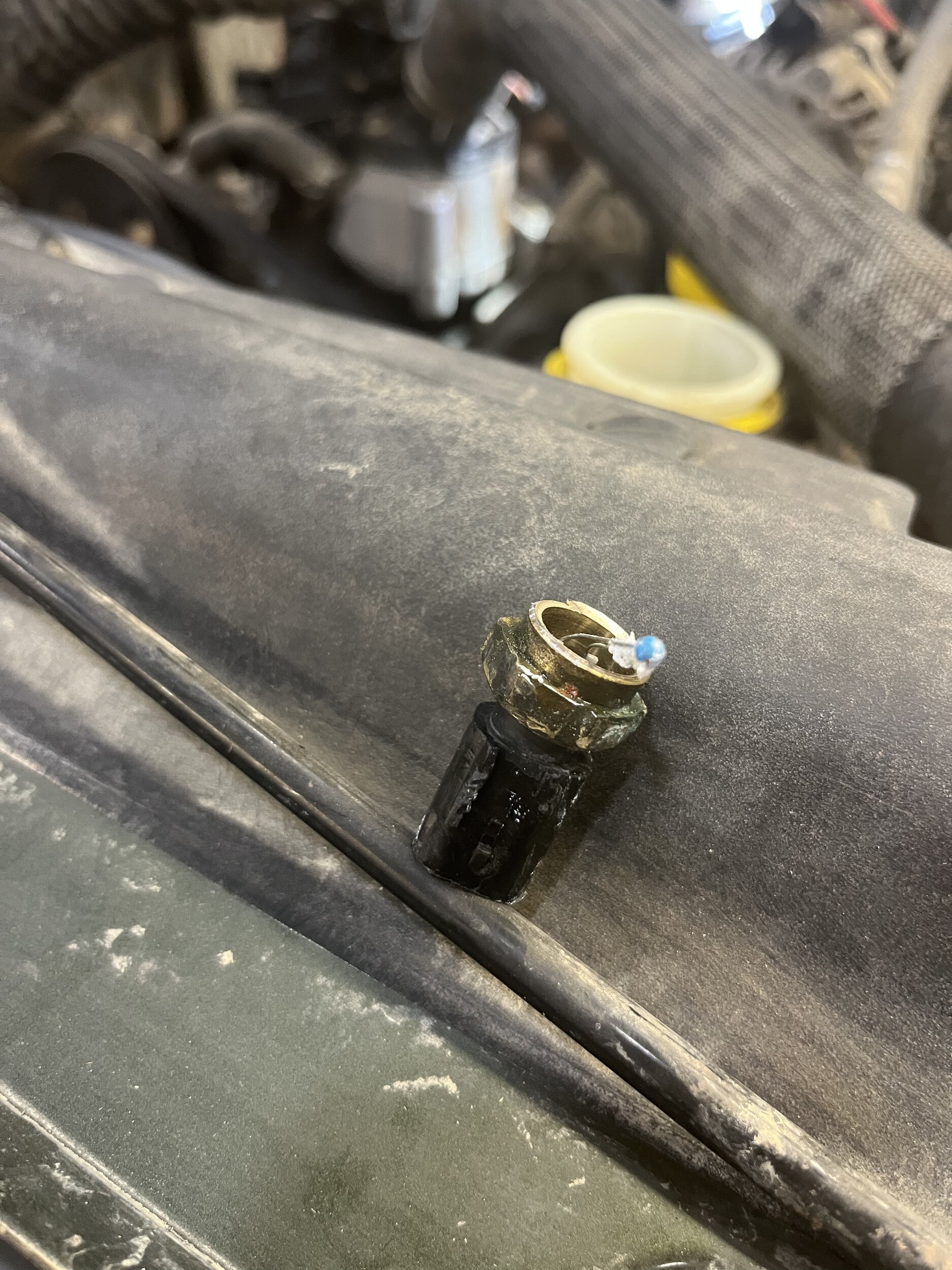

So….the ECT just broke off on my son’s 2008 Jeep Jk!
I’m stepping away, as I’m about to lose my cool here. A simple sensor job just turned into a couple days of work most likely.
Anyone see this??

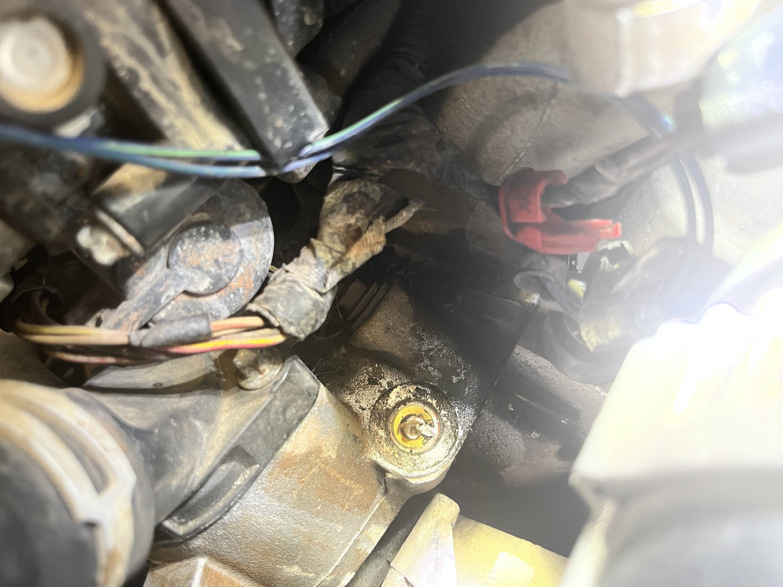

I walked (and cussed), my process to clear the head and think on these without making it worse.
I came to the same, gonna soak penetrant on it , clean the area to make sure it can get down there, and clean out the wiring, measure for an easy out, and go get one.

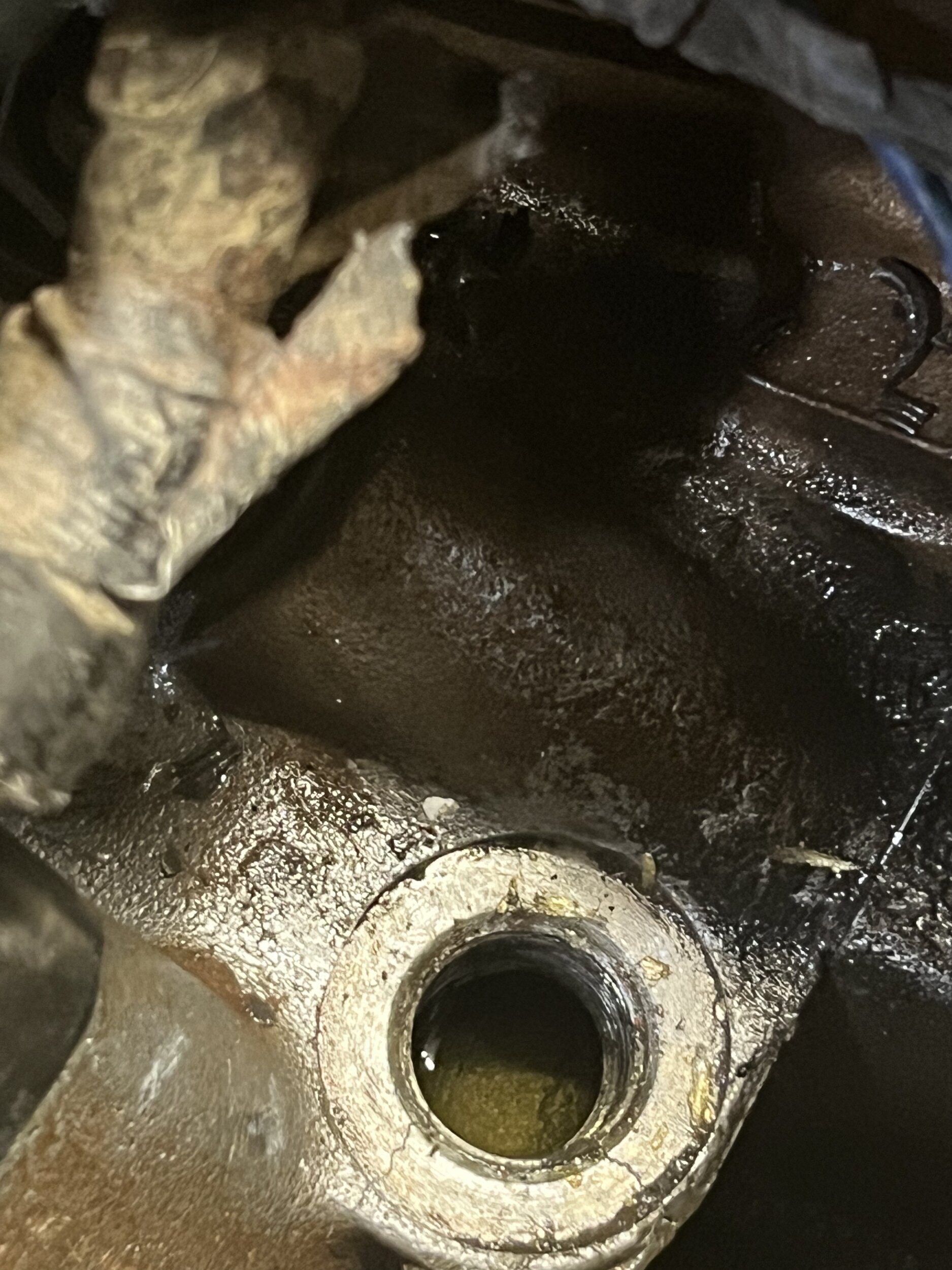

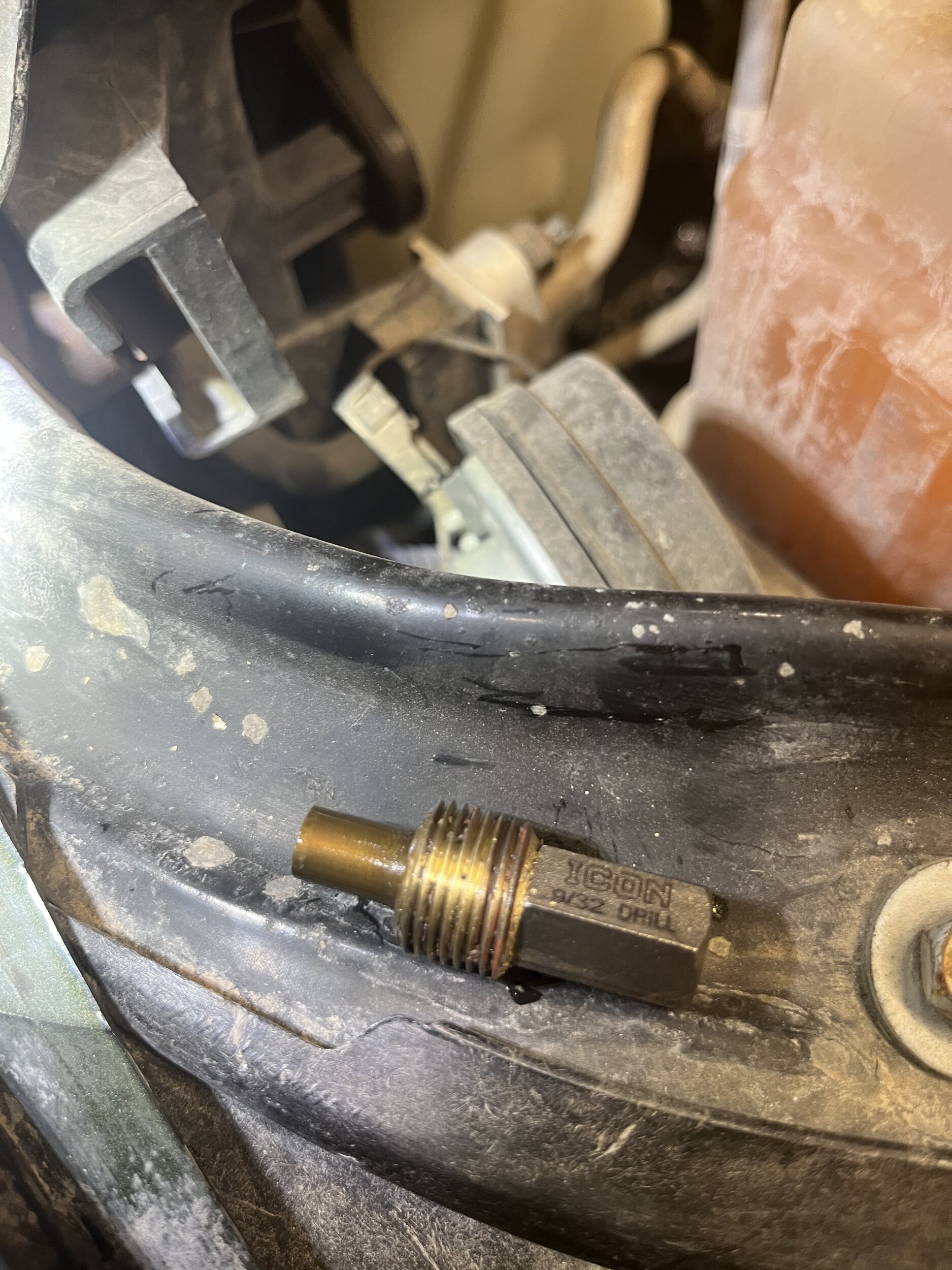

Got it out, dam.
Had to use the easy out and get it all the way bottomed out. Didn’t end up needing to drill
It looks like it, dammit. That mean what??? Need to replace that whole manifold?

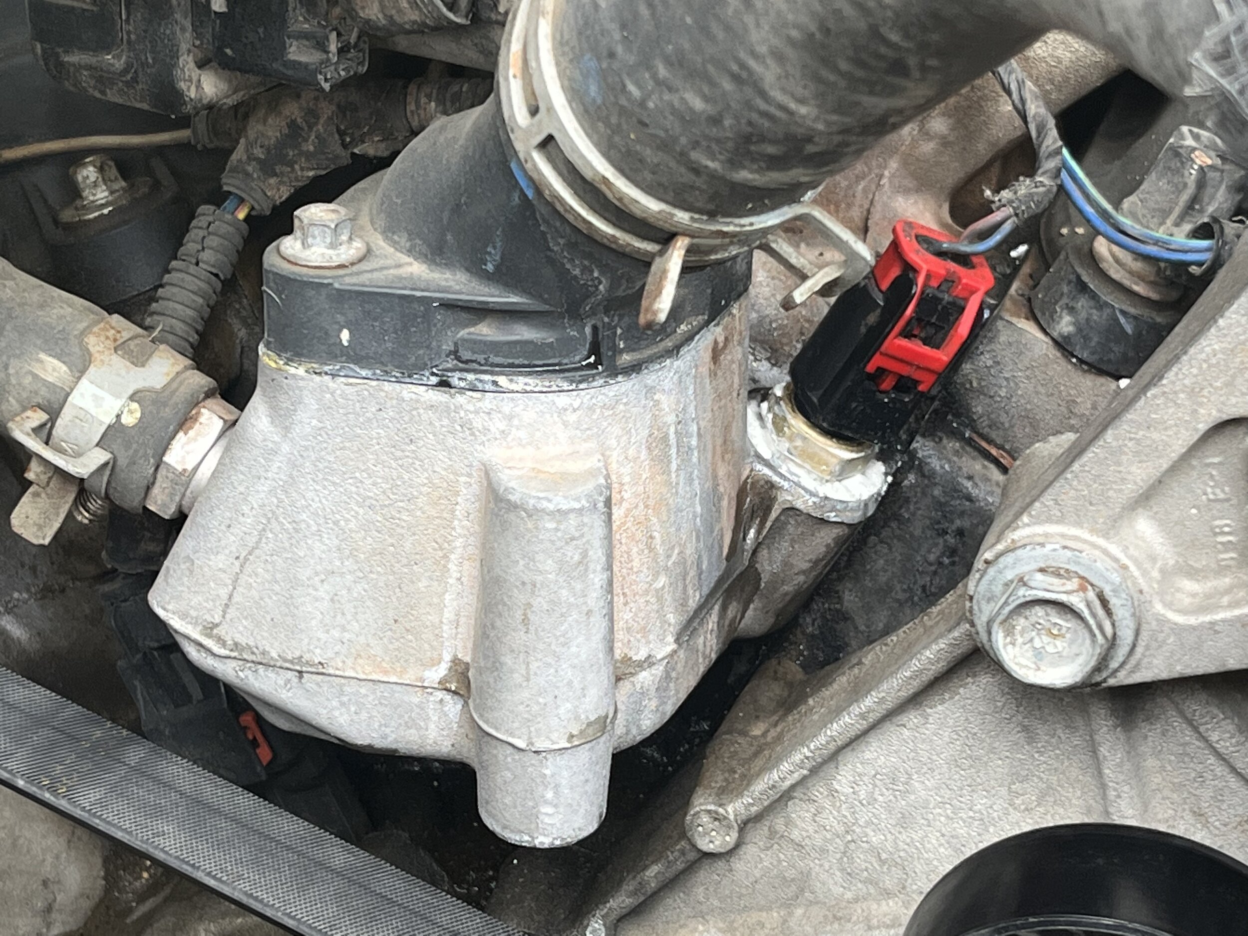

There’s a bigger problem. This has been an overheating problem for a while. I think getting this ECT exposed it worse
The cracks are leaking there. F. Do you know what part that is? Major tear down here?
