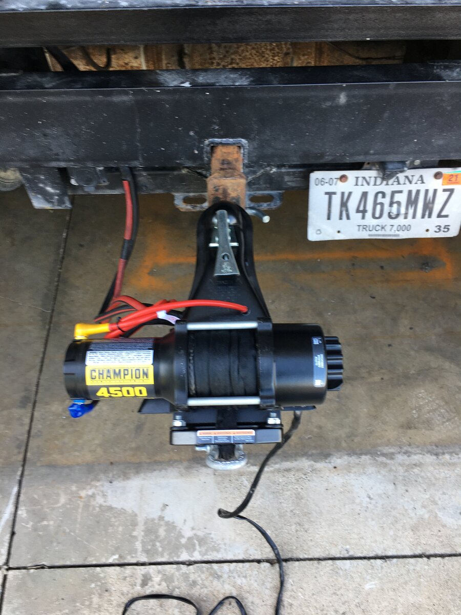

In case someone ever wants a winch but don't like one weighting the front bumper down all the time I made this winch to use for my wood cutting. I used a (A) shaped trailer coupler and mounted a 4,500 lb winch to it, just put on the trailer hitch ball and plug it into my Power Cord that I have on 2 of my trucks.
