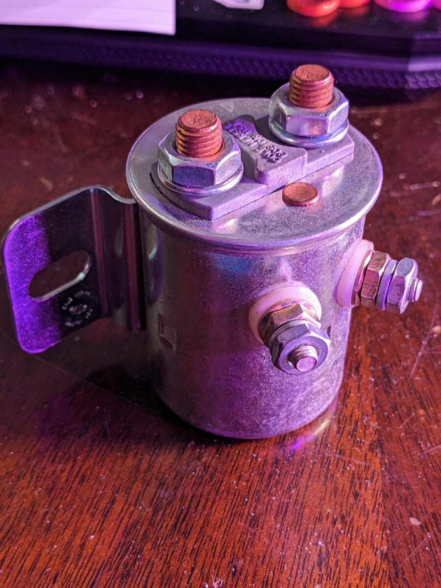

Would this solenoid be able to handle being the bridge between two batteries in a simple DIY dual battery system? I found it in a pile of junk at work, it looks new. I found it online and it's 35 amps continuous service.

No. You need more like 300 amps continuous, and it should handle 10 minute spikes of around 2500 amps. That's why dual battery systems don't cost $10.
As for voltage, that is exactly where serial and parallel wiring comes into play.
Assume you have two batteries rated at 12V/10Amps.
To connect them in series, you wire the positive terminal of one to the negative terminal of the other. This will deliver 24V/10Amps.
To connect them in parallel, you wire positive to positive and negative to negative. This will deliver 12V/20Amps.
If you wire a dual battery system in your Jeep in series, you will get to do a LOT of other wiring...

Well that makes sense. This thing must have come from a lawn tractor or something lol.
