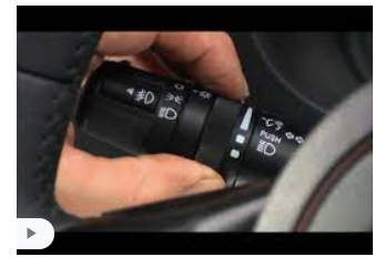

If you turn this dial towards you as far as it will go, your dome should come on regardless of the doors being open or not.

Does the dome light come on if you turn the interior panel light dimmer (on the turn signal lever) as I showed in the photo earlier?

Yes I have to reach up to turn the dome light on and only works when the car is on. The dimmer only works for the turn signal and the outside lights that’s all. I don’t get the audible alarm, I don’t get any kind of warning. It used to work just don’t sure when it stopped.
