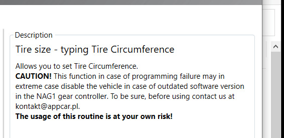

When selecting the Tire Size, the description states:
CAUTION! This function in case of programming failure may in
extreme case disable the vehicle in case of outdated software
version in the NAG1 gear controller. To be sure, before using contact us
at kontackt@appcar.pl
The usage of this routine is at your own risk!
Here is a screenshot:
The vehicle is a 2012 Jeep Wrangler with the NAG1/W5A580 automatic transmission. How do I check if the NAG1 gear controller software is outdated?

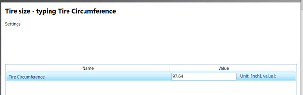

Secondly, when I continued past this screen to see what the next prompt would be, this is the screenshot I took:
This screen states the units are in inches, however, the value is 97.84. Clearly, this is incorrect. Is it actually in millimeters?

Edit: Ignore the 2nd question. I missed the "circumference" part. Duh.

Was gonna say, the circumference sounds about right.
C= pi x d (3.14 x diameter)
