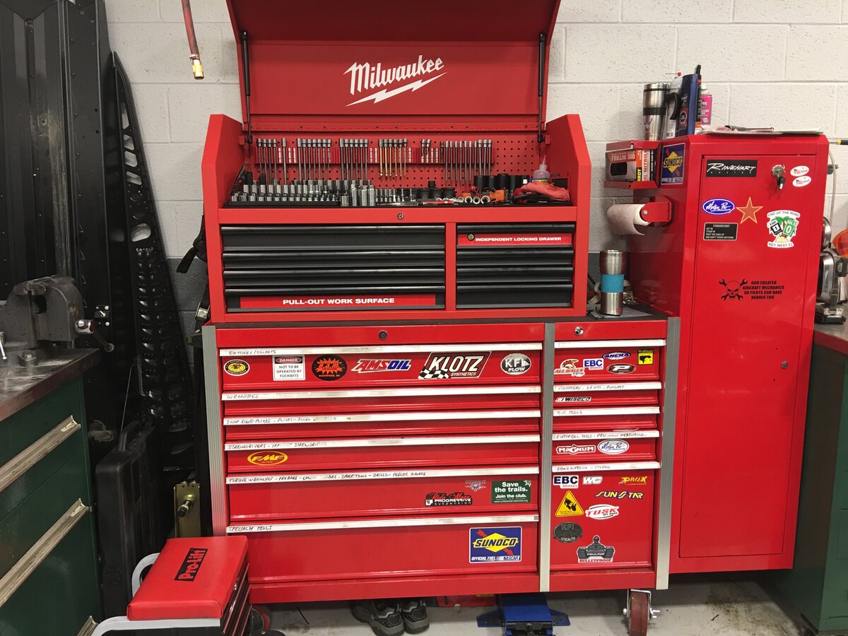

10-4 just make sure u have a high limit Visa card and a good set of tools 🍺🍺
/whistles innocently
I do ok. ;)

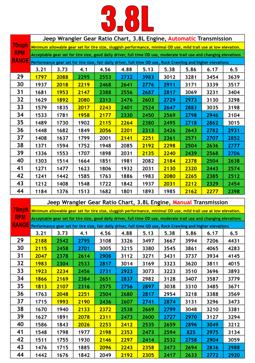

Your transmission is spinning faster. Which means more friction. Which means more heat. Which means more wear. It's not a huge difference, but it IS wearing things faster.
This should help.

If I re- gear, will this keep the transmission from spinning so much faster and wearing
