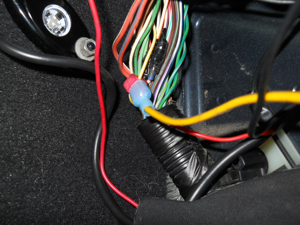

This is where I hooked for my footwell lights that come on when I open the door on my 2008. Yellow with a white stripe.

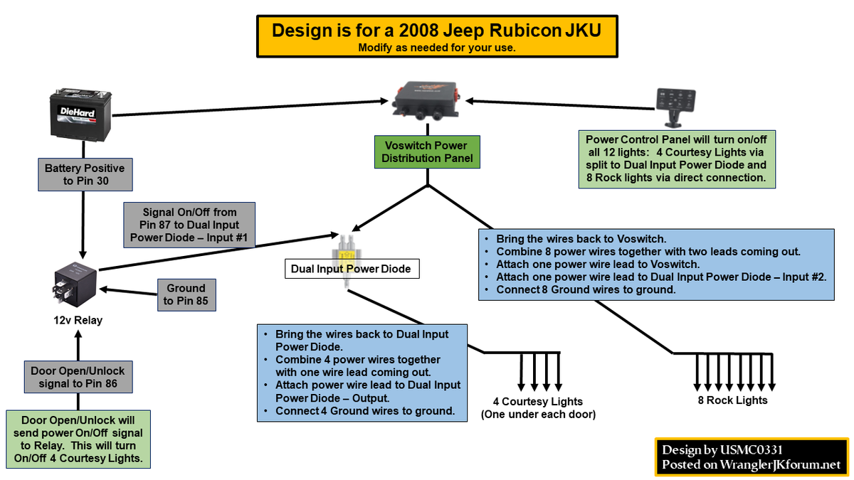

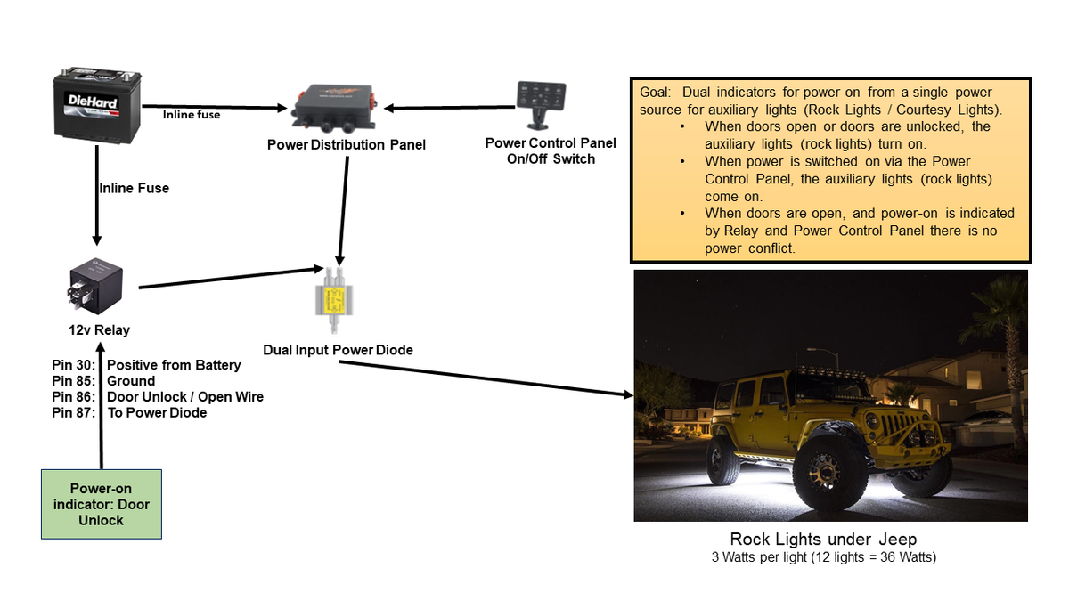

I'm going to be using a Voswitch also. So the lights will act as courtesy lights when the doors are unlocked/opened, but I'll also be able to switch them on via the Voswitch. I've attached the design I've drafted. Thanks.

Based on the feedback I received, I modified the design to allow the four Courtesy Lights to operate independently or in conjunction with the eight Rock Lights. This way the four Courtesy Lights operate automatically and they will also turn on manually with the other eight Rock Lights. Hopefully, the design is useful to others. Semper Fi.
