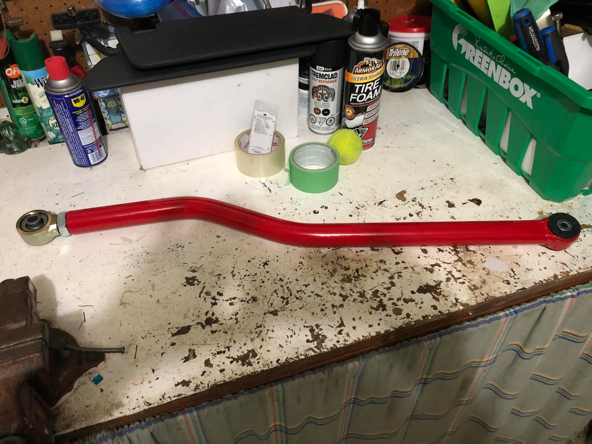

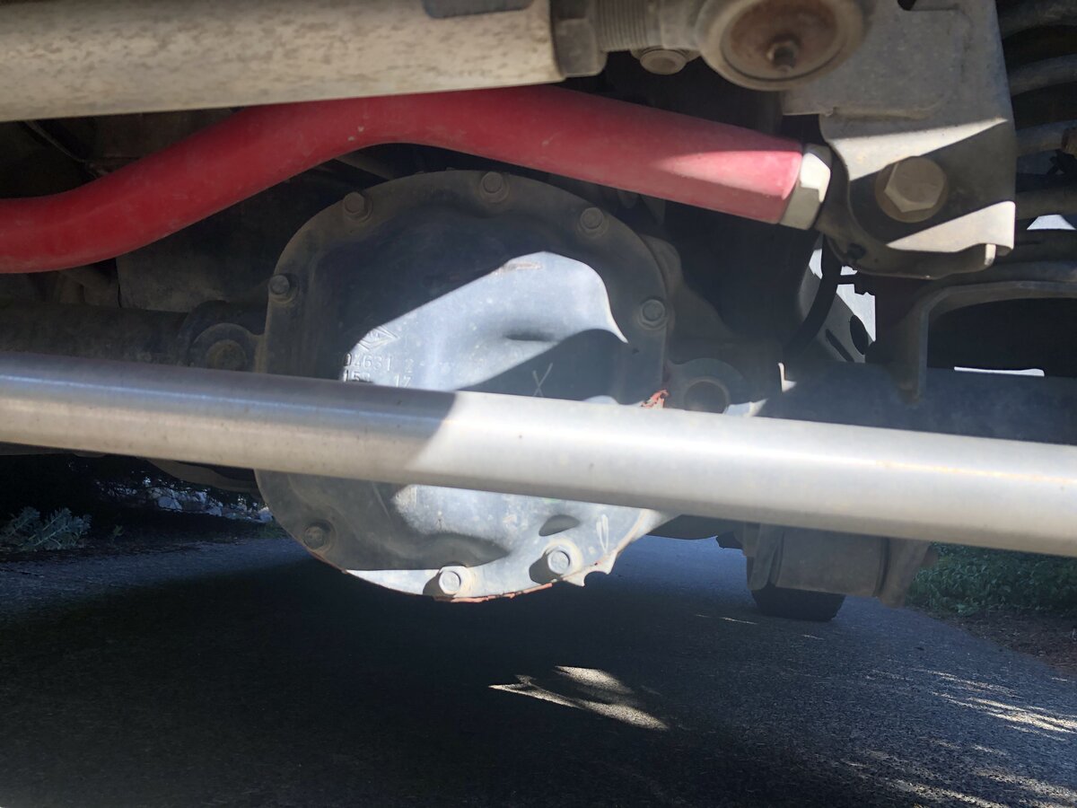

Discovered that Core 4x4 track bar does have a minimum lift . They advertise will work 0-6”.
I’m at about 1-2” ish lift with Rubicon suspension .
The track bar taps stock diff cover😡😡 when flexing it out .
So been looking at Steer Smarts Yeti or Teraflex Monster TB.
The upper two brands do bend the bar up more on frame side to help clear the diff cover . It looks like the Yeti is angled forward a little more as well .
With solid bars manufacturer can bend a solid bar more than compared to a tubed style bar . As a tube will crimp and loose strength if bent to much on a small radius
So me thinks will order the Yeti . Thoughts or input would be appreciated if your running a Yeti or Teraflex .
Thanks
If you zoom up on pic can see the red paint on cover .

Maybe just put a flat spot on the track bar where it's rubbing.
I don’t think this would help to much unfortunately . It’s rubbing diff cover about half way down . To completely clear vertical travel it needs about 1/2” ish to be taken off of bar . The bar has 5/16 wall thickness .
I also considered increasing bump stop but then that would limit up travel significantly . It kinda blows TBH as the Core TB is made very well. Greasable on both ends ,Poly bushing on axle side , Forged Johnnie Joint on frame side . Just not enough clearance for current set up.
Will hang onto it and may use when I do 2 1/2” lift . Will see how the Yeti works out .
My biggest concern right now is when it hits diff cover and limits travel . Puts a huge amount of stress on frame side track bar bracket when hung up and breaking it off .
That would be bad when out in the middle of nowhere .

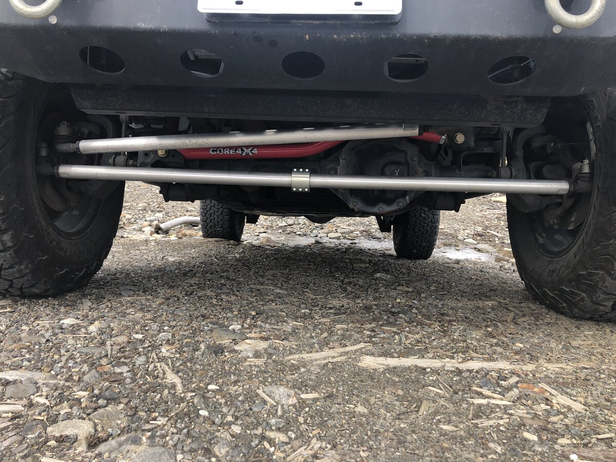

The following is a pic of my current set up . The Drag Link & TB are more / less parallel .
Reactions: FJQue and mrjp

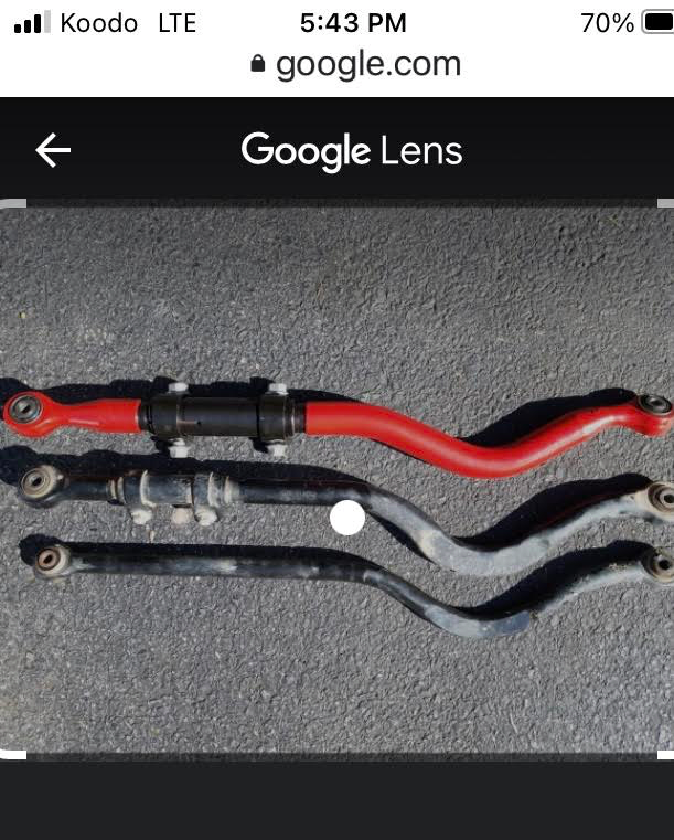

To give you guys an idea . First pic is of CORE.
Second pic is of stock@ bottom
Teraflex @ middle
Steer Smarts @ top.
See how all three bend quite a bit close to frame mount .
Where the CORE hardly bends at all at frame mount .
That's the problem of the CORE. I don't even know if it provide
enough clearance on a 2 1/2" lift .
The Steer Smart and TF also Angle the TB forward
a bit to help with clearance .
When I originally mounted jacked up both sides
of front axle independently to check clearance . Maxed out
jack and all seemed good. Apparently needed to jack higher
to get full picture of what's going on .
