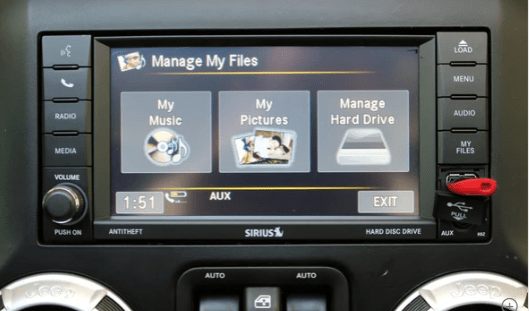

Shot in the dark here - Does anyone know if the stock touchscreen (below) that comes on a 2015 JKU Willy's has output for an aftermarket sub? (Rockford Fosgate PS-8)
But, does have the Alpine package (flat front window speakers)

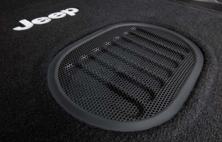

I thought 2015 JKU Alpine system comes Subwoofer below.
if you have Alpine system, you can make direct wiring between amp.(552W) and your sub but I do not recommend it. Another option is here. You can replace the stock amplifier to aftermarket amplifier to use maestro system.
