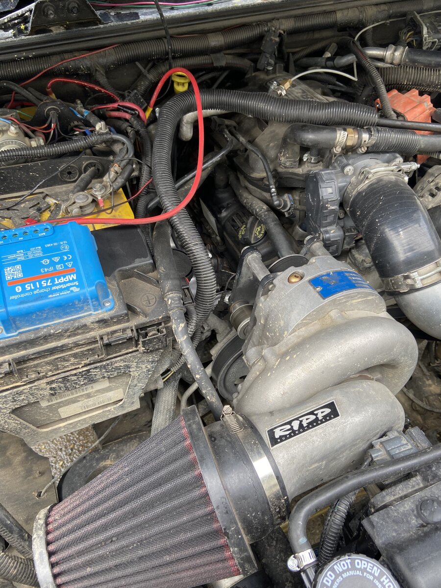

I have exhaust gas in my radiator according to an exhaust leak tester. Engine doesn’t overheat. The reservoir seemed to be higher than normal tho. Warmed up the engine and did a compression test. I was expecting the head gaskets to be damaged and a bigger difference in the numbers. Any ideas what is going on? Could it be a tiny leak in the head gasket where it shows 178?
2011 Rubicon 3.8L
Drivers side
180
180
180-
Passengers side
180
179
178
