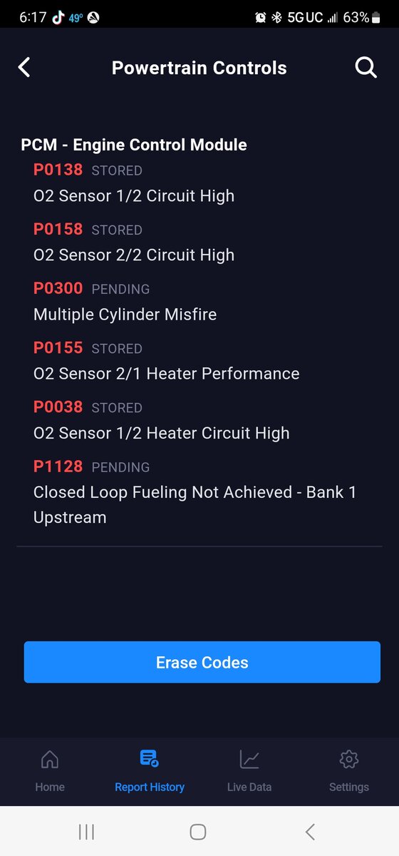

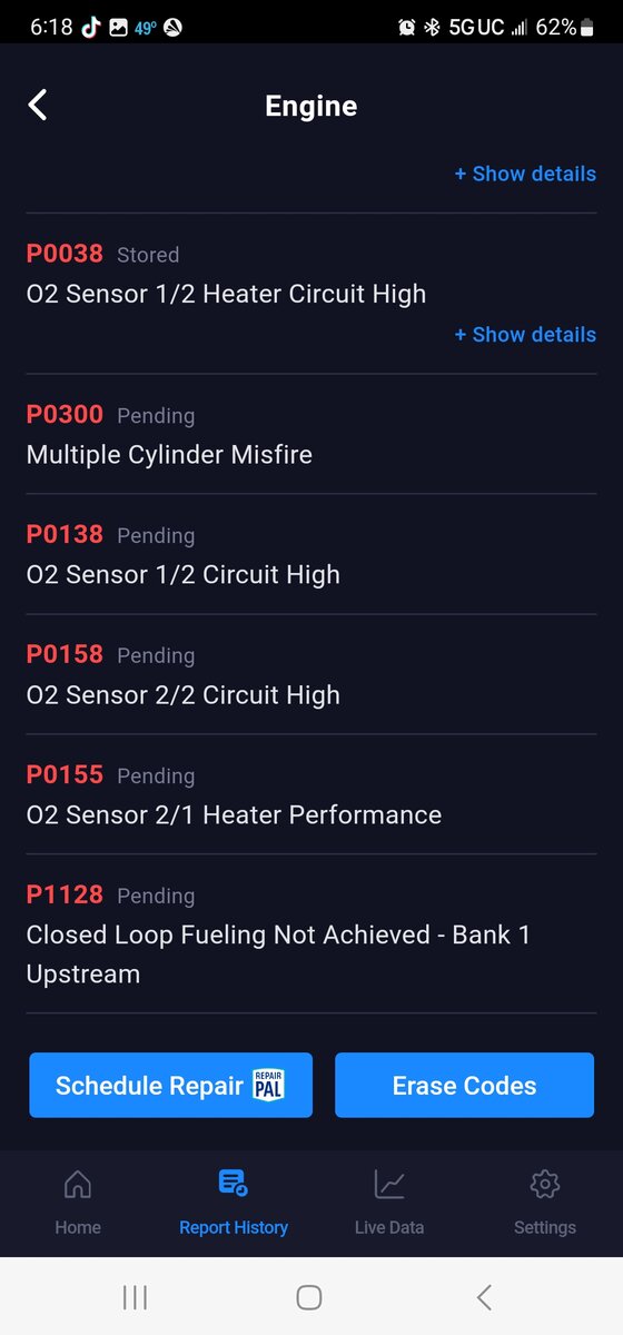

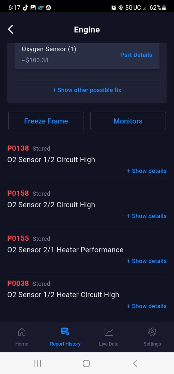

I've been struggling with some o2 sensor codes and nothing has been working. I replaced all the sensors, didn't fix it.
Did the ground repair as was suggested, didn't fix it.
Replaced the ecu and didn't fix it.
Before I had this issue I had a code that said the cat was bad. I bought one on ebay for under $300.
I'm beginning to wonder if the cat I got on ebay was a rip off or just not the right one. Could the cat be at the heart of these issues?
If the cat you bought wasn't a factory cat then it will throw a code, I have high flow cats on my JK and I have to use O2 Foolers to be able to not get a code.
Did you use NGK O2 Sensors? A
Also if it's from the non-factory cat it will be a downstream code.
Did you try doing a ECM reset?
I did reset the ecm and nothing changed. Definitely not a factory cat. I Honestly don't remember the o2 sensor brand.
Update
I gave up trying to figure it out. I took it to a shop. They replaced the o2 sensors I had with oem sensors and that fixed it. No more codes and no more cylinder misfire. Now all I have to figure out is the traction and esp lights
