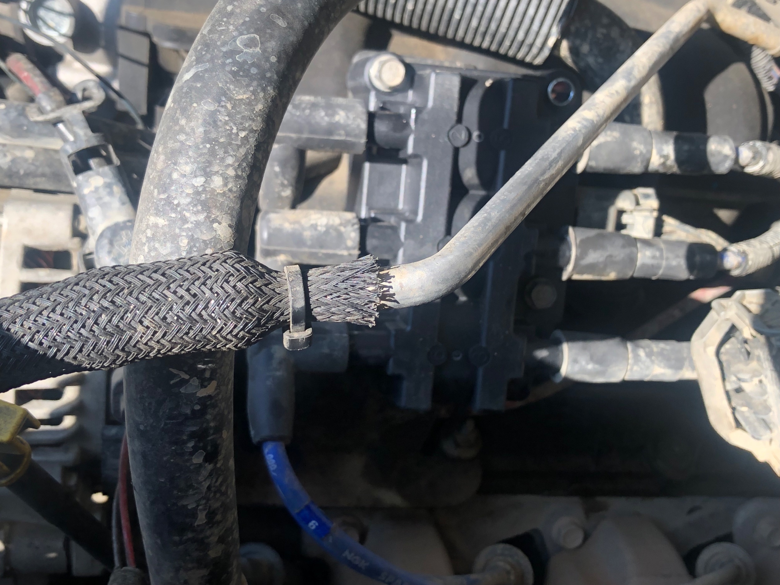

Was out in the middle of nowhere on Sun . Turned Jeep off for about 5 mins . On restart it all of sudden idle felt kinda rough . Mmmmm
Check engine light came on in a few mins .
When I got home plugged in JSCAN. P0302 Cylinder 2 misfire .
Tried a new plug Monday . No change .
Installed new coil pack today.. No check engine light , Checked for codes twice after install and test drive .it seems to have solved the problem .
Seems to be idling a little rough still. Could just be me .
Will drive it more tomorrow to see if code returns .
