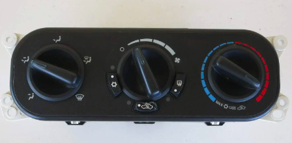

Post a pic of your climate control panel. I'll be able to help you once I see which one you have.

The bulbs are soldered in. If you have a soldering iron you can replace them. You have to get 2 skinny flat screwdrivers to pop the knobs off. Then turn the housing over and you'll see 4 clips. Carefully pop them off the white plastic. Once the black cover is off, you'll see the 4 bulbs. I think there are 2 different sizes if I remember correctly.

Thank you for your reply. Actually, I was afraid of pulling the knobs because I though I can damage the plastic. I though maybe you have to put them in an specific position before pull them out. I will try and I will share the results.
