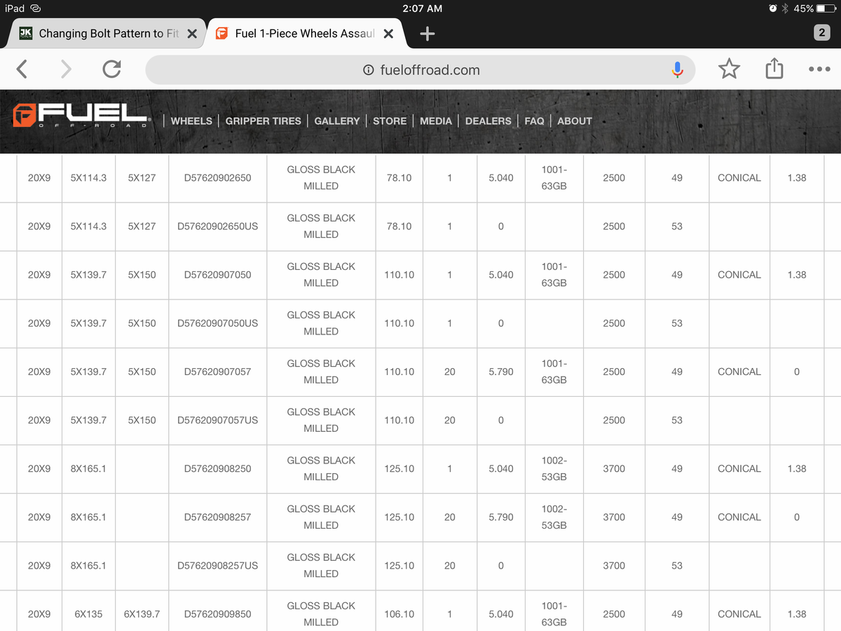

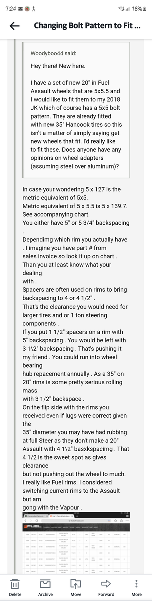

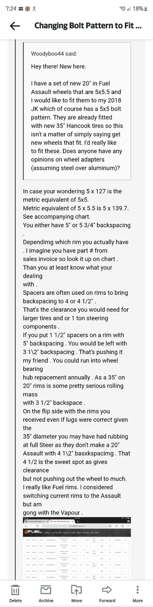

In case your wondering 5 x 127 is the metric equivalent of 5x5.
Metric equivalent of 5 x 5.5 is 5 x 139.7. See accompanying chart.
You either have 5" or 5 3/4" backspacing .Dependimg which rim you actually have . I imagine you have part # from
sales invoice so look it up on chart . Than you at least know what your dealing
with .
Spacers are often used on rims to bring backspacing to 4 or 4 1/2" .
That's the clearance you would need for larger tires and or 1 ton steering
components .
If you put 1 1/2" spacers on a rim with 5" backspacing . You would be left with
3 1\2" backspacing . That's pushing it my friend . You could run into wheel bearing
hub repacement annually . As a 35" on 20" rims is some pretty serious rolling mass
with 3 1/2" backspace .
On the flip side with the rims you received even If lugs were correct given the
35" diameter you may have had rubbing at full Steer as they don't make a 20"
Assault with 4 1\2" basxkspacimg . That 4 1/2 is the sweet spot as gives clearance but not pushing out the wheel to much.
I really like Fuel rims. I considered switching current rims to the Assault but am
gong with the Vapour .
Ok you have the 7050.
So 5” of backspacing .

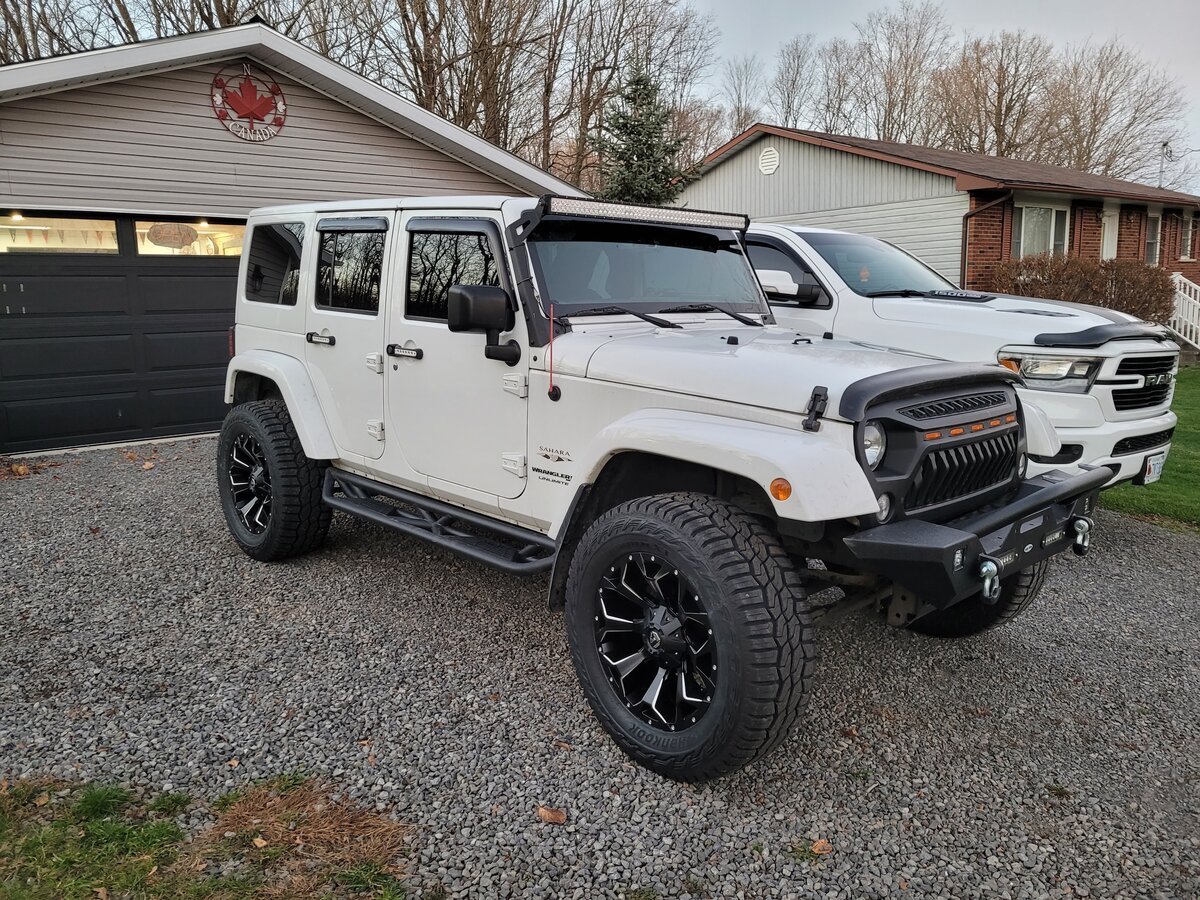

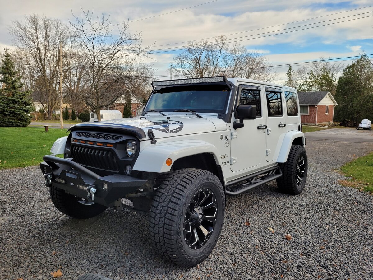

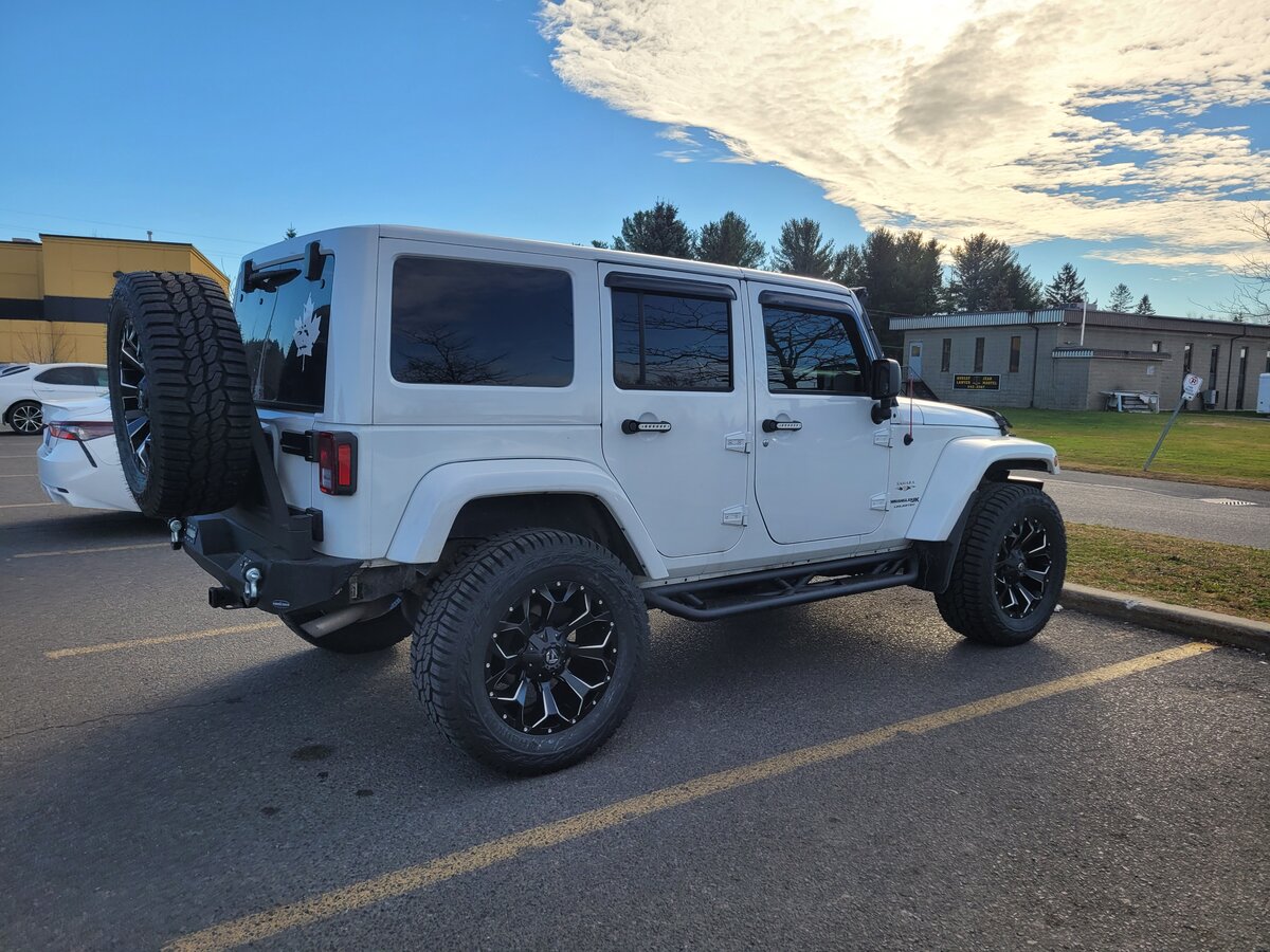

Well I added adapters on the suggestion of a Jeep parts store. I've lost a little control as expected but it looks awesome in my opinion. I love it! I once read someone say putting 20s on a Jeep is like wearing stilletos to the gym. I never laughed so hard. Well this girl prefers this boot to the shoe. Time will only tell if I have any issues but I will have them checked at each tire rotation.
