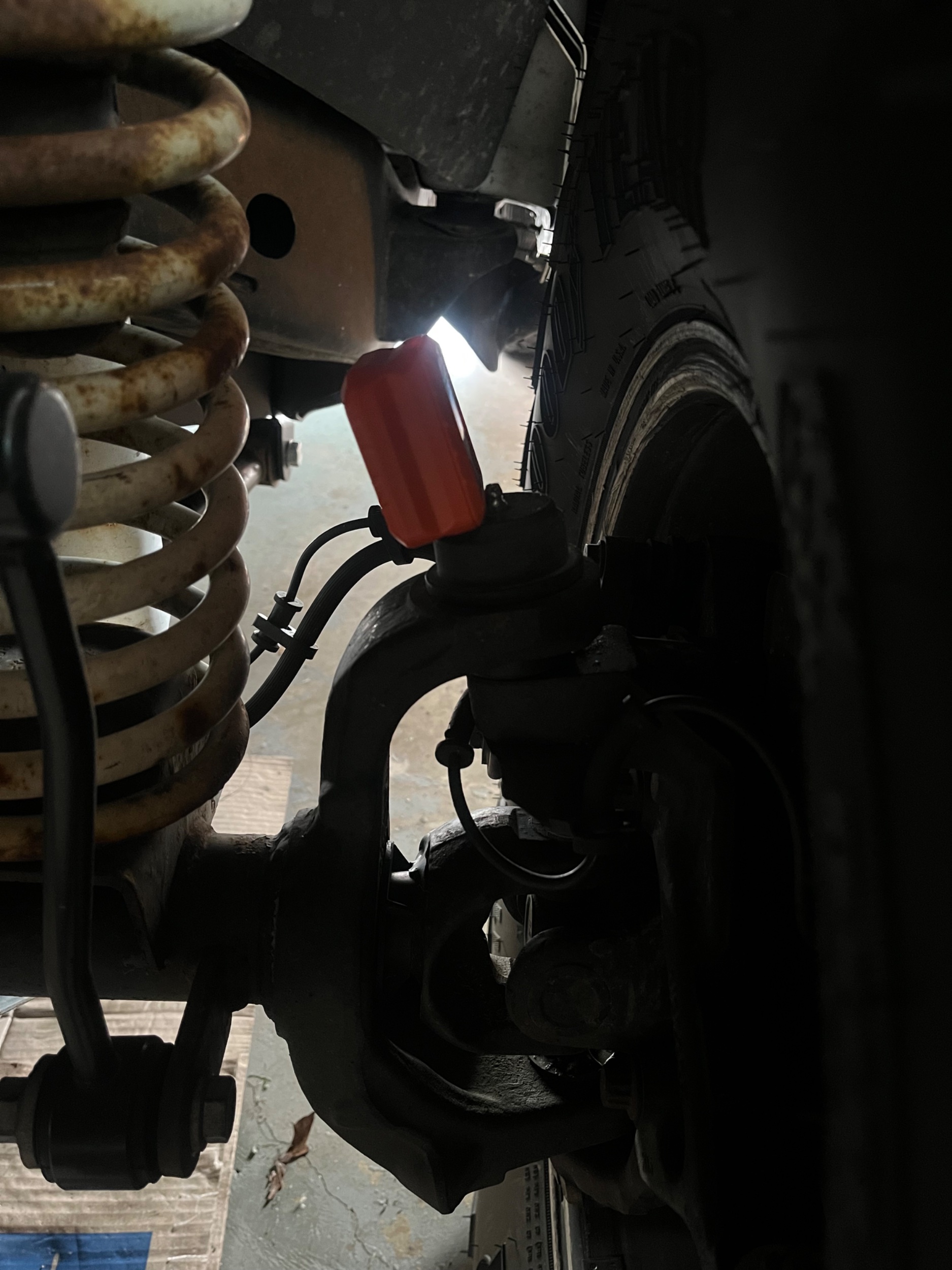

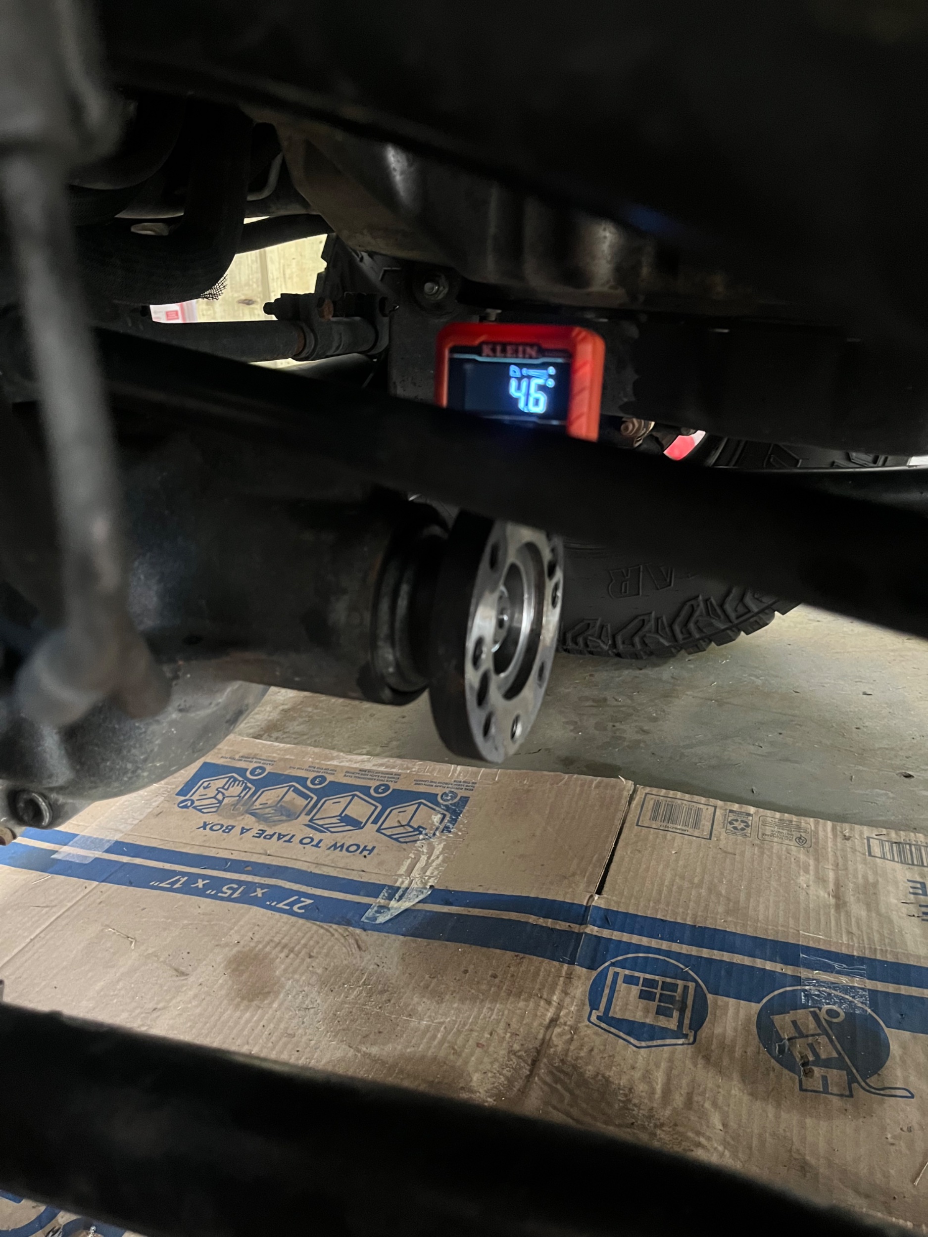

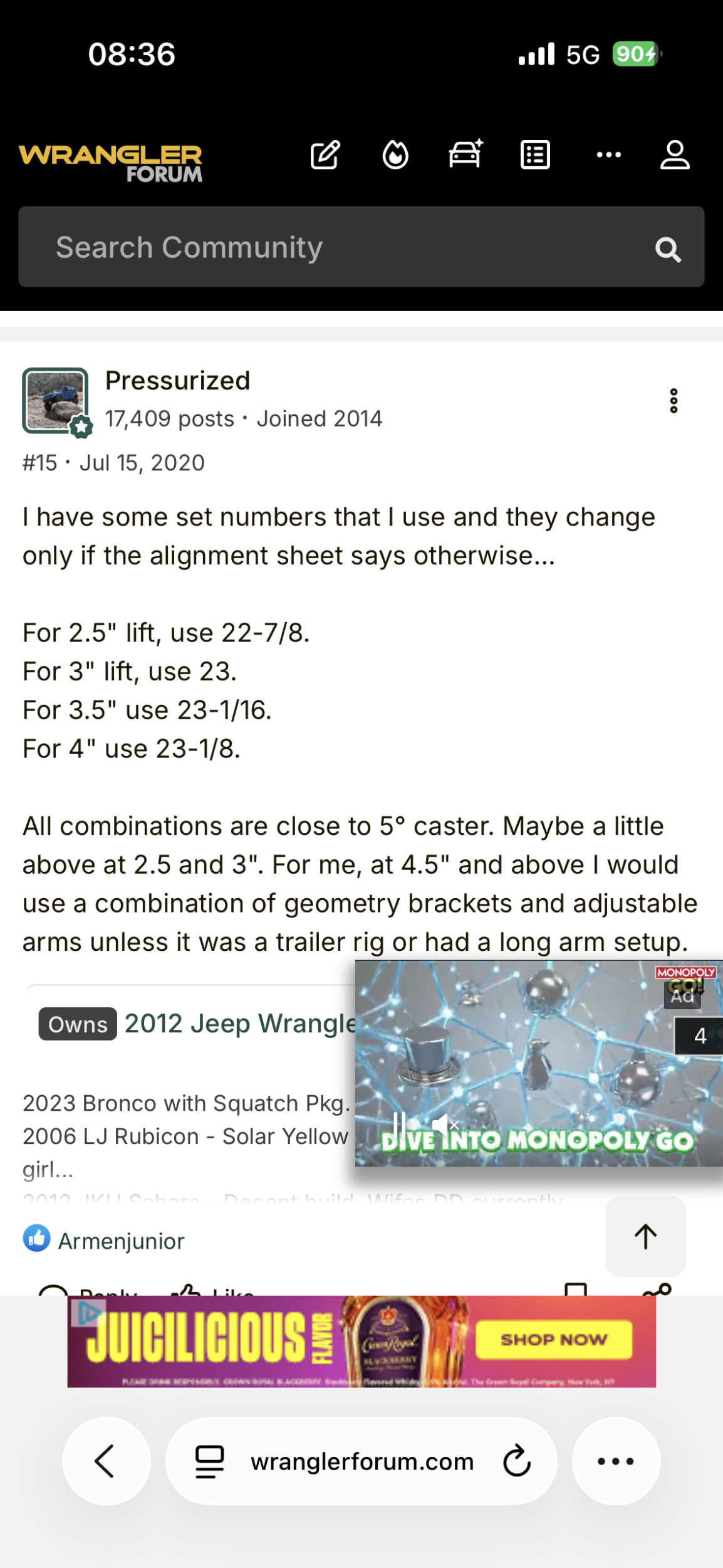

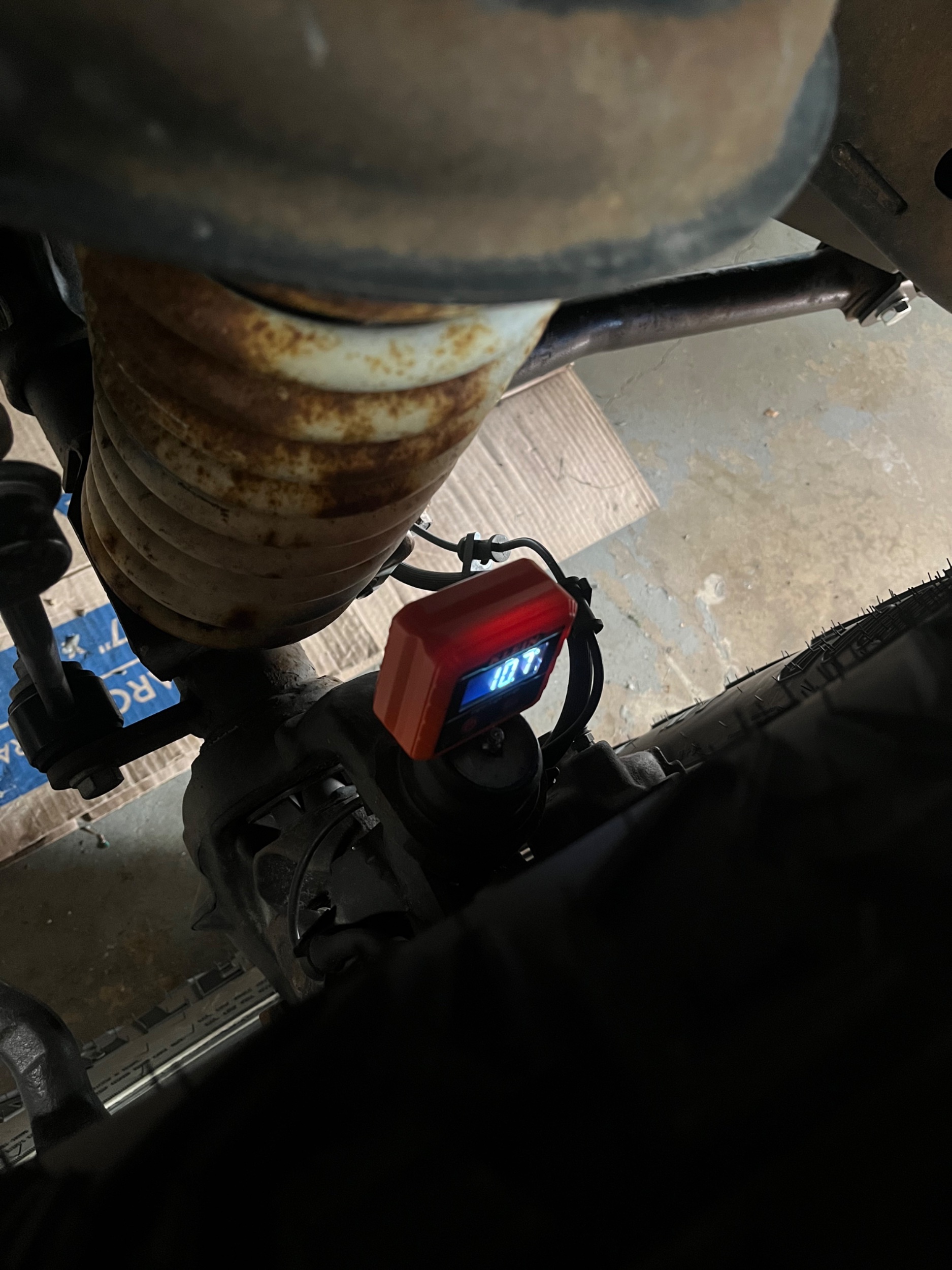

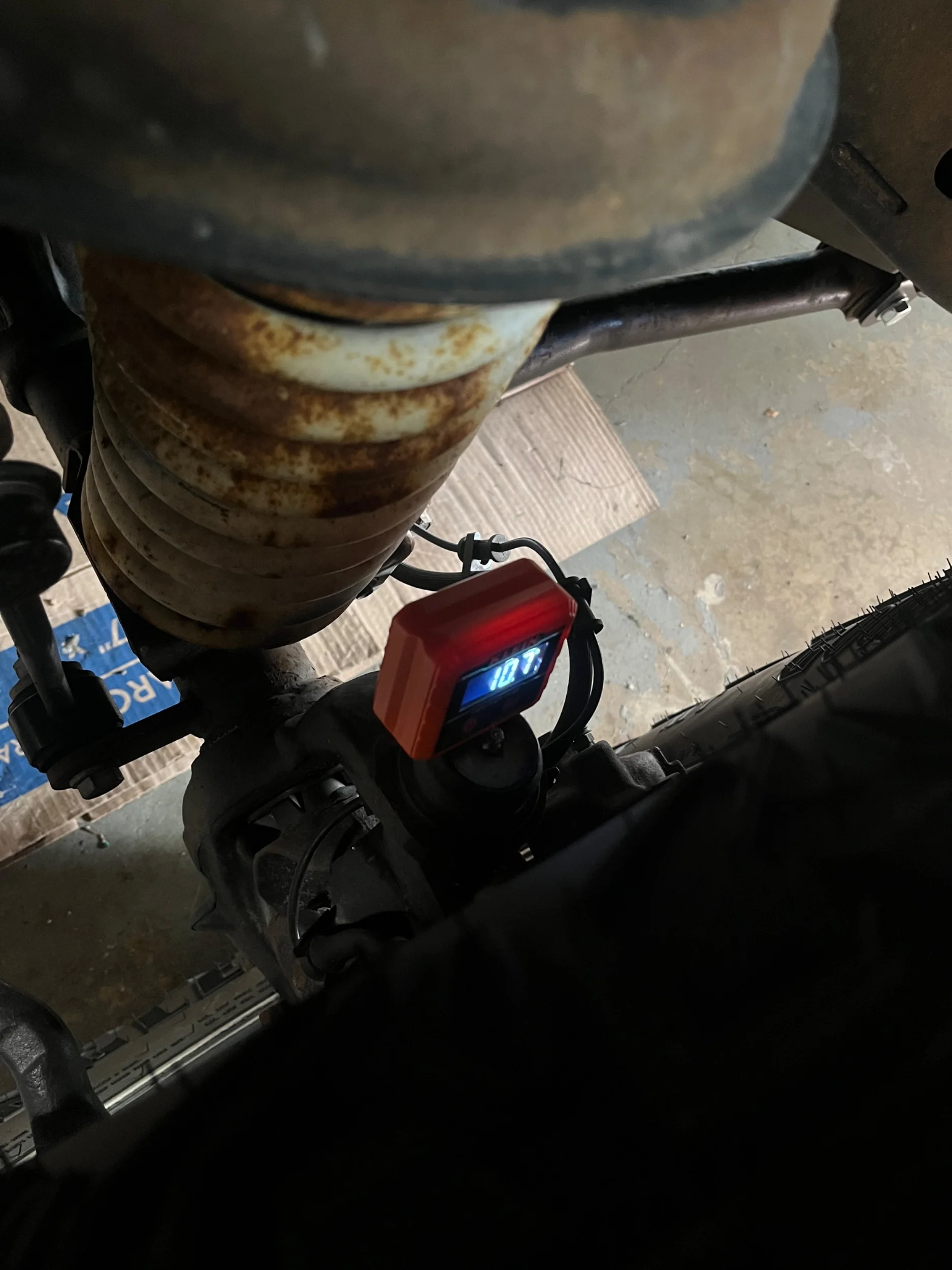

Hi all,
I’ll preface this by saying I’m not the most mechanically inclined and learning as I go. I recently installed the Rancho geometry brackets on my 2014 Jeep JK that has a 4 inch lift. I was having issues with the Jeep being flighty and steering not returning to center and this seemed to be the best option for my budget. Once I installed the brackets I was getting a harsh driveline vibration so I removed the front driveshaft and that seemed to be the culprit (both driveshafts and all control arms are stock, I plan to upgrade once it’s in the budget). I was still getting a slight flighty feeling but the steering does return the center a lot better now, so I’m trying to figure out my caster. I’ve provided the measurements below but I’m still unsure what to make of them or if I’m even measuring from the right spots. Any tips or suggestions would be much appreciated, even constructive criticism. Thanks!
