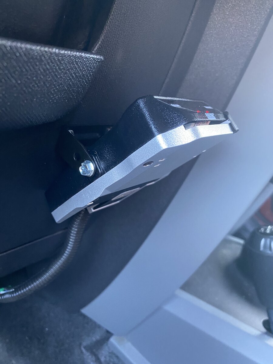

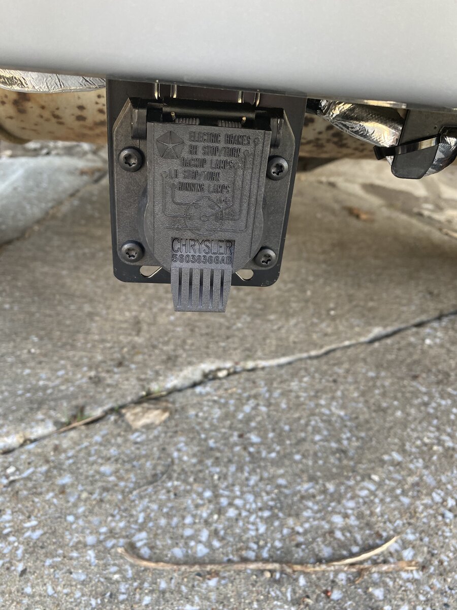

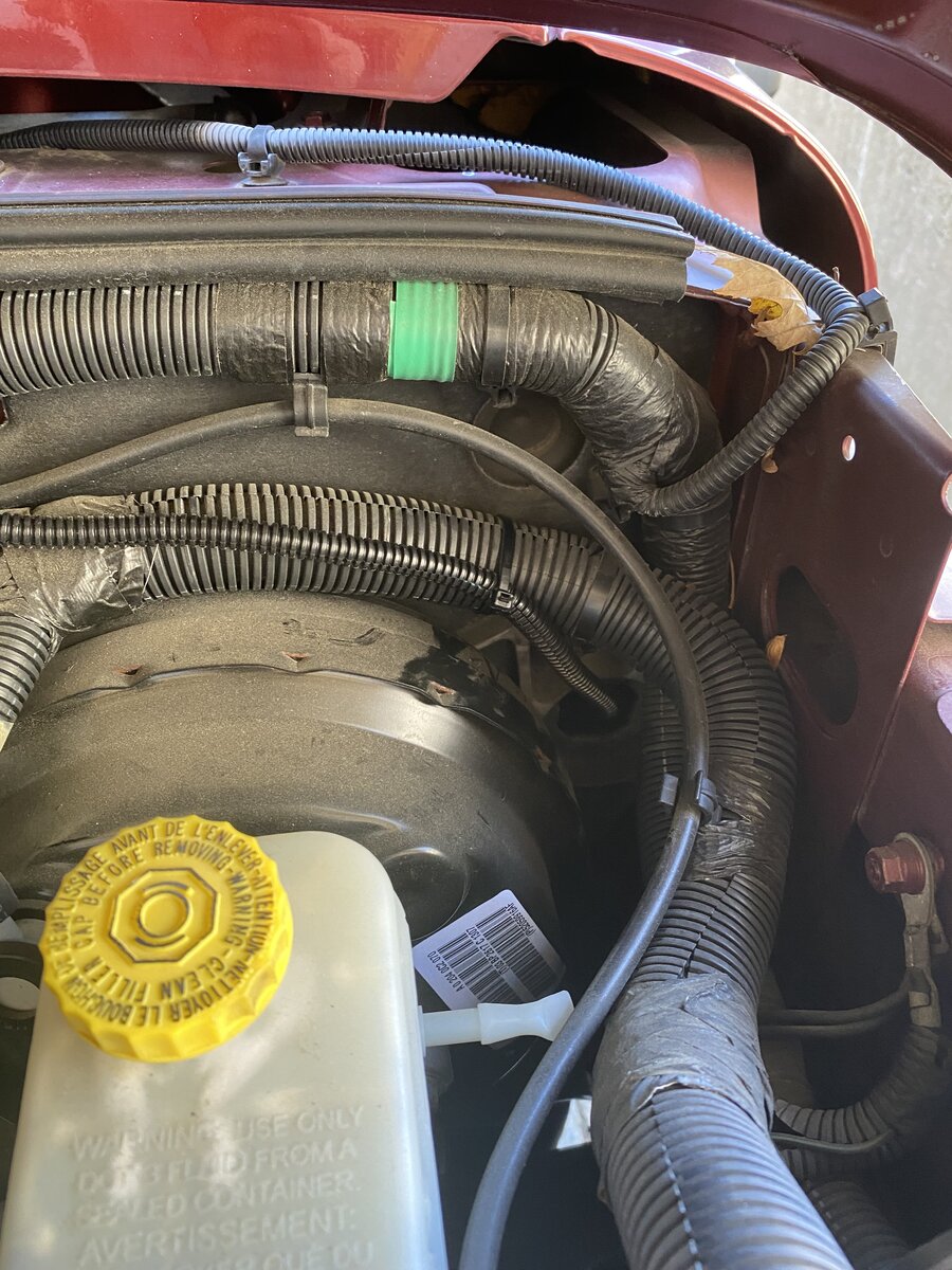

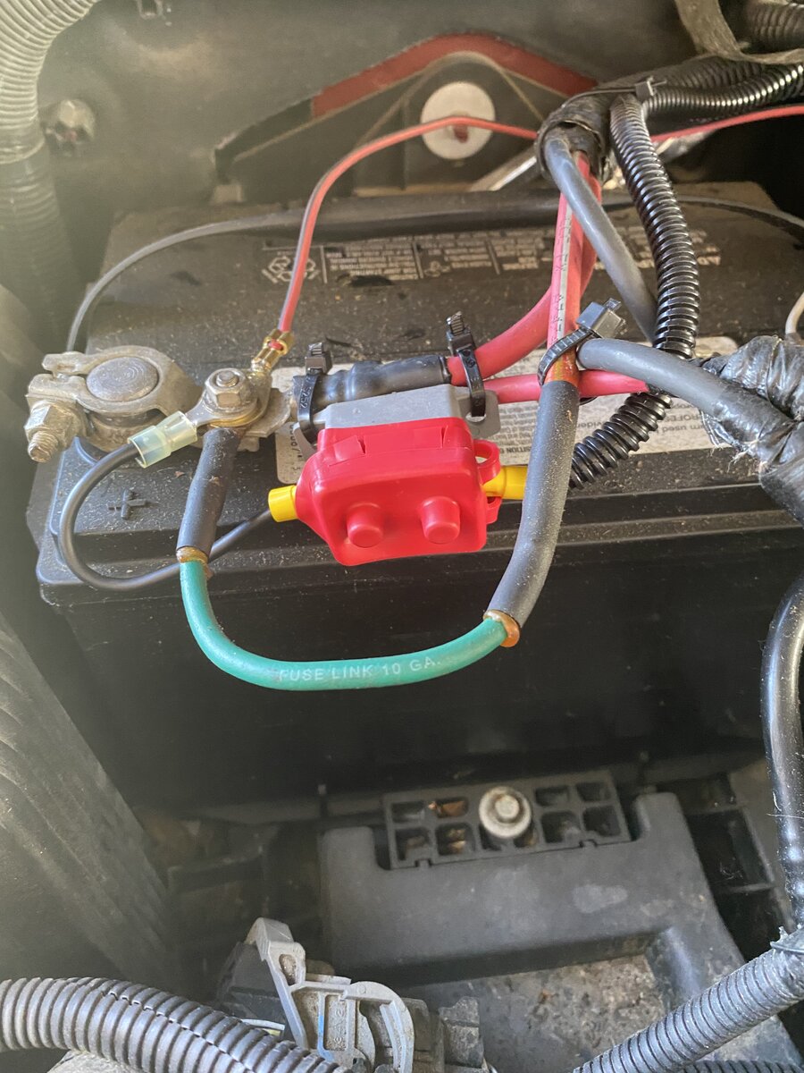

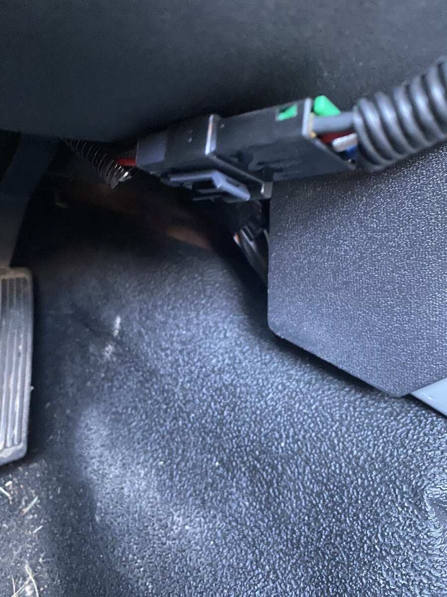

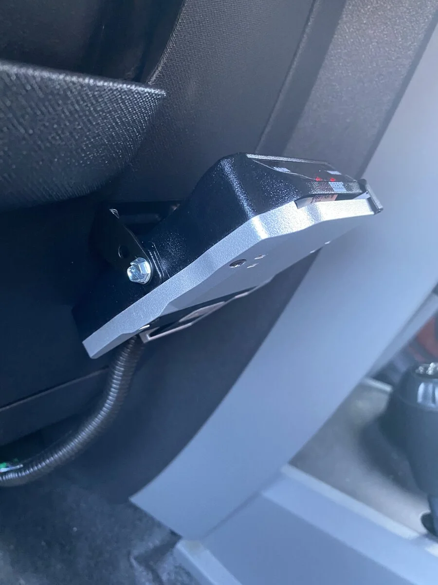

Had to install full 7 pin. Wasn’t too bad. Here is a list of what I bought for the job.
Reese Towpower 8506911 Brake... https://www.amazon.com/dp/B01HZWEHPY/?tag=jkforum-20
Reese Towpower 8508211 Brake... https://www.amazon.com/dp/B01M59QRWK/?tag=jkforum-20
Fastronix 20A 12V Type 1... https://www.amazon.com/dp/B07NSFGGT1/?tag=jkforum-20
Had 10 gage wire and some connectors sitting around but you can pick that stuff up at Ace Hardware. Almost forgot get one of these to tap into the brake wire for the controller . Make life much easier.
Reactions: mrjp and Vman
Some pics. Didn’t get any from underneath though.
Nice clean install!
Looks like you even put some heat shielding over the wires to the rear plug and loomed it. Now that's a job well done.
Actually came with heat shielding . Honestly if I had it to do over I would have paid someone to do it . My back is still talking to me. Lol
