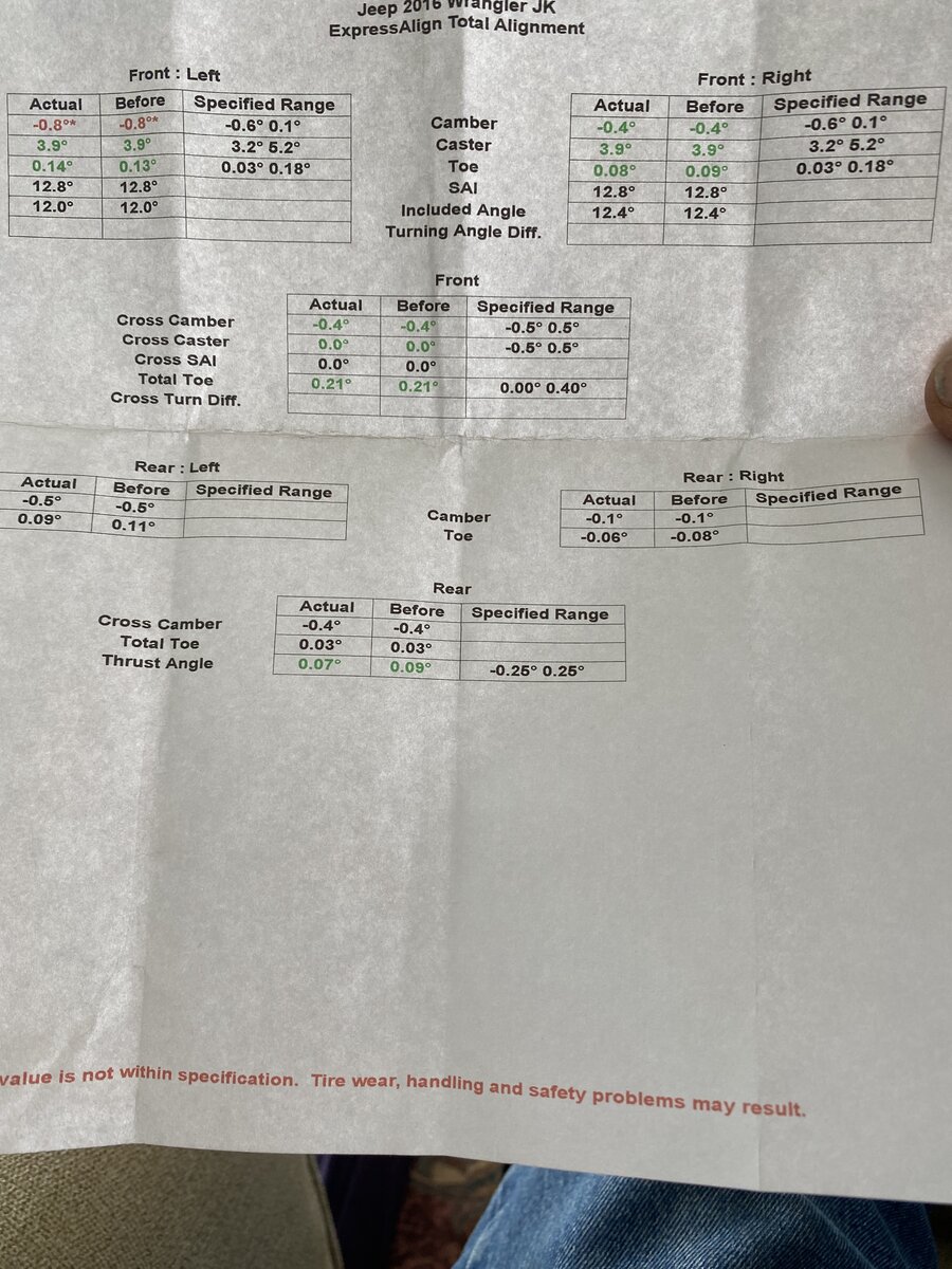

I have a 2016 that pulls to the right. There is uneven tire wear on the right front tire. Alignment shop can’t fix it.
I understand there are offset aftermarket parts that will adjust camber.
I’m attaching the numbers. Left front is out of specs but it’s the right hand tire that’s cupping.

You might have a bent axle or "C". You could try replacing the ball joints and/or getting a shim like you mentioned. An offroad shop should be able to tell you if the axle is bent.

Thanks, the shop said there are a no adjustments possible unless I installed an offset ball joint to correct camber. I have been misinformed before by shops so thought to do some checking with folks that know heck of a lot more than I…

I wouldn't do that without figuring out what caused it to get off. Either your knuckle is bent or your axle tube. Not much else i can imagine could do it without a bent track beat or something. Either way you need another alignment shop if they couldn't tell you why it was out of alignment.
If it's pulling right and just wearing the tire too quick it would be a tow issue which they should set and then reset the steering to straight. If it's wearing the inside or outside then it would be bent and needing camber but that's not really possible without something bent or broke with a front axle
