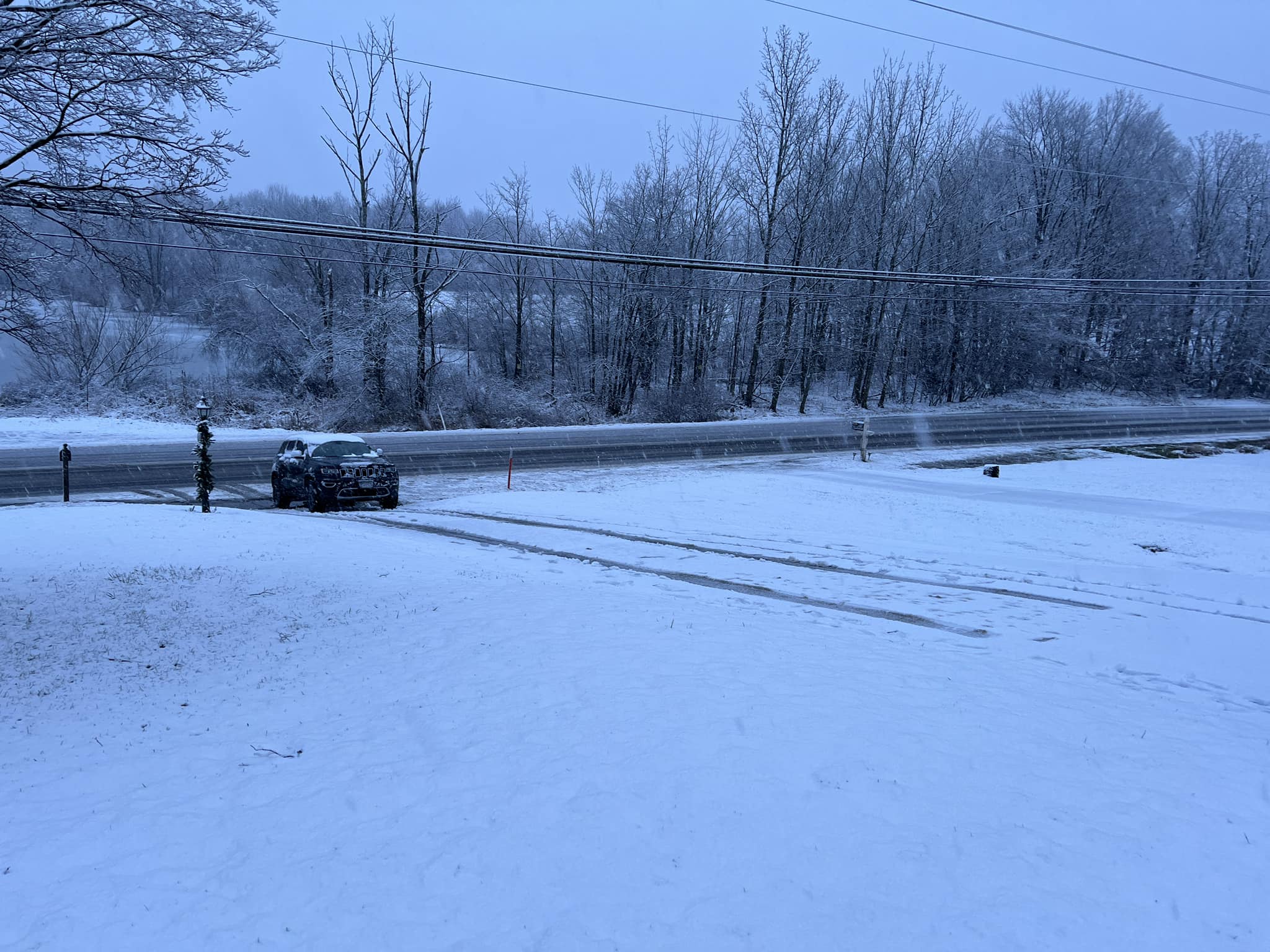

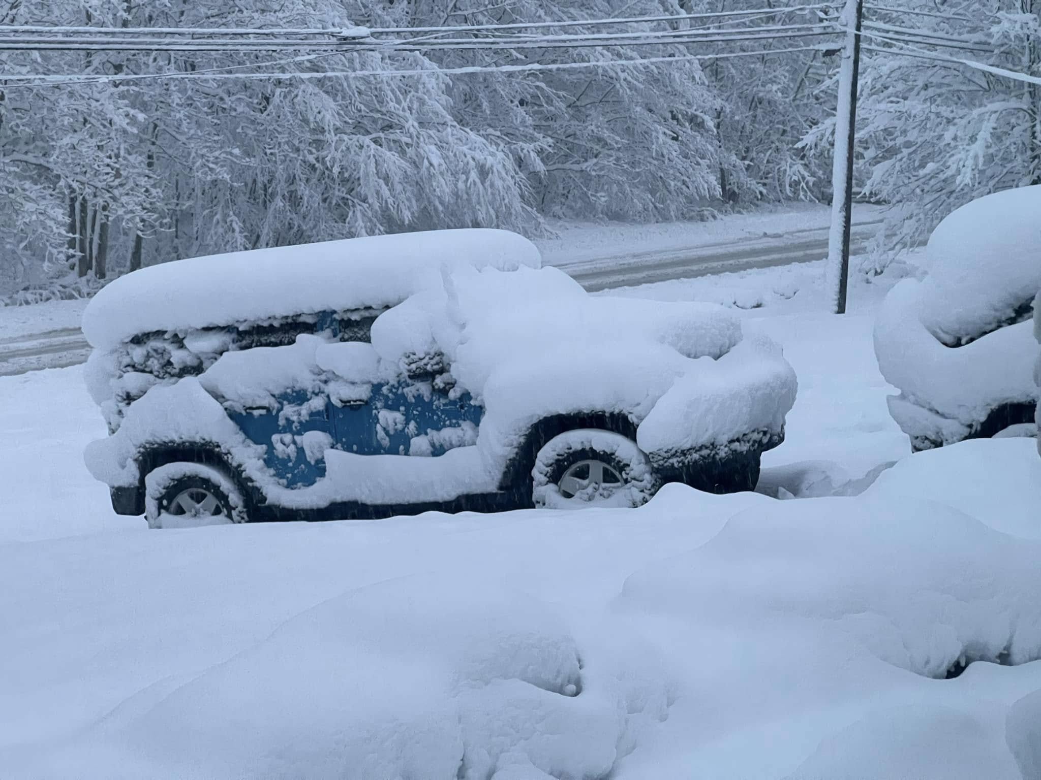

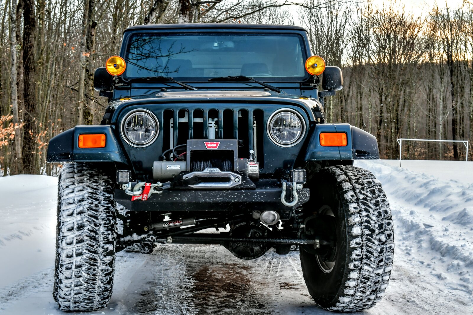

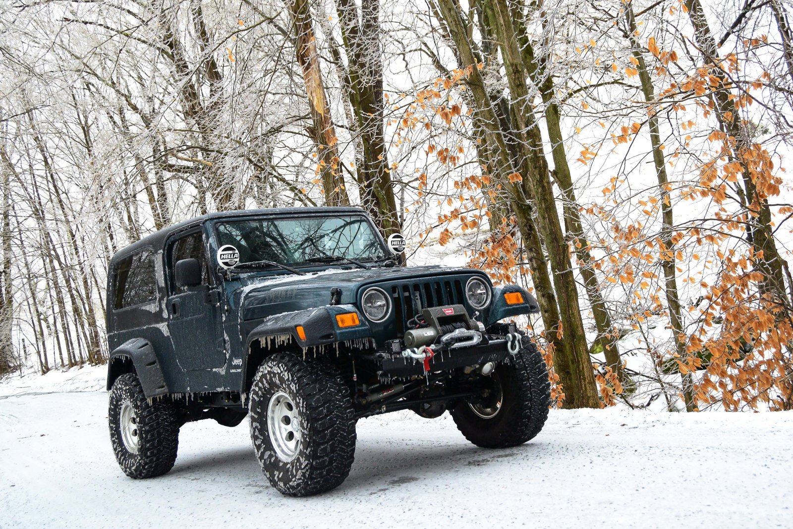

View attachment 129912View attachment 129913
As someone with a lot of experience with snow and winter driving, I'll say that the tires that are good for snowy and ice covered roads are the worst ones for driving through deep snow and large drifts. The opposite is also the case. If your usage mostly entails on-road driving, a set of Blizzaks are hard to beat. If you're romping through deep snow and fields, a good set of M/T tires is hard to beat. Somewhere in the middle are A/T tires, most commonly the ones with 3-Peak Ratings. Like everything, there are compromises and trade offs.
Note that similar to tire differences and their best application, traction aids that are helpful in something like deep snow (e.g. a locker), are potentially problematic for on-road driving. If you plan to do both, you may want to consider a selectable locker (regardless of tire size). A LSD rear and selectable front are notoriously reliable and predictable for winter road and deep snow driving.
Amber bulbs are a preference for the most part. I had them for quite some time and they worked well enough, The most important factory in visibility for me was getting them as low as possible. Getting the highest angle of incidence is what helps prevent glare and the "light speed" effect of heavy snow. I used the yellow bulbs up top as more of a warning light system when parked or working through dark back roads where I didn't want to disturb people or animals.
Thanks for the pictures and info! That first picture is a ton of snow where i live in Montana its always high winds, so hard packed drifts are common and i don't think there is as much snow as you get. The town i work in does not plow the roads and my drive home from work is well after if any traffic hits my gravel road very often im blazing the trail and busting up drifts. so about 8 miles a day on pavement then 10 miles on gravel. Based on your info it makes me want to lean towards A/T tires, i think that would be a good compromise, as the roads and weather do what they do as they want and i don't have the money or time to have 2 sets and swap as needed. Again, a huge thanks and the last picture is just what as was thinking when i said aggressive looking, i love the front wheels showing off and open like that!
I think a good A/T would be right up your alley then. The KO3 is supposed to be a good winter option, though I've never used them before. My daughter has the KO2's and they're decent on snowy roads, but less than ideal on icy roads (I insist that she simply doesn't drive on days when ice is a problem). My favorite winter A/T tire is the Cooper Discoverer AT3 4S. My wife's 2017 GC Limited is AWD and goes everywhere with them on.

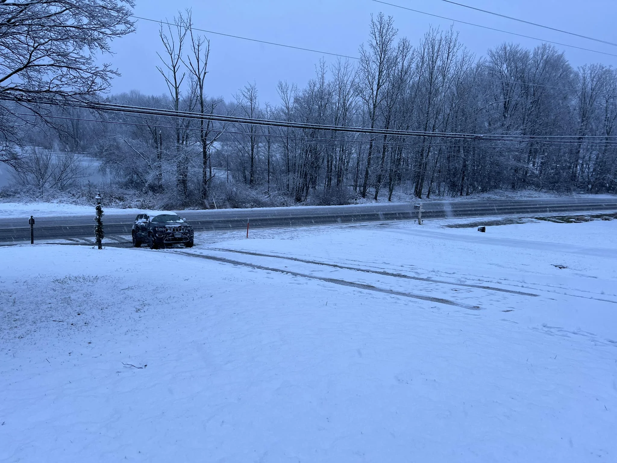

A funny incident above... we came home from something as the snow and ice were just starting to build up. The GC made it up the driveway without any issues - just some normal slipping where the BLD worked its magic. However, about a half hour later, my wife asks me "did you move my Jeep to the end of the driveway?". Of course, I had not - the Jeep just slid down the driveway! Just goes to show at how well these Coopers grip...
Unfortunately, these tires were recently discontinued. Cooper has replaced it with the Cooper Discoverer Road+Trail AT, which is supposed to offer increased performance but we haven't used them yet. If they're as good as the AT3 4S, then they're an excellent option.
:rolleyes: So fortunate that the Jeep stopped before entering the road - that could have been messy.
