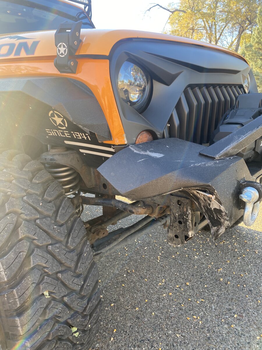

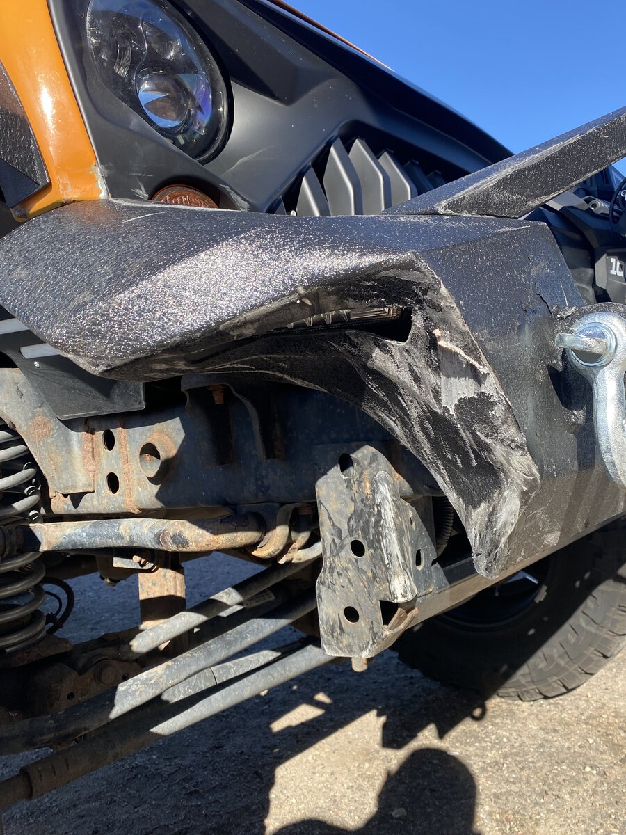

If purchasing a no name brand from Amazon try
and get a pic of the winch mount . The PO put on my
current front bumper . There is space to mount the
winch but the winch mount is only welded to the bumper.
There is no bracket connecting winch directly to the frame rails.
The bumper itself looks good, tough 3/16 thick, quality welds.
Just designed poorly when it came to mounting a winch.
Its why I'm not rockin one yet.
Trying to decide if i should modify this one or get a bumper
with proper winch mount. The quality brands have a plate that
will extend to the frame rails and bolt up where the bumper attaches.
As beefy as my bumper is dont want to find out the hard way that
current winch platform is sub par. There can be extraordinary stresses
placed on gear when winching yourself or someone else out of of a jam.
