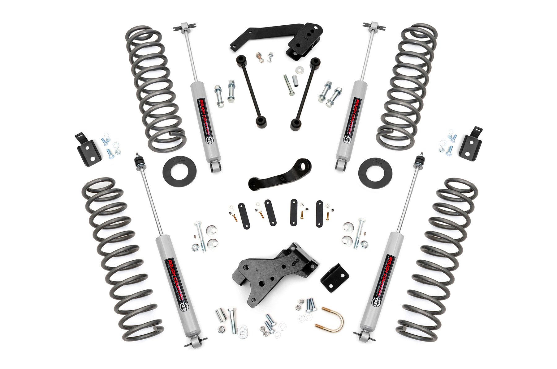

If possible, you could post a link to which kit you installed, because I want to check out the components and see what the kit has you install. Rough Country is known for building very shoddy quality lifts and including components that actually do more harm than good (i.e. drop pitman arms, dual steering stabilizers, drop trackbar brackets, etc.).
Well, that dropped pitman arm is a big no-no, as it completely messes up the geometry of the steering and introduces bump steer (this is a known issue with drop pitman arms).
However, I'm unsure what those other brackets are in the kit. Is one of those mounted to the front track bar where it attaches to the frame?
Another issue I see is that at 4" of lift the control arm geometry is off. Since this is a cheap lift, it doesn't include adjustable control arms or geometry relocation brackets for the control arms. Because of this you're going to have caster that isn't anywhere near stock, nor can it be adjusted (since the control arms aren't adjustable). This is also going to cause issues with the steering such as not wanting to return-to-center.

It has a track bar relocation bracket but it dosent move it much and the only caster adjustment there is on the lower control arms u notch out the frame are and have caster bolts in it
The bracket in the center of the picture near the bottom is a riser bracket you bolt the the rear axle and you use the stock track bar. That must be the cheap kit that was on my JKU that I just took off.

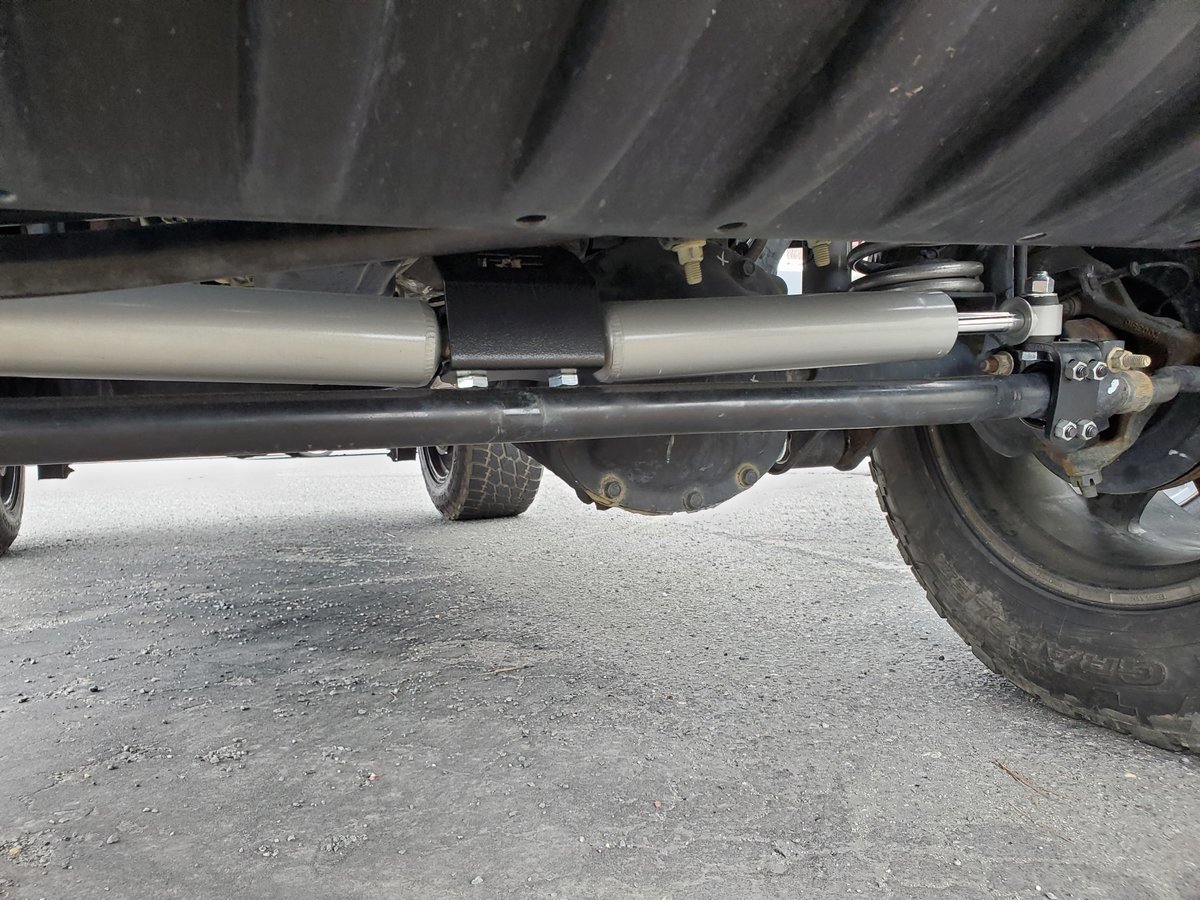

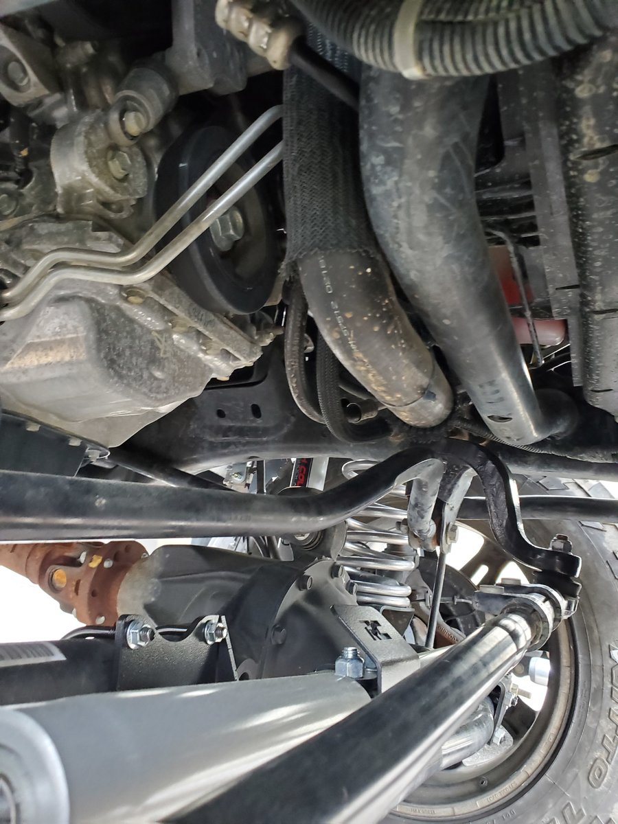

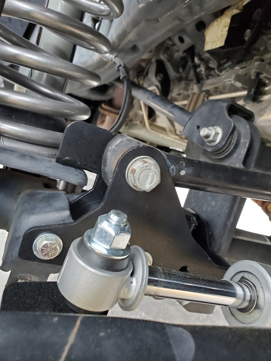

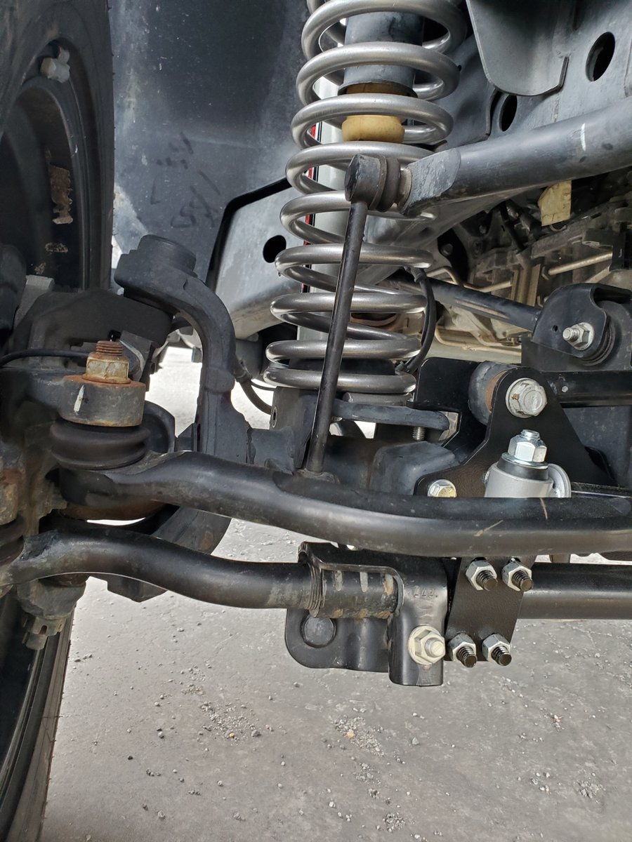

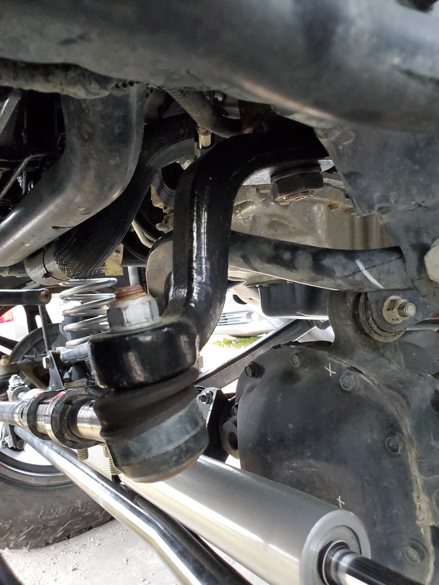

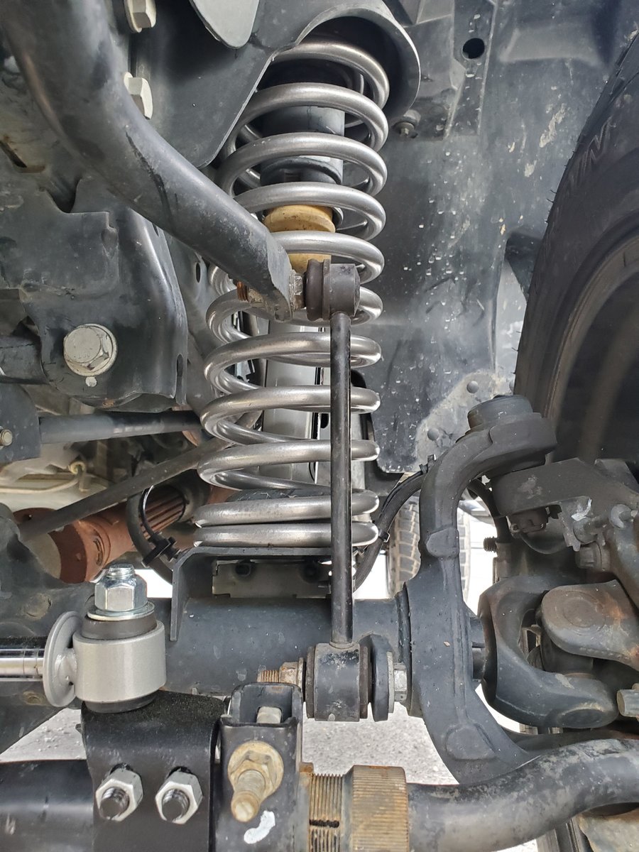

Pics of front end
You installed the Dropped Pitman Arm but not the drop track bar bracket. That's where you need to start, remove the DPA and leave the dropped TB bracket off.
***Edit: I see where the JK bracket is on the axle side. Still need a shot of the drag link and track bar though.

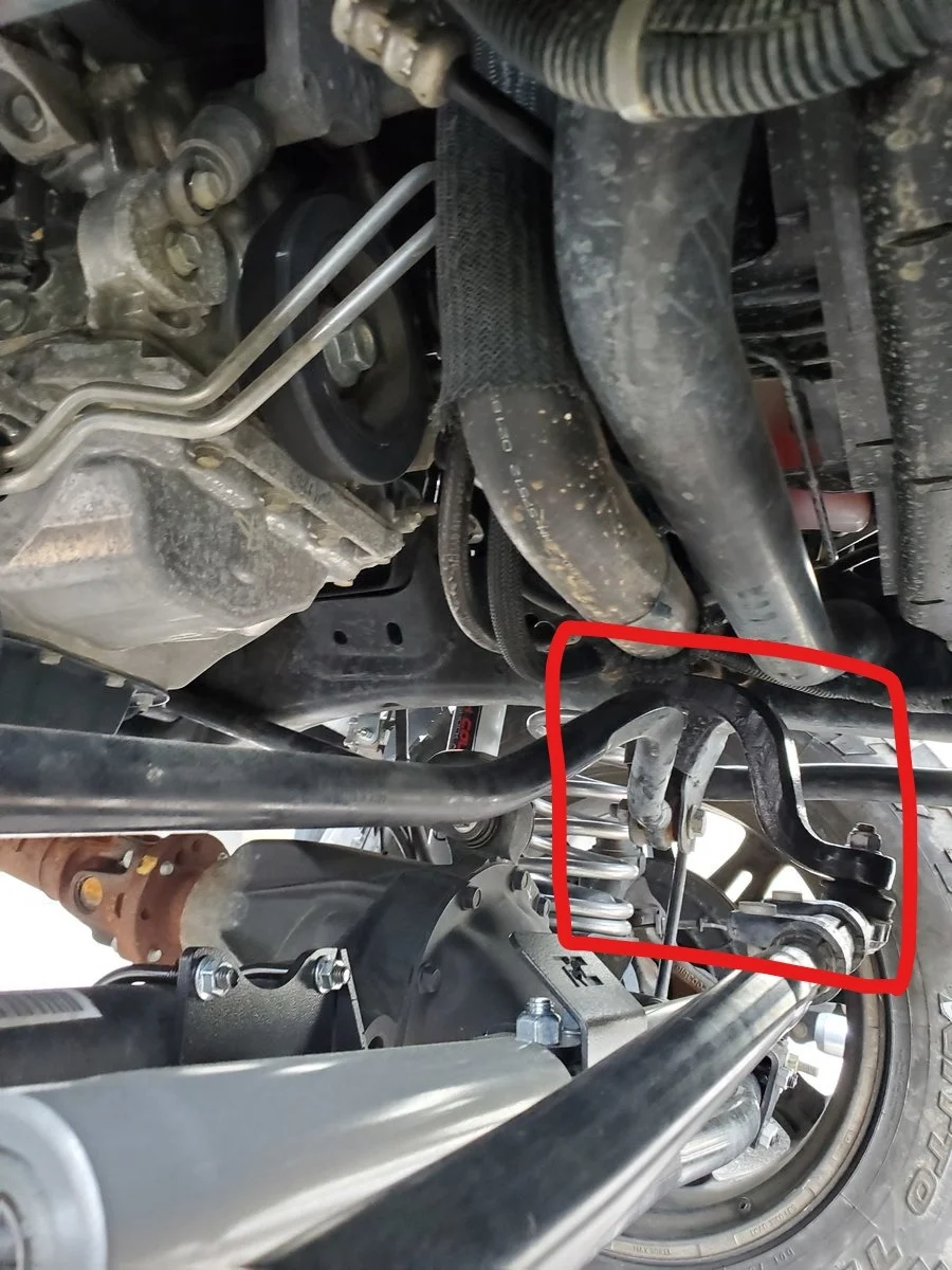

Get a straight on shot from inncer C to inner C if you have the time, but what I circled is probably your issue.
It looks as if the other end of the track bar has a raised bracket for the track bar. Seems to me a adjustable track bar would be better then having a raised bracket to allow for the raised truck. His next to last picture shows the bracket.
Your best bet is to put the OEM drag link back on and post the alignment actual readings. An adjustable track bar and original mounting locations is best. Also remove the steering stabilizer. That will just add strain to the pump and gear.
