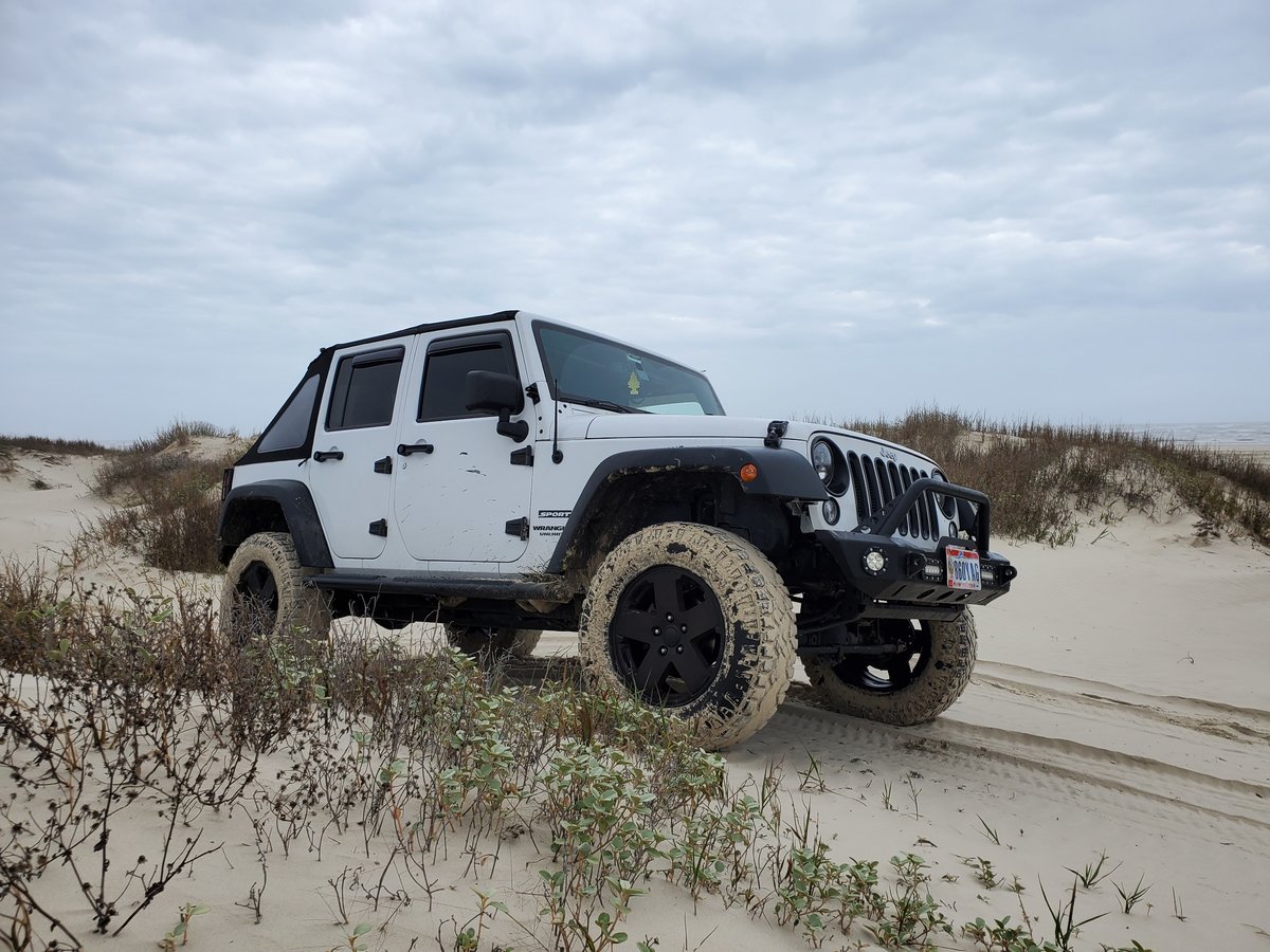

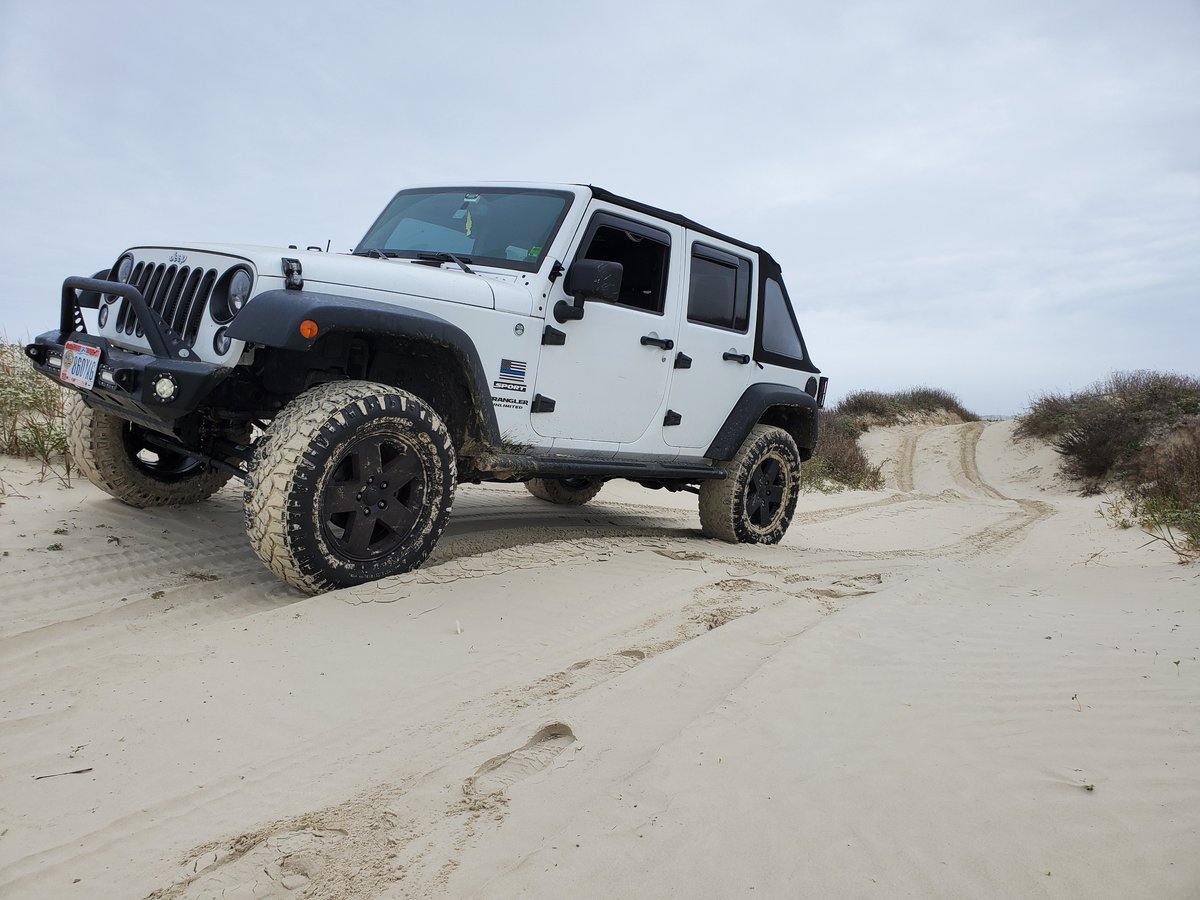

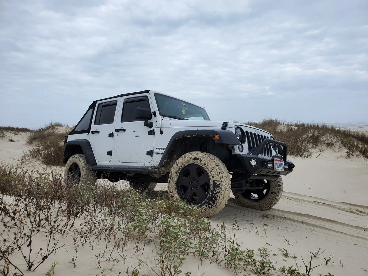

Here's the jeep
Common issue can include but not limited to salt, sand mud etc can enter this are of the ebrake and if allowed to sit there will cause the system to lock up. As you're image show, you've done some off roading on the beach and if not properly clean afterward, one will encounter this issue. it is best to maintain the ebrake with a regular routine maintenance and clean the system up as well as oil/grease the cables etc.
