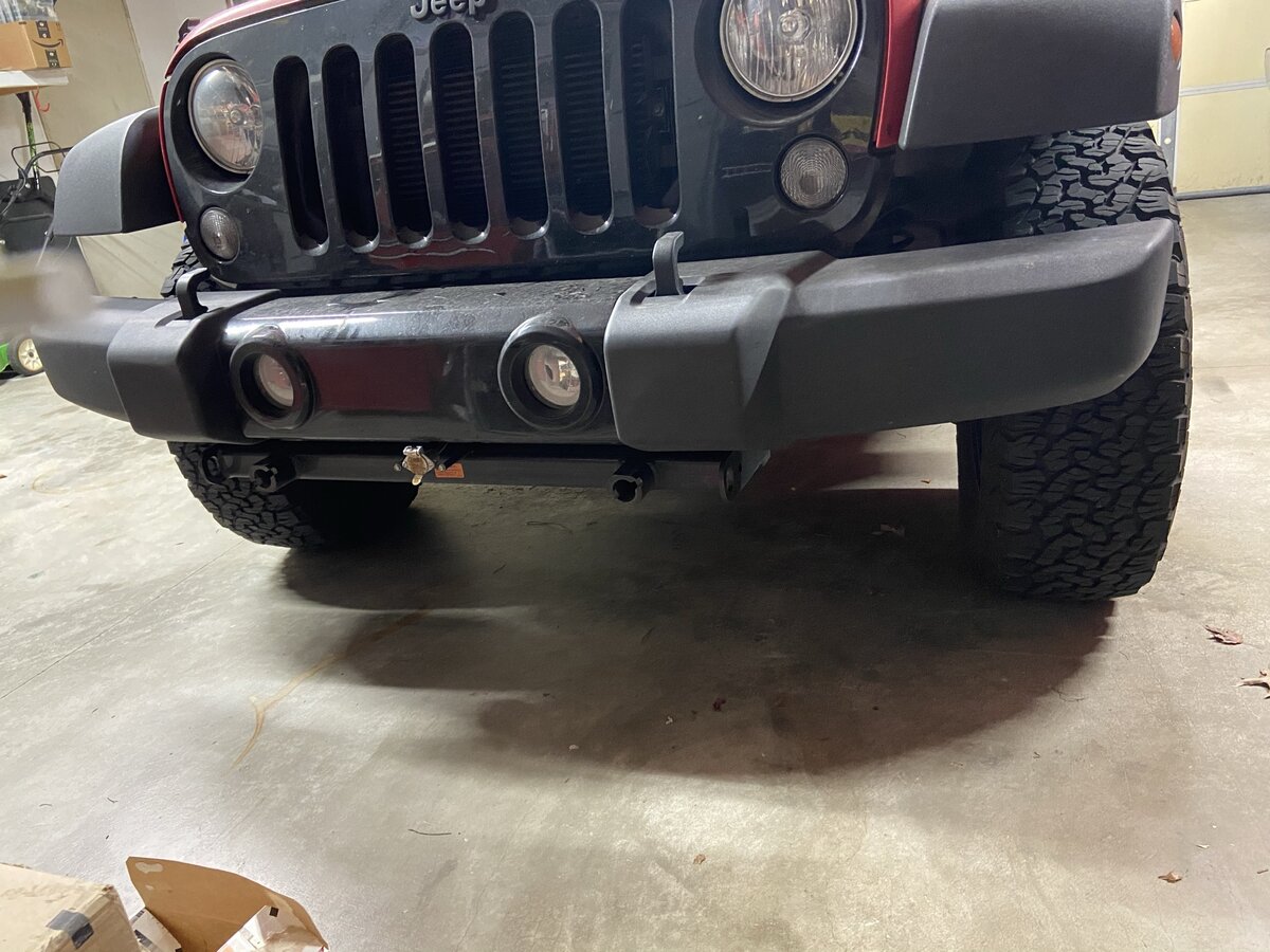

I have a blue ox baseplate installed on my JK For towing behind the Motorhome. Looking for an aftermarket bumper that will fit. Anyone running this setup?

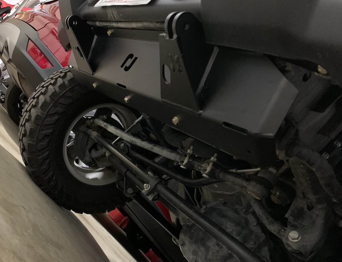

So I'm trying to put together my list of components to flat tow my JK behind my motorhome. Leaning towards Currie mount. Then see what Tow bars go with it.
Would love a direct off road bumper mount but it appears that is not recommended for long distance towing

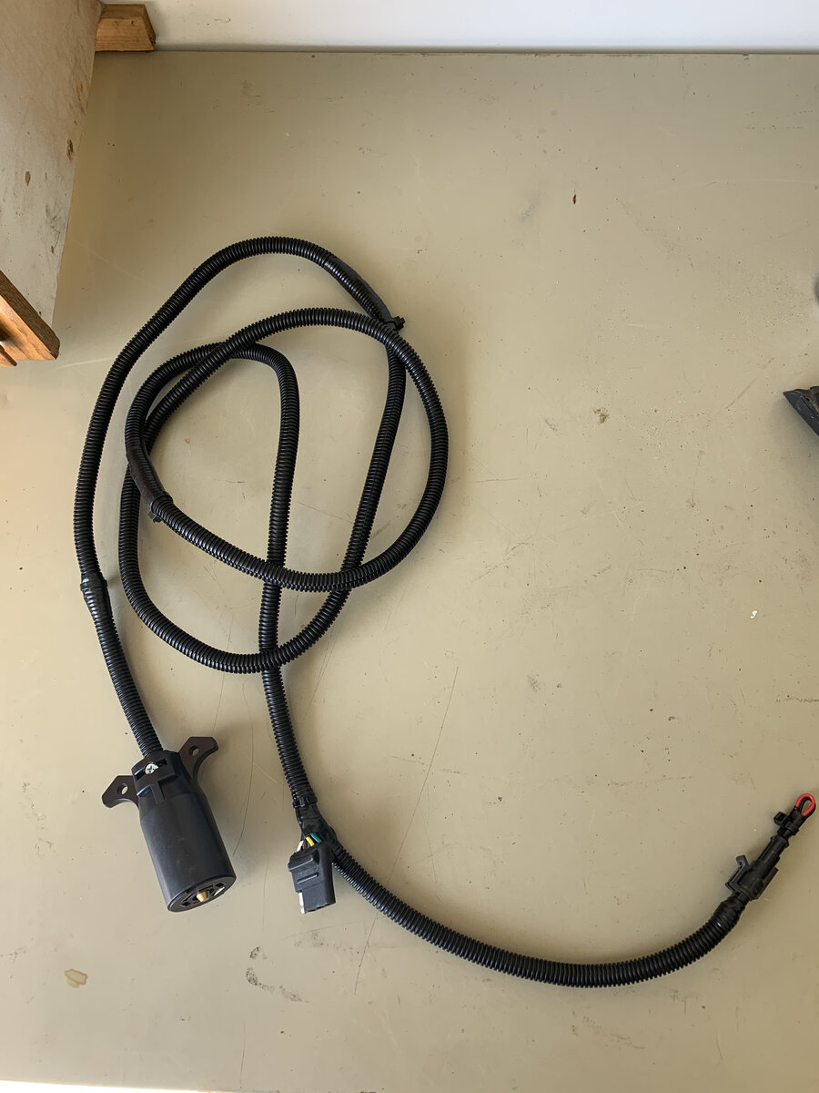

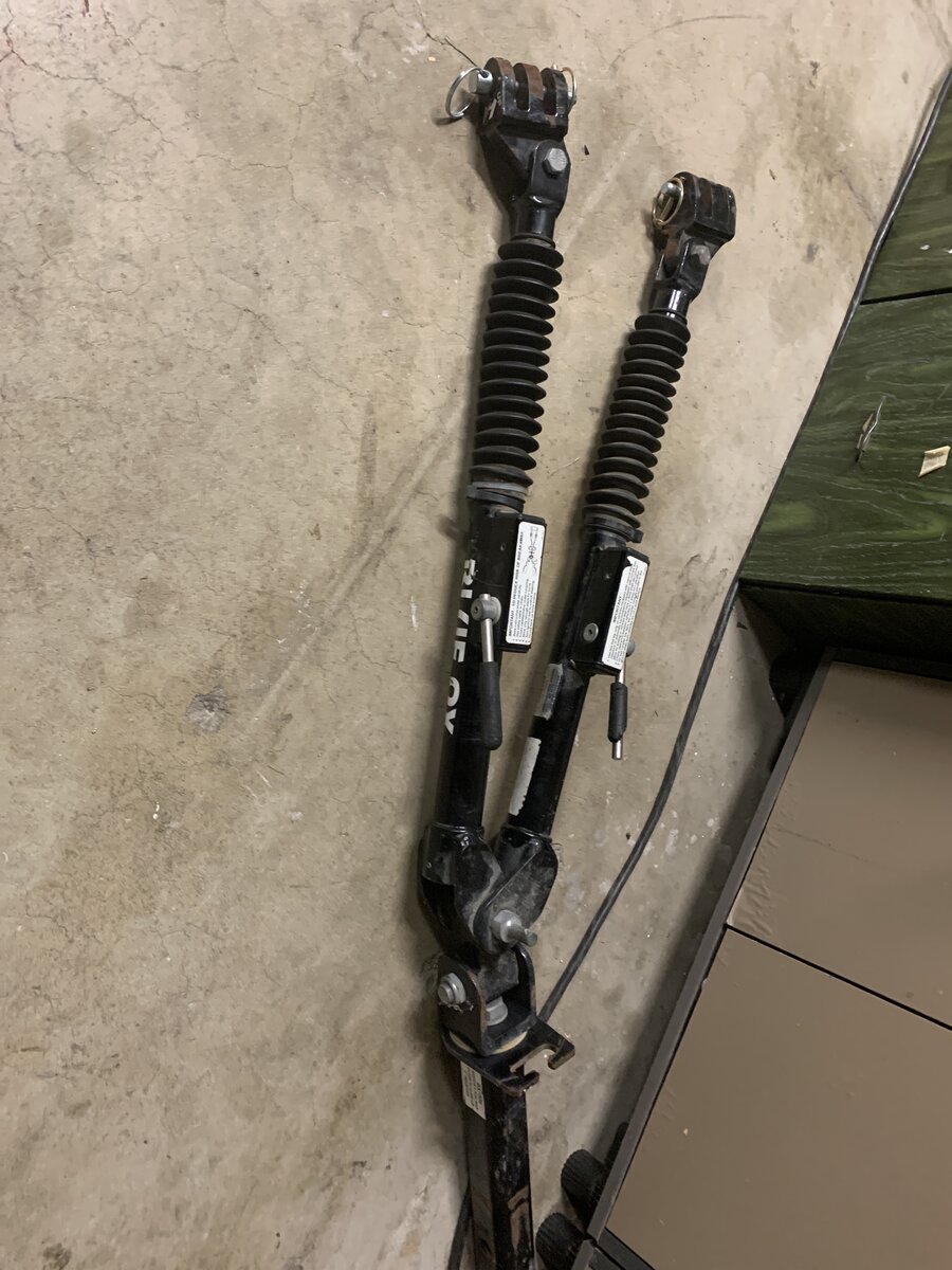

I went with the Currie mount and after replacing my friends jk rear control arm brackets yj rear shock brackets he gave me a blue ox steel 10,000 lb tow bar so did not need to fabricate my own. Hooks right up and will tow very nice behind our motorhome. Also went with the Curt rear tail light harness, plug-n-play with just a ground to connect, otherwise just route and mount plug at front. Now just deciding on which brake system to purchase, leaning towards a brake buddy select 3 if anyone has any experience input is appreciated also.
Did you have to cut down the extended material on the Frame ends?

I did nothing with extra ends on bracket at this time. I will probably add a bracket at the ends to crossmember for added strength, also i am going to a few small welds where brackets meets bottom edge of crossmember. I am not sure about all the extensions with ready brake onto hitch receiver, and less installation for brake buddy to me so far but still looking.

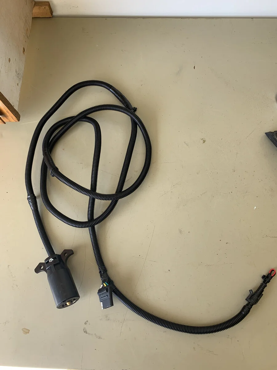

Yes the rv 7-way has one connector that is constant 12v accessory power. The brake buddy comes with a breakaway switch with cable also which will apply jeep brakes if becomes disconnected. I ordered a universal 7-way from e-trailer and took about 30 minutes to remake the harness.
I have a blue ox baseplate installed on my JK For towing behind the Motorhome. Looking for an aftermarket bumper that will fit. Anyone running this setup?View attachment 117377
If you are talking off-road, the only one, less expensive one, is Smittybilt which fits over my Blue Ox. (Install the fog lights first)
