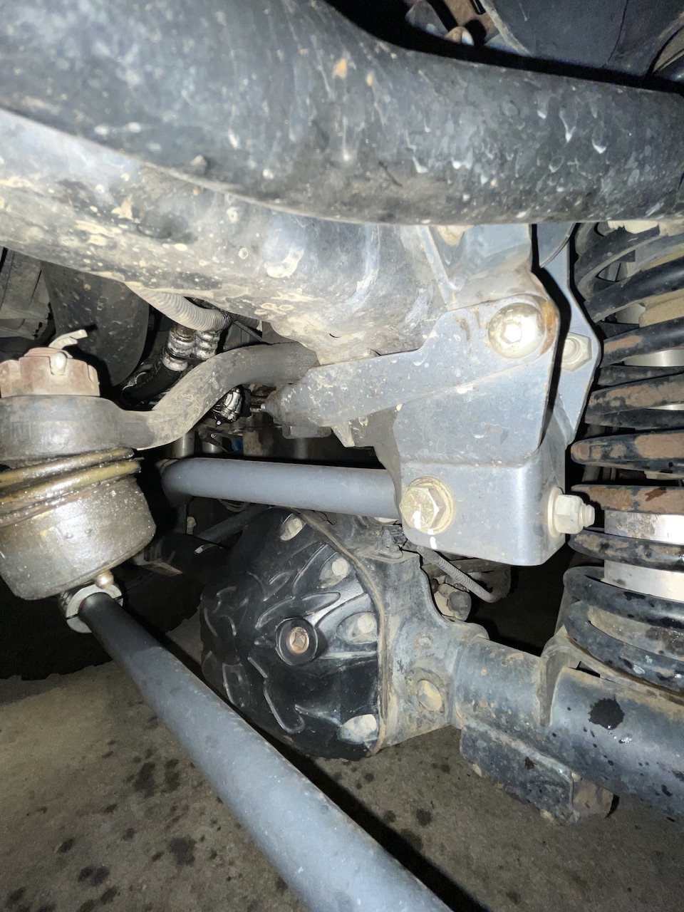

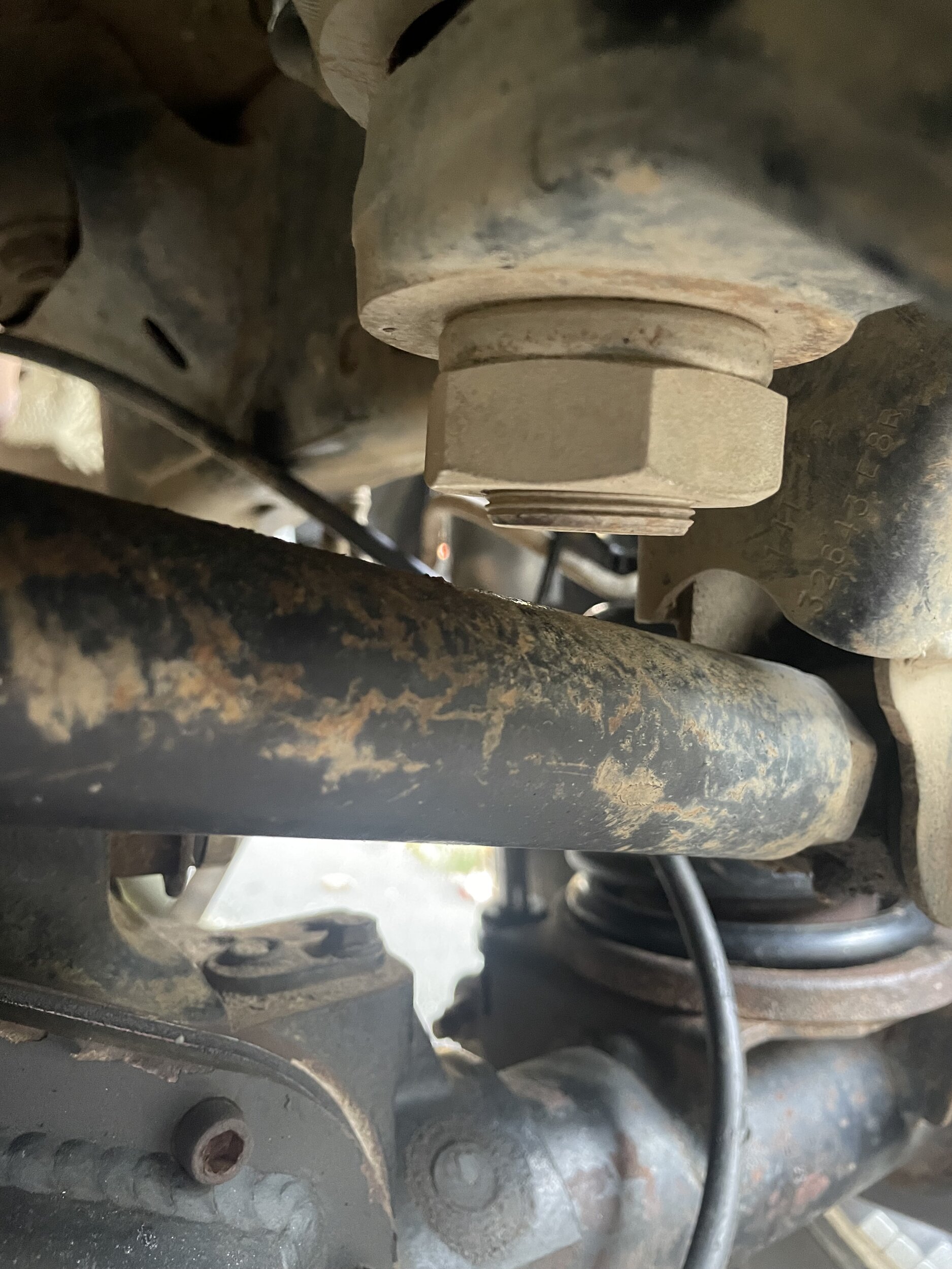

I recently switched over to high steer knuckles/drag link flip and I’m concerned with a clearance issue I’m having. I raised my track bar up to line up with my drag link but the space between my rock krawler gen 1 track bar and the psc big bore sector shaft is really close. I’m wondering, if anyone else has had this issue what track bar did you go with that provided more clearance?

Thats at ride height. I’m not interested in running a drop bracket. I have however heard that synergy and a few other brands are angled enough to leave some clearance.

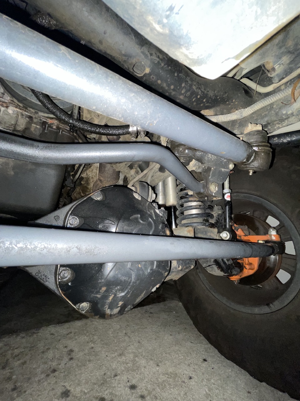

I’ll snag a pick of my Synergy bar to show it. I don’t run a BigBore so it’s not a 1:1 comparison.
And I feel you on the drop bracket, those don’t tend to end well, especially with the added forces from the PSC.
Just asked my bro who runs a PSC on his 15JK. He runs a Metalcloak trackbar and has not had clearance issues.

Pick of my Synergy bar and brace (no drop bracket) to show it. I don’t run a BigBore so it’s not a 1:1 comparison. They don’t have a drop but rather a bend for the differential.
Just asked my bro who runs a PSC on his 15JK. He runs MetalCloak trackbar with no clearance issues.

Thank you! This is exactly what I was looking for.🍻
