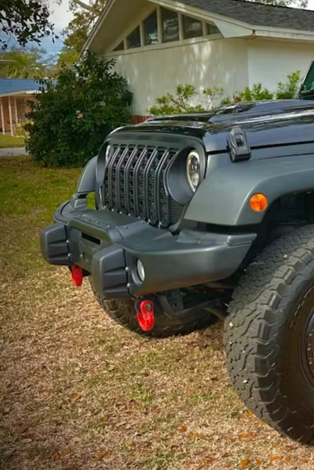

This grille pops up on a few of my death scroll reels. It’s out of stock and I realize it’s probably not well made. But I like the enhanced air flow possibility. I am very against the “angry eye” look (no offense to anyone who has one installed). Any other options that might be close to stock looking with better air flow? I’m open to ideas.
yeah dude the stock grille sucks for cooling. i went with an angry eyes setup on my hemi and it flows way better. plus looks way meaner lol. heard good things about the poison spyder grille too if you want something more subtle. depends if you're actually wheeling hard or just want it to look cool tho
I like the stock look but want more flow. Do you have a link to the poison spyder grille? I did not see one on there sight.
Interesting but when wheeling, it runs cool. Even Rock crawling it stays cool. It’s at freeway speeds that I have a problem. It’s better now but I like under 200f

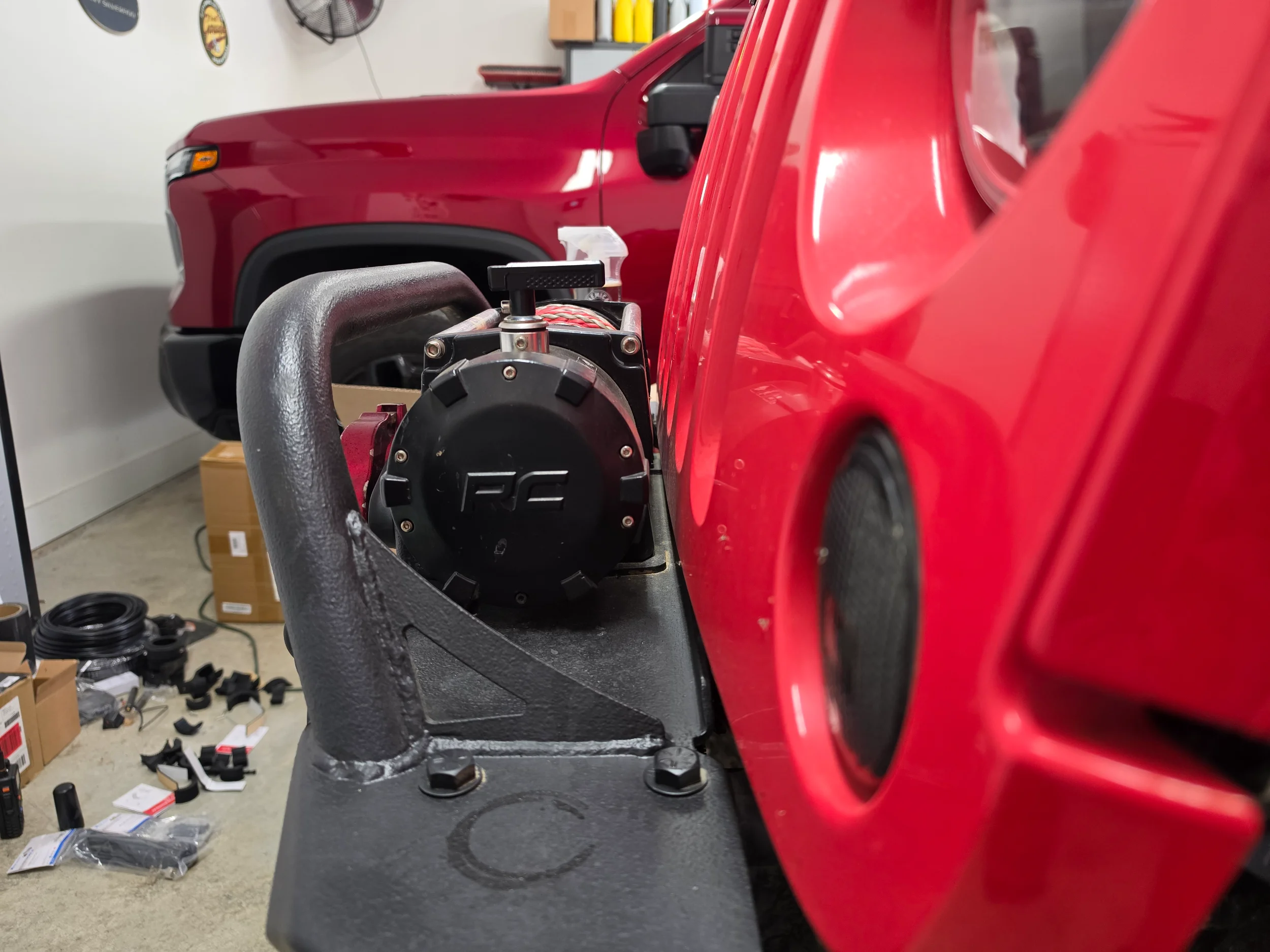

My warn poweplant sits close to the grille. I have to pull the air compressor cover to get the grille off. Do you think the grille's profile extends out from the front more than a stock JK grille?

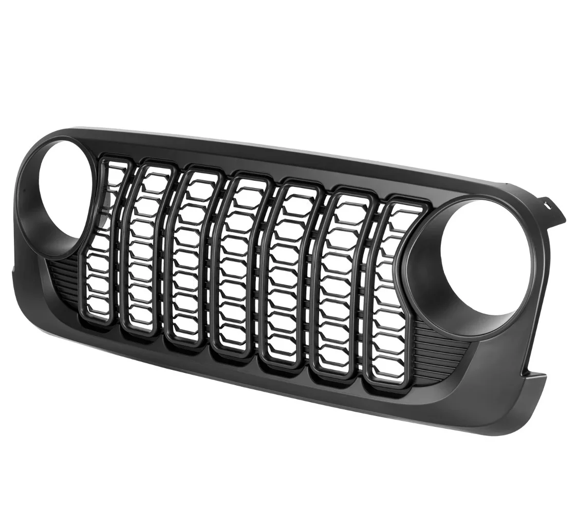

I think it is the same grille. Here is a slight side view and I can see the bend/curve on the slats close the same location as the one you posted.

If you have a Motobilt frame chop front bumper with a winch, I don't think this grille will work. My brother and a good friend have one on their JK's because they have high horsepower V8's. My stock 3.6 is cooled fine with the stock grille, including my steering through the PSC cooler. I have thought about one just for the looks, but my Motobilt frame chop bumper wouldn't allow it because of how close the winch is to the grille now.
I may be in the same boat. I’m running a Genright bumper and a warn powerplant winch. There is not enough room to remove the grille without pulling skins on the winch. Even then it is a tight struggle.
Reactions: mjonesjr84
