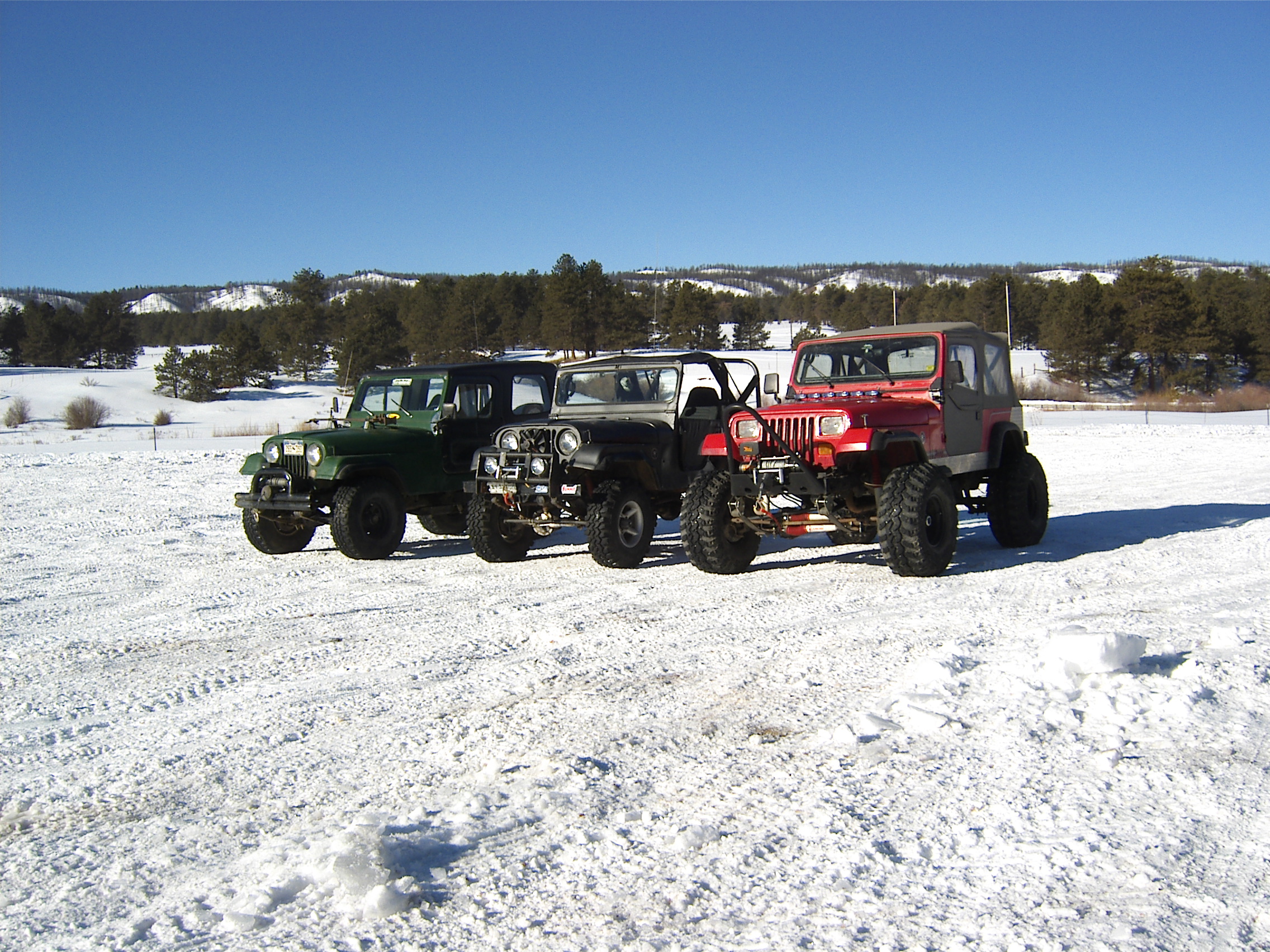

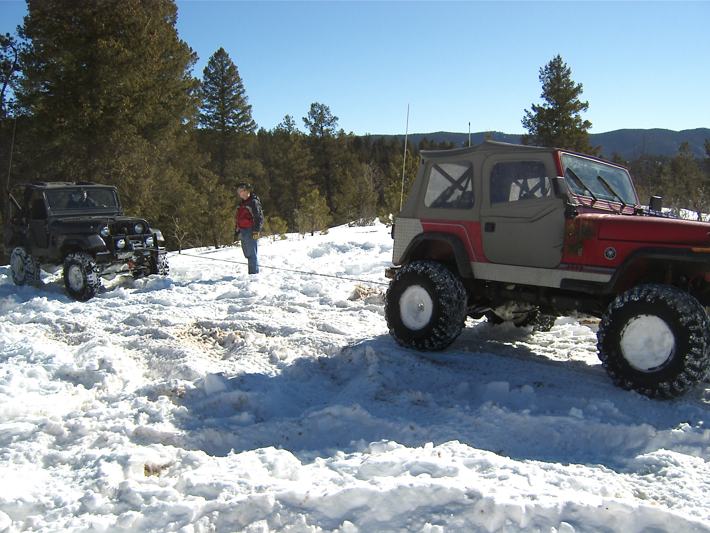

Best tire I've ever used in snow was a 40x14x15 Super Swamper IROK bias ply on wheels with Staun internal beadlocks. Running 0 PSI. Might not be ideal for a mostly street driven vehicle, though.
I've got Toyo Open Country MT's on both Wranglers. Excellent, but they're a bit loud on pavement.
View attachment 125585 View attachment 125584
