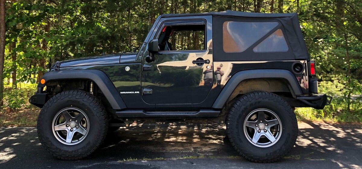

I'm running 35x12.50x17 in my profile pic.
Here's another with 315/70r17 which are metric 35's but Synergy springs
