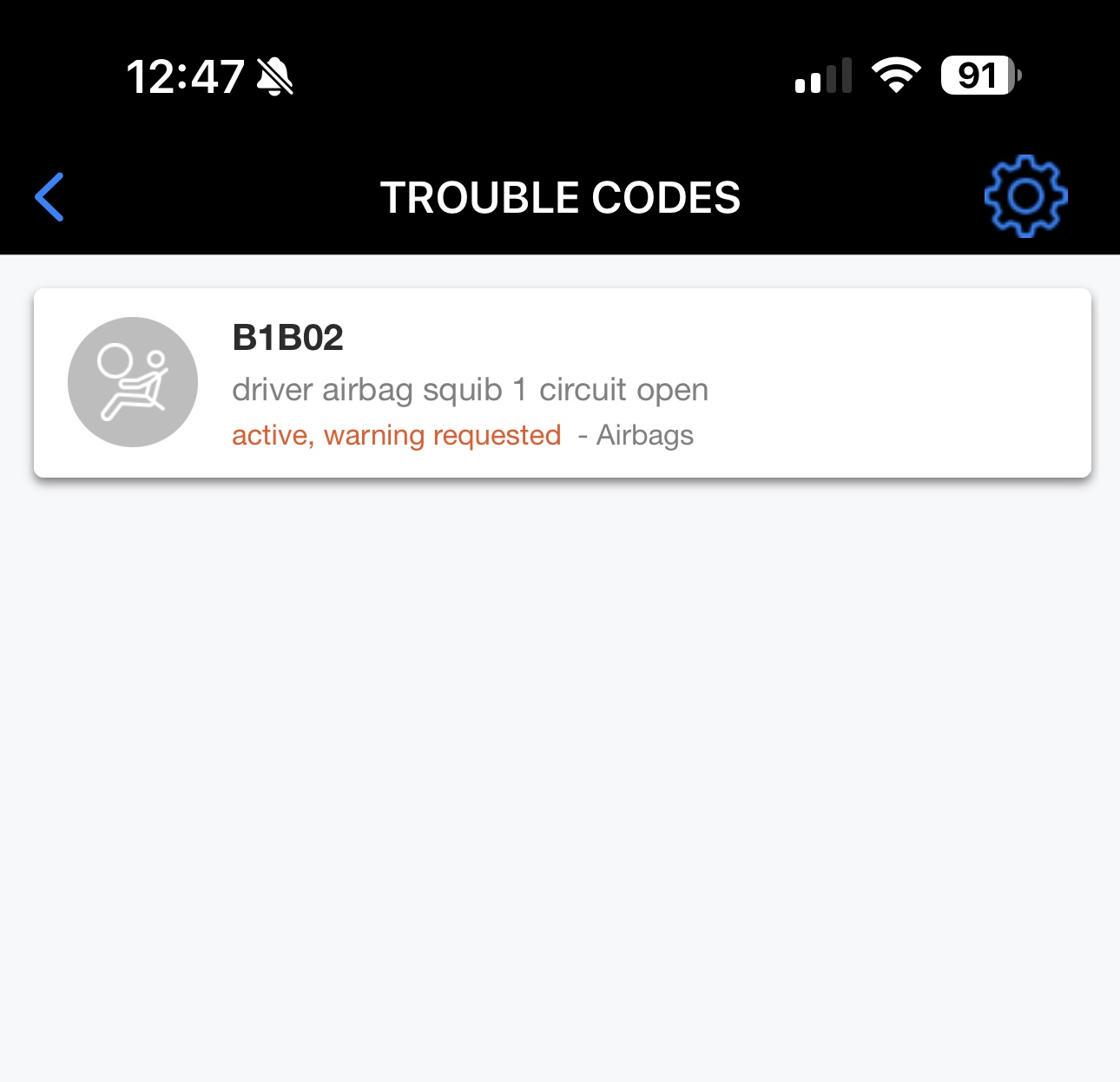

Does anyone know if code B1B02 indicates a bad clockspring? All the code description states is “driver open circuit”.

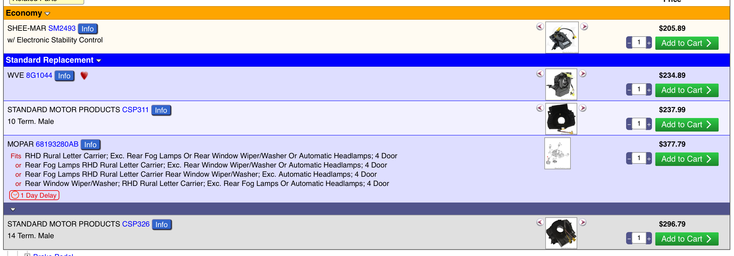

I am assuming it’s the clockspring since there is a known issue with them. Wanted to check and see if anyone had this specific code and replaced the clockspring and it fixed it. Looks like an OEM clockspring is around $300, anyone use an aftermarket one and have good luck?
The airbag recalls were done already. So I am hoping that is not the issue. I am probably going just going to move forward a replace the clockspring. Probably will go the OEM, but the cost differences are a fair amount compared to aftermarket.

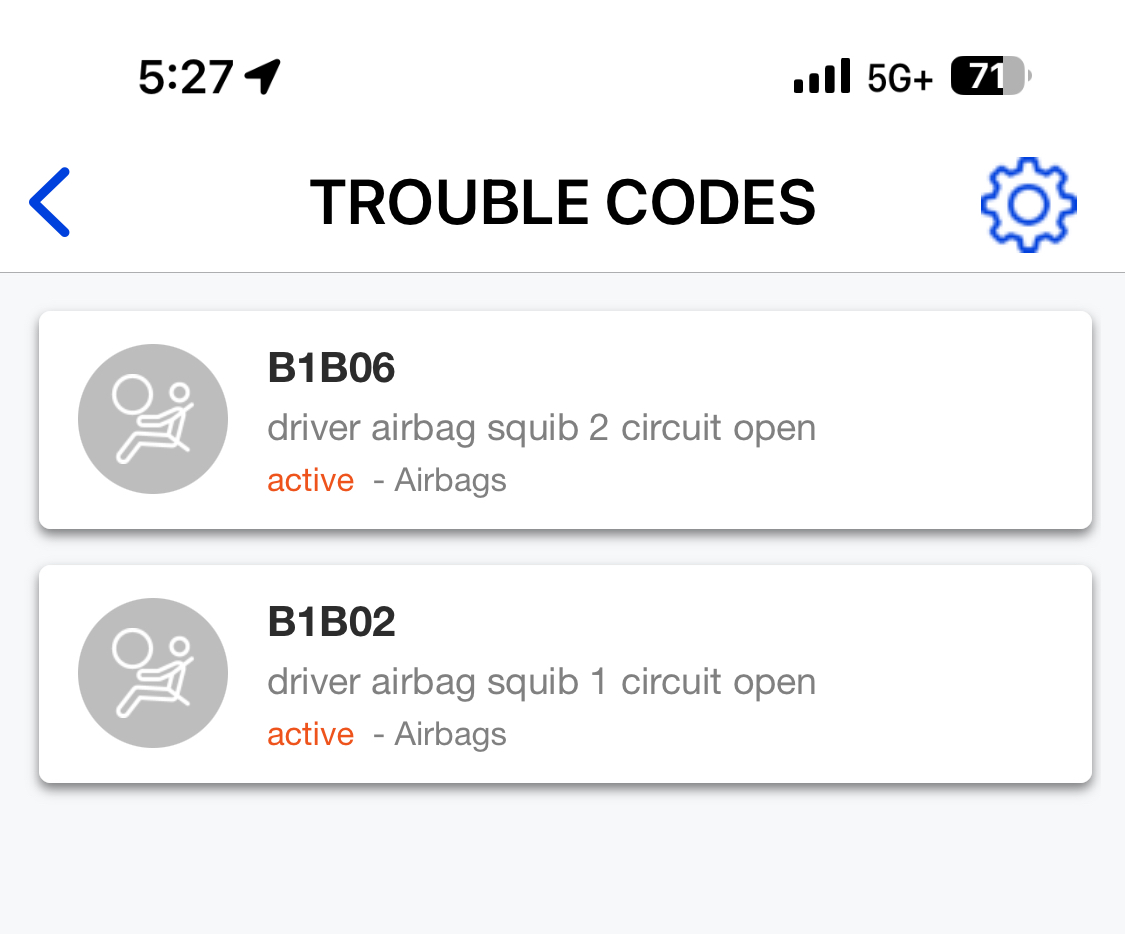

Hoping I can tag along on this thread. I have this:
It seems like "clock spring" is the common solution.
