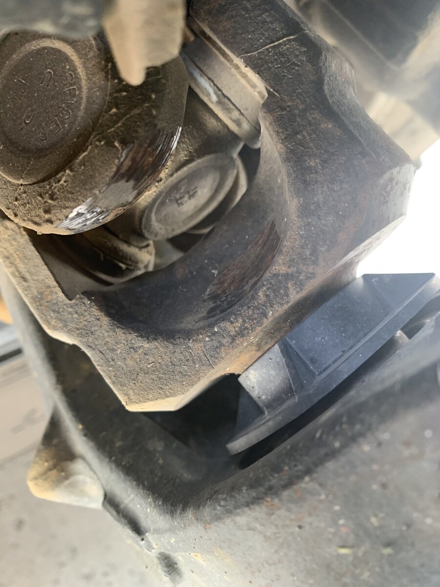

I have an ultimate dana 44 front axle. The last few times I have wheeled I get a binding sound coming from the front axle. When taking a close look I found that my axle shaft is rubbing against the stub shaft near the ujoint. See the picture below. Any idea what could cause this? Steering stops are tack welded in place, only happens in 4wd while turning and on unlevel ground, totally normal in 2wd at full lock. 1350 Ujoints look good as far as caps in place, seals look good and full rings still in place. It has happen on the driver and passenger side, seems to be different times though. Axle only has about 34k on it.
Any pointers on what could be causing this? Thank you!
