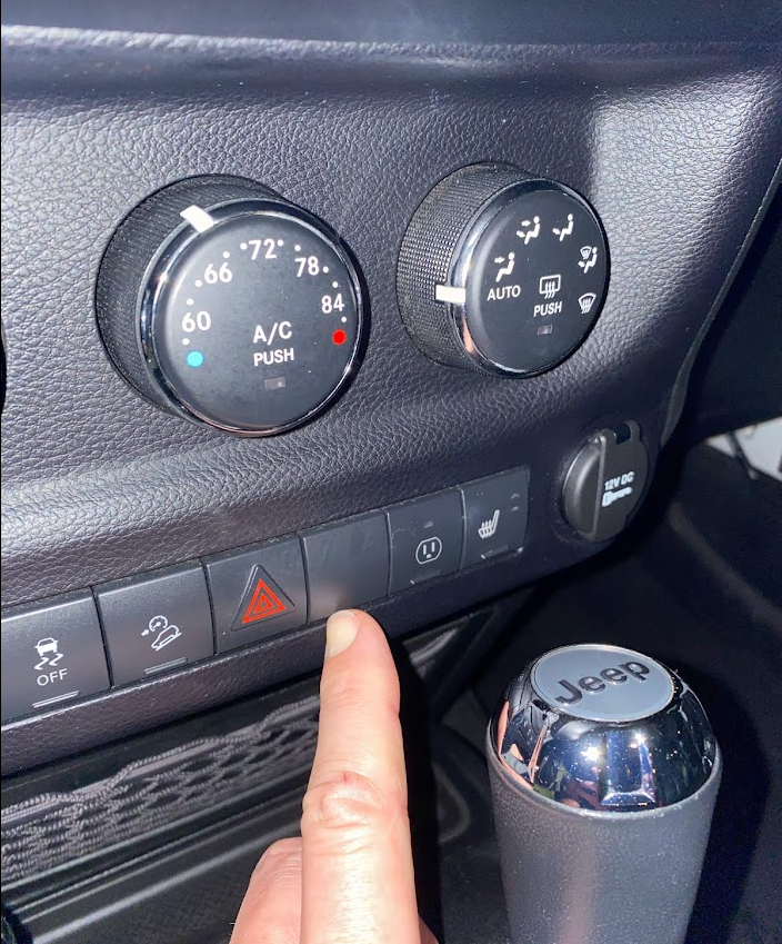

I'm looking to add a 12V AUX port & a USB charging port to the rear of the JKU.
I'm hoping that someone has found switch alternatives that will fit in a couple of stock locations if possible.
I searched and was only able to find reference to a switch panel that mounts above the RVM... I'm not looking to spend that much, or need 6 switches...

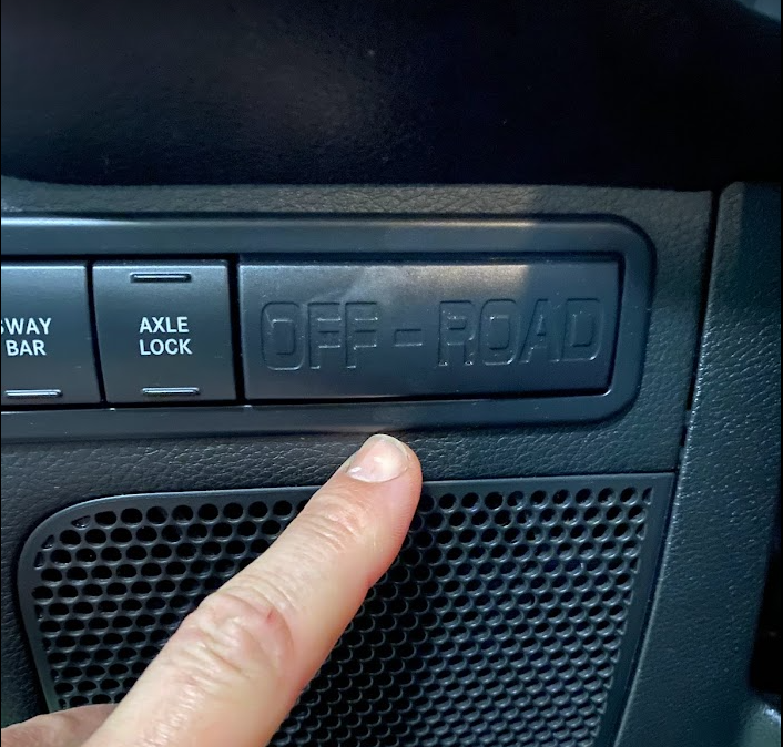

Anyway, I'm hoping to find one that will fit in the center console area by the hazard switch, or over on the left next to the locker & sway bar switches...
BTW, that "OFF-ROAD" filler is stupid, and it appears that 3 additional switches would fit there.
Is there an option or model that includes additional switches on the left, in place of the filler?
That's what I found also... I had hoped the aftermarket world would have figured this out by now and created a solution that doesn't look like an afterthought...
Looks like I'll be soldering and cutting if i want to install a switch that utilizes the unused factory locations.

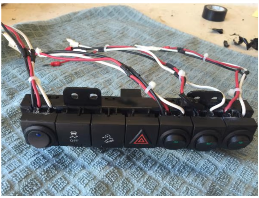

You can modify the blank next to the hazard switch, IIRC. I did it to the one on the far left in a previous jeep. You trim the blank which allows it to pivot. You then mount a micro switch behind it. That keeps it clean looking and stealth for something like a garage door opener. If you want it always on, you'd need to add a relay circuit. The problem is, there is a circuit board that runs the length which makes switch choice options limited. Or, there are very shallow toggle switches I've seen people mount online like this:

The same switches could be mounted much easier in the off-road blank since there is nothing behind it.
That's not far from my plan.
I may see if I can find a pair of those locker and sway bar switches on the cheap and then modify them to fit into the right half of that space.

Also, I may be wrong about it being totally empty behind the offroad section. I've never modified that one, but now I see conflicting posts about it. Still, searching the forums, it looks like a lot of people have added a couple of switches.
