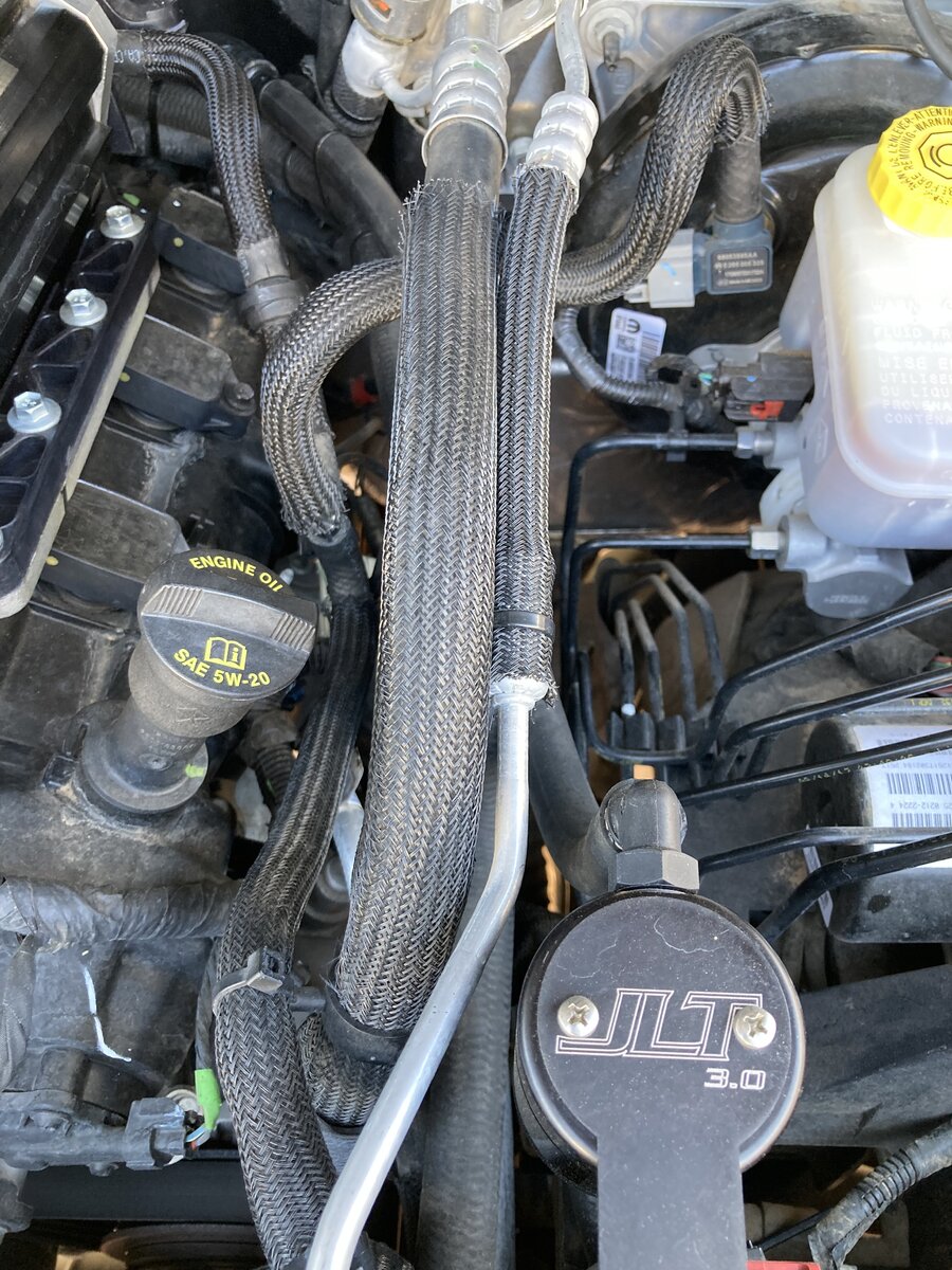

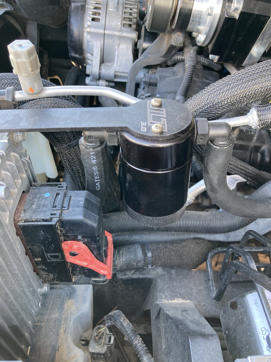

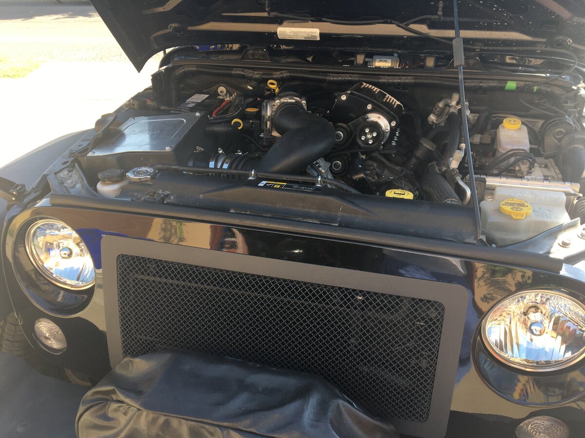

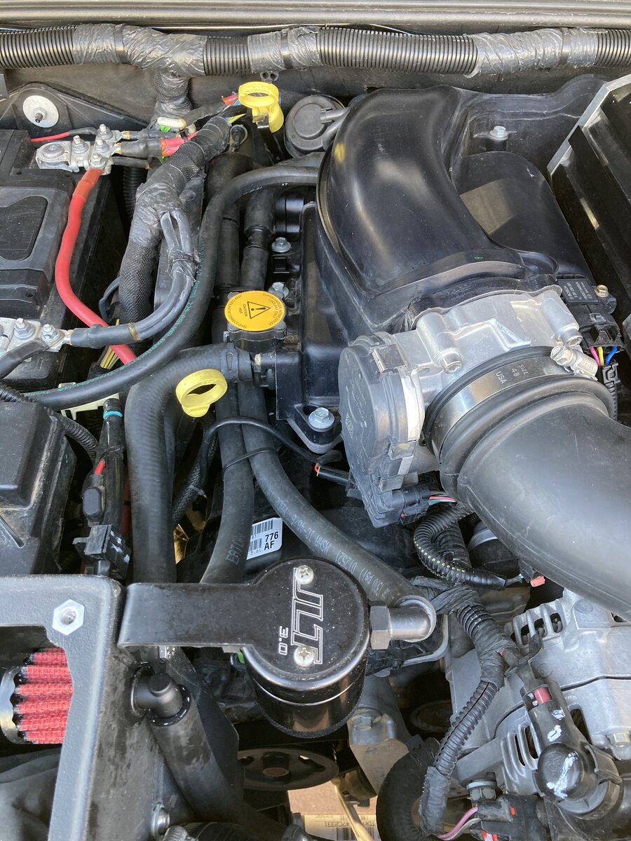

just install two oil separators (catch can) on my 2017 JK two door. Why two, I have a Sprintex Supercharger installed. One on the PVC to intake side and the other on the clean air inlet to air filter box side because of engine blow by created by the supercharger.
PVC Side
Attached on PCM/Clean air side (see UNI 1/2" ID filter UP-103 aboue with 90 degree elbow attached to 1/2" hose.)

With a stock setup the PCV work fine but if you start adding mods things change. Installing a supercharger or turbo you can get blow by and the vacum to the PCV is greater too. see post where I installed 2 catch cans.
