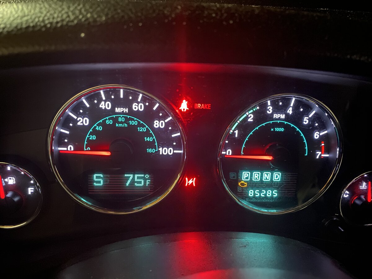

Thanks for the ad. Looking for a little help. I recently purchased a 2103 Wrangler Sahara. The Jeep had an issue with the shifter (automatic) when I bought it. At some point something broke or wore out, the small access hole to the right of the shifter was open and previous owner told me that a small green lever needed to be pushed down to take it out of park. This does release it, but I want to repair the issue I have replaced the brake lite switch, whole shifter mechanism, and still nothing. The dash states “vehicle not in park” and all the drive gear letters are surrounded with a square box (pic attached). I have power down to the shifter when I step on the brake pedal, the small solenoid (blue in color) under the
Shifter works when I put 12volts to
It and pushes
The green lever down to release the locking mechanism. I’m totally lost !!!! Reverse lights don’t work, and it says “vehicle not in park” on the dash. Any help would be appreciated!!!
