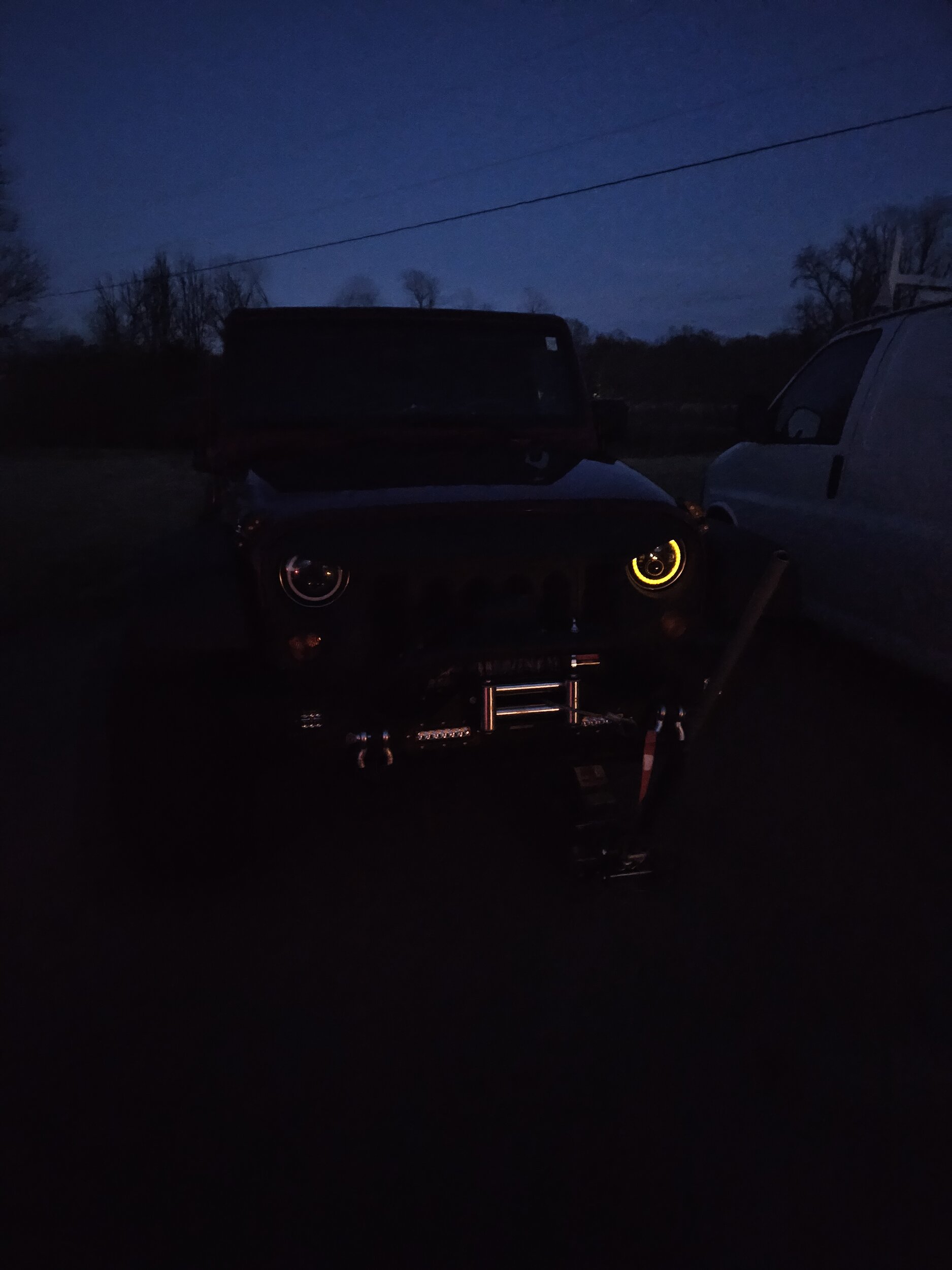

Hey just had that issue so since it's the right headlight it's a little harder too get to then the left .all you do is pull out the airfilter box and the wires to the headlight are are visible and wiggle the wires they should go on if so disconnet each plug and put some dye electrical grease on the prongs grease on all 3 plugs and then wrap them tightly with electrical tape ...good luck
