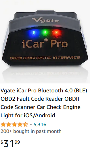

You really cannot work on modern cars without a code reader. For a JK, download JScan and order one of the suggested OBDII dongles from Amazon. It'll cost you less than $100 and you'll have required information.
Glad you got it resolved.
Now, get yourself and OBDII dongle, as mentioned earlier and download the JScan app.
This is the one a lot of us have:
This and the VIN license for the app will cost you less than the t-stats you replaced.
