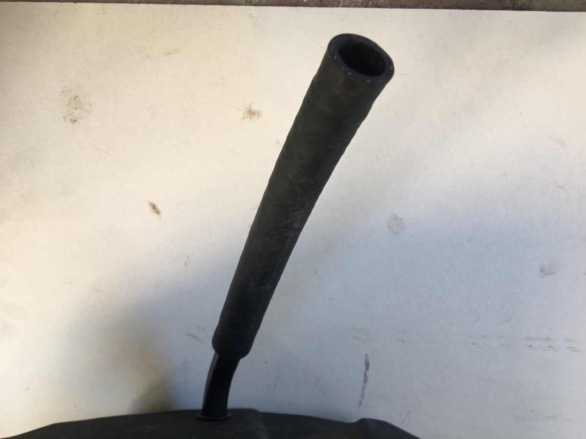

I installed a Spintex Supercharger on my 2 Door sport.
The inlet duct is designed to connect to stock air box and I have Airaid box.
An easy fix, parts needed:
Drill 3/4 in. hole in airaid box.
Cut 68083250AB-C PVC Tube as you see in picture.
Insert Crankcase Breather Filter through 3/4 in. hole in Airaid box and attach cut 68083250AB-C PVC hose and rubber hose. (See Picture)
Attach other end of engine breather hose "C". (See Picture)
Attach 4.25" in. end of Black Silicone Reducer to airaid box.
Cut 3 in. Sch 40 PVC 45 elbow as you see in picture.
Install cut piece of PVC between the 3.5 in. reducer and inlet duct. (See Picture)
I have on order a A 3.5 in. O.D. piece of aluminum 45 mandrel bend pipe to replace the PCV piece.
- 4.25" to 3.5" inch Black Silicone Reducer Coupler Turbo Pipe
- Crankcase Breather Filter, Clamp-On, .625 in. I.D., 1.50 in. O.D., 1.50 in. Length
- 3" Sch 40 PVC 45 elbow
- Items remover as part of the Supercharger install:
- 68083250AB-C PVC Tube
- 5/8" I.D. Rubber Hose
