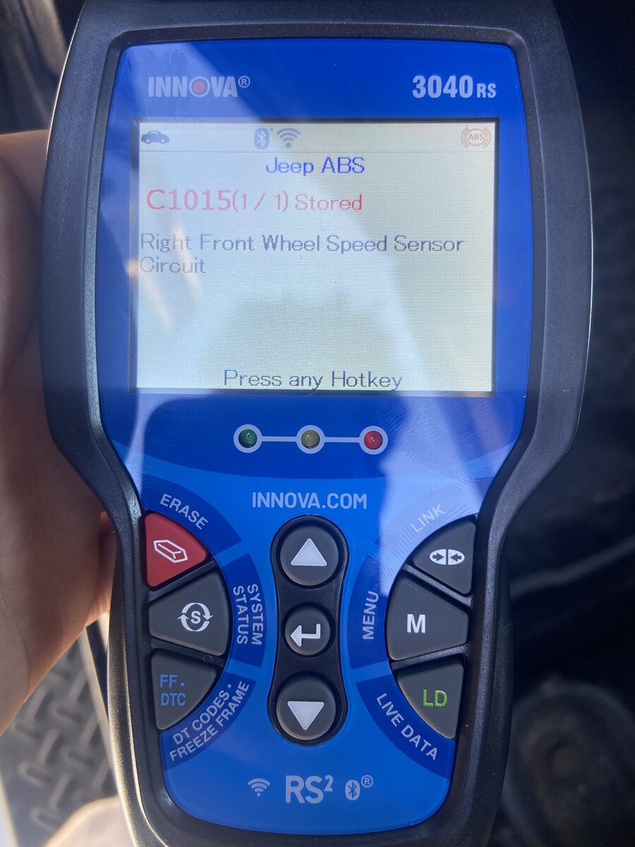

most OBD scanners don't identify wheel speed sensor or abs problems, I have the same thing going on with my jeep, pain in the butt
Reactions: Chris
Had the same problem, this scanner worked today for me. $90
Check your cruise control. If it doesn’t work it is probably a wheel speed sensor. Happened twice to me. Both times it was the sensors. First left rear then the right
