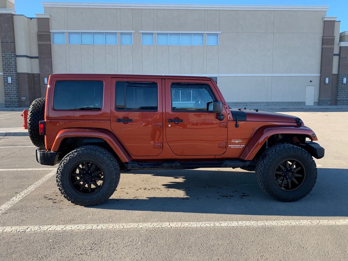

Hello Fellow Jeepers,
This is my first post so be gentle. I have a 2014 Copperhead Pearl JK with a 6 spd transmission. When cold the tranny does not make this sound. When up to temp it makes a distinct clicking sound when in 3rd gear only ( when under load, foot on the gas ) . This sound goes away when I push the shifter forward OR pull back ever so slightly. The tranny operates perfectly otherwise. I have messed around with AMS and REDLINE fluids and nothing makes a difference. I have read numerous articles and have found a few that have had the same issue and it was a struggle to actually figure out what's causing this sound. I know this tranny isn't the best and I don't expect it to operate like a sports car but it is quite annoying. I am thinking that since the shifter has a lot of play upwards when in 3rd ( 3rd gear only ) there is something up with my shift tower? I am thinking about installing a B&M shifter tower as the reviews state it is very stiff and positive during shifts.
