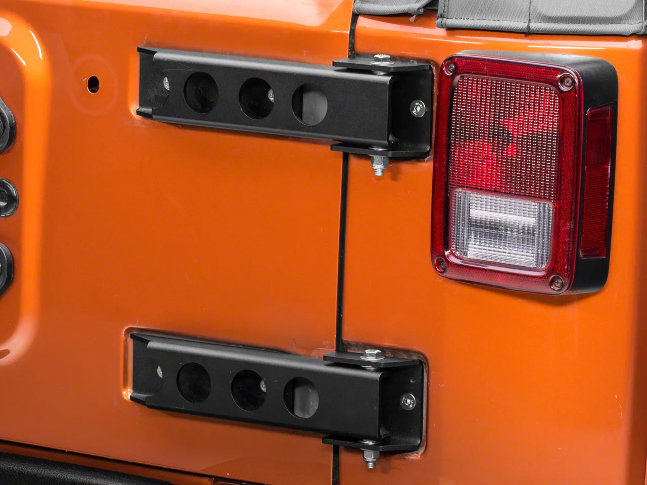

As far as the tire carrier, It will stick out more than the stock tire but a 33 will be fine. I did have to replace the hinges on mine due to previous owner shenanigans, but I just got the upgraded hinges, carrier is still stock. Someday perhaps I'll upgrade it, perhaps
I'm not sure what my jeep had been through before I got it but I keep finding strange things, and you may as well. For instance when I was poking around behind the glove box I discovered the male side of a power plug, cigarette adapter type, still have little idea what it's suppose to power, best guess is that some previous owner had a CB in the jeep. Probably why l had to replace the rear hinges, though it still had stock wheels and tires on it. Hell, my first 'mod' was replacing the entire rear brake system, everything was rusted solid, calipers, rotors, and all.

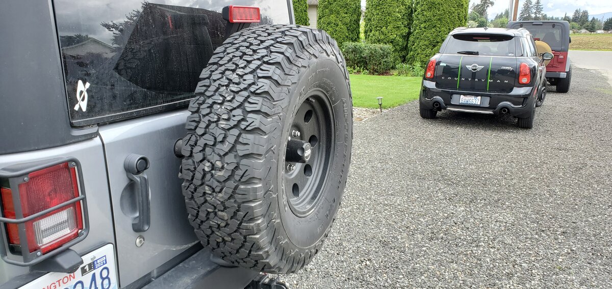

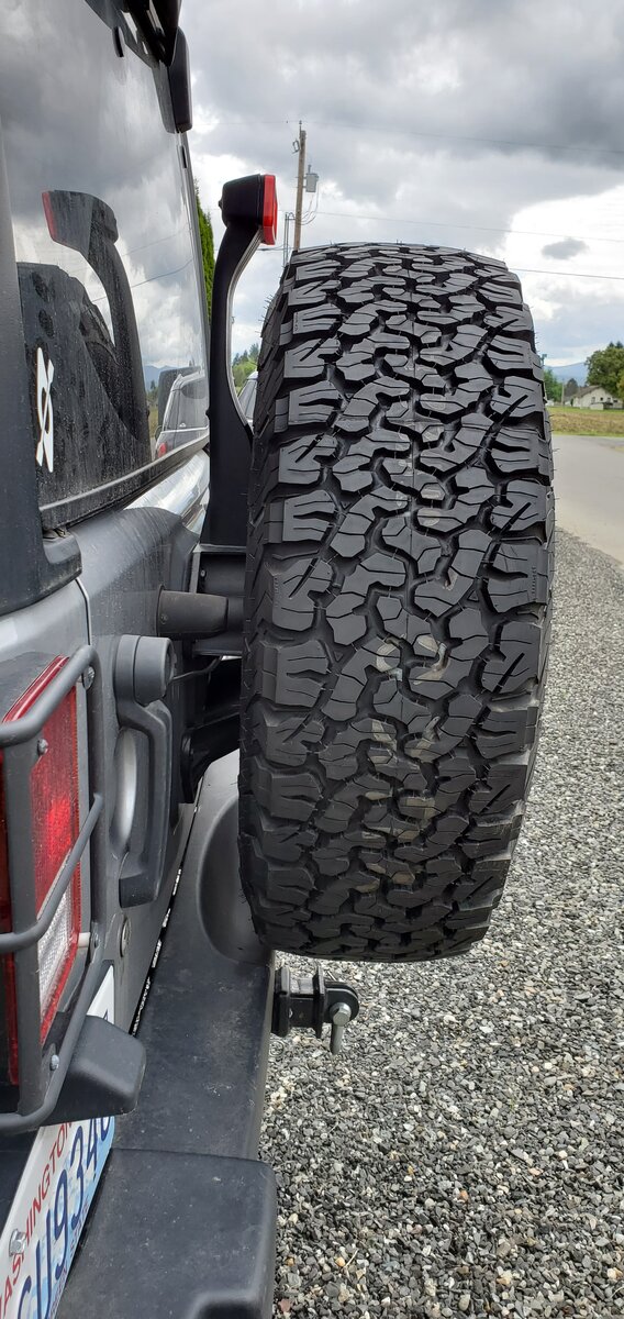

With stock wheels, they won't fit. You'll need a wheel with 5.25" or similar backspacing. The stock wheels have 6.25" backspacing, which won't allow it to bolt to your spare tire carrier.
With a 33" tire, I would strongly encourage switching to the Teraflex tire carrier or similar.
At that size, the tire is starting to get very heavy and put a lot of stress on the tailgate hinges. This tire carrier takes care of that and other issues.

I would love to get one of those full carrier kits as well, however I took the budget path because the hinges on mine were bad when I bought it.

The problem you run into is the stock wheels are 7.5" wide, and to run 12.5 " wide tires should have at least a 8" wide wheel. If you go with a smaller whee the tire won't wear correctly.
As for your carrier question, my buddy had his tailgate fall off from carrying a 33" x 12.5" tire. It took years, but something you should consider upgrading soon.
