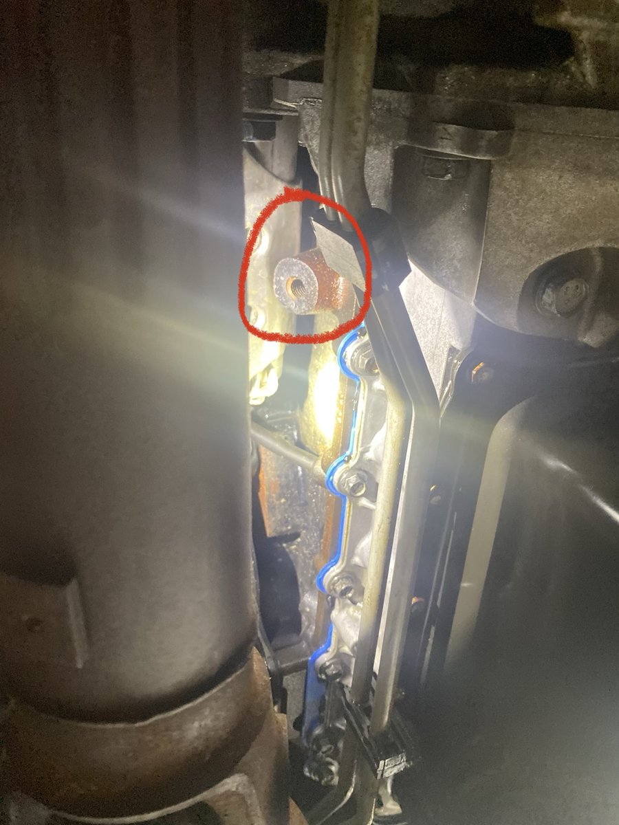

I own a 2008 Jk 3.8L with 67,000 miles. I am a little new to the Jeep world and discovered the very common oil leak on the 3.8 motor. I noticed there is no oil coming from the valve cover gasket. Therefore, I figured it was the upper oil pan gasket. I replaced that gasket and still have a small oil drip. I noticed a bolt hole next to my oil pan that I was missing a bolt. I did some research on forums but could not find an answer as to what this bolt hole is for. Forgive my ignorance, like I said I am a little new to the Jeep world. Could anyone tell me what this bolt hole is for? Thanks
Without going out and looking at mine i'd take a guess and say it's just a location for a accessory to be bolted to the block. These engines are used in the T&C Vans also so it might have been used for the T&C's.

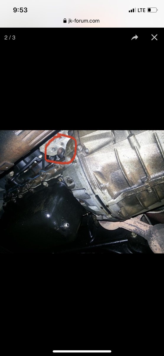

It kinda does look like oil at the bottom of the Bellhousing area in your first picture. If it is it could be the rear main seal.

The first photo isn’t of my jeep. It’s of one I found on a forum with the bolt in place. The second photo is of mine with the bolt missing. But thanks for the reply. My oil leak is very minor. Just a couple drips I noticed on the garage floor.
