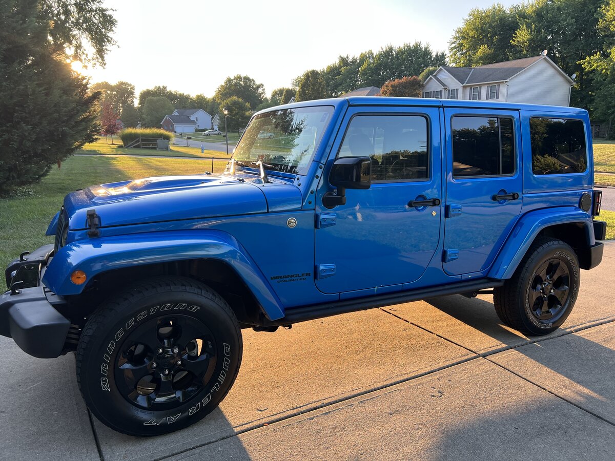

Hello! Just purchased a 2016 Unlimited Altitude. Looking to add a 3” lift. Wanted recommendations on a kit/brand. Also I am curious on how long the average mechanical person takes to install the kit. Planning on doing 35” tires, KO2s on my current 18” rims. Jeep is a daily driver, light off road driving, not much around me to do rock crawling. From what I understand, I’ll need spacers for the tires also.
Thanks!
Nate
