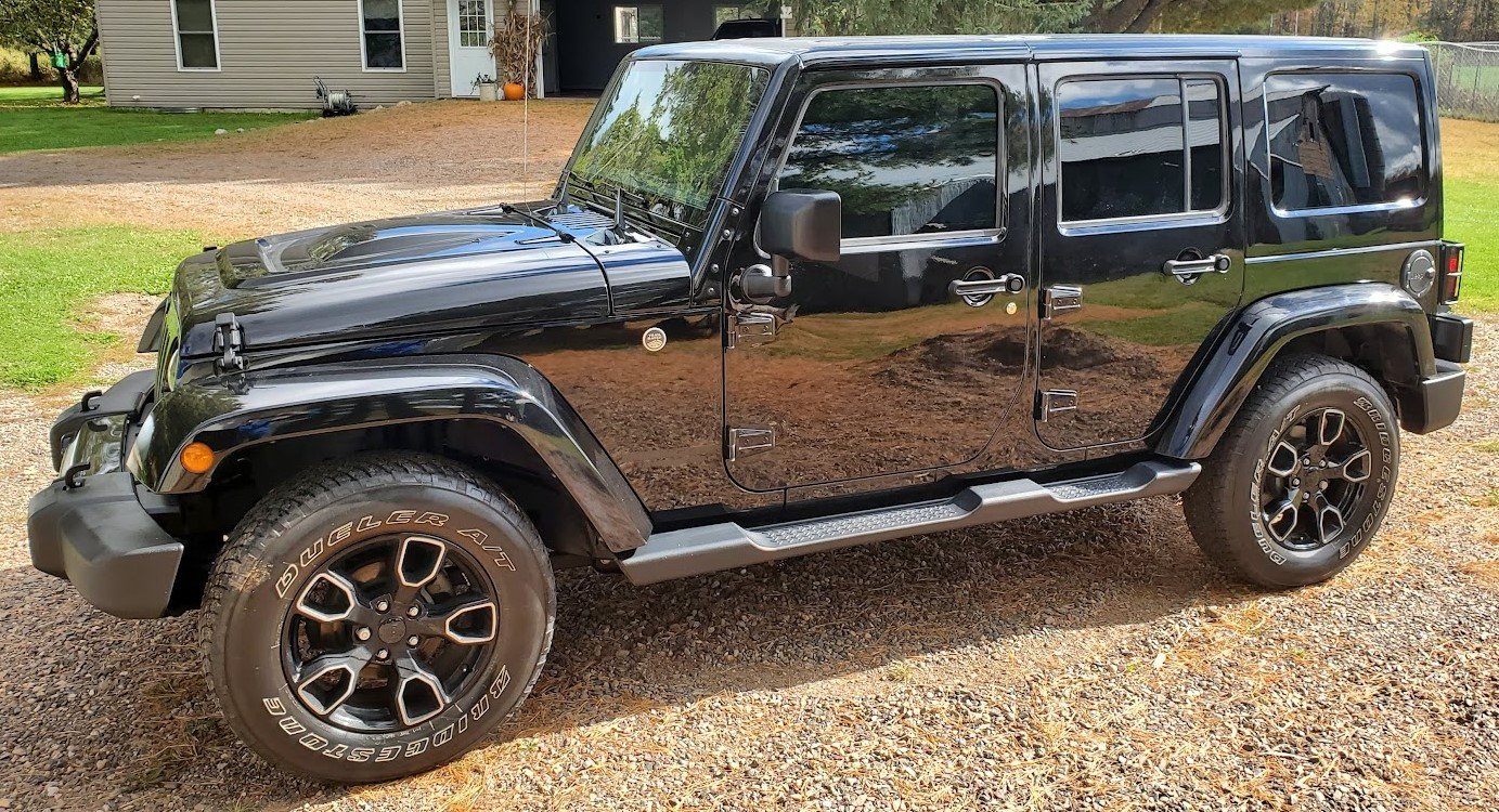

I've got a JKU with 18" stock rims and a set of Bridgestone Dueler AT (255/70R18). It's time to get them replaced, and I'd like to upgrade on size/performance without hitting $300/tire or buying new wheels.
I'm in the midwest - these tires will see a lot of snow and some light offroading.

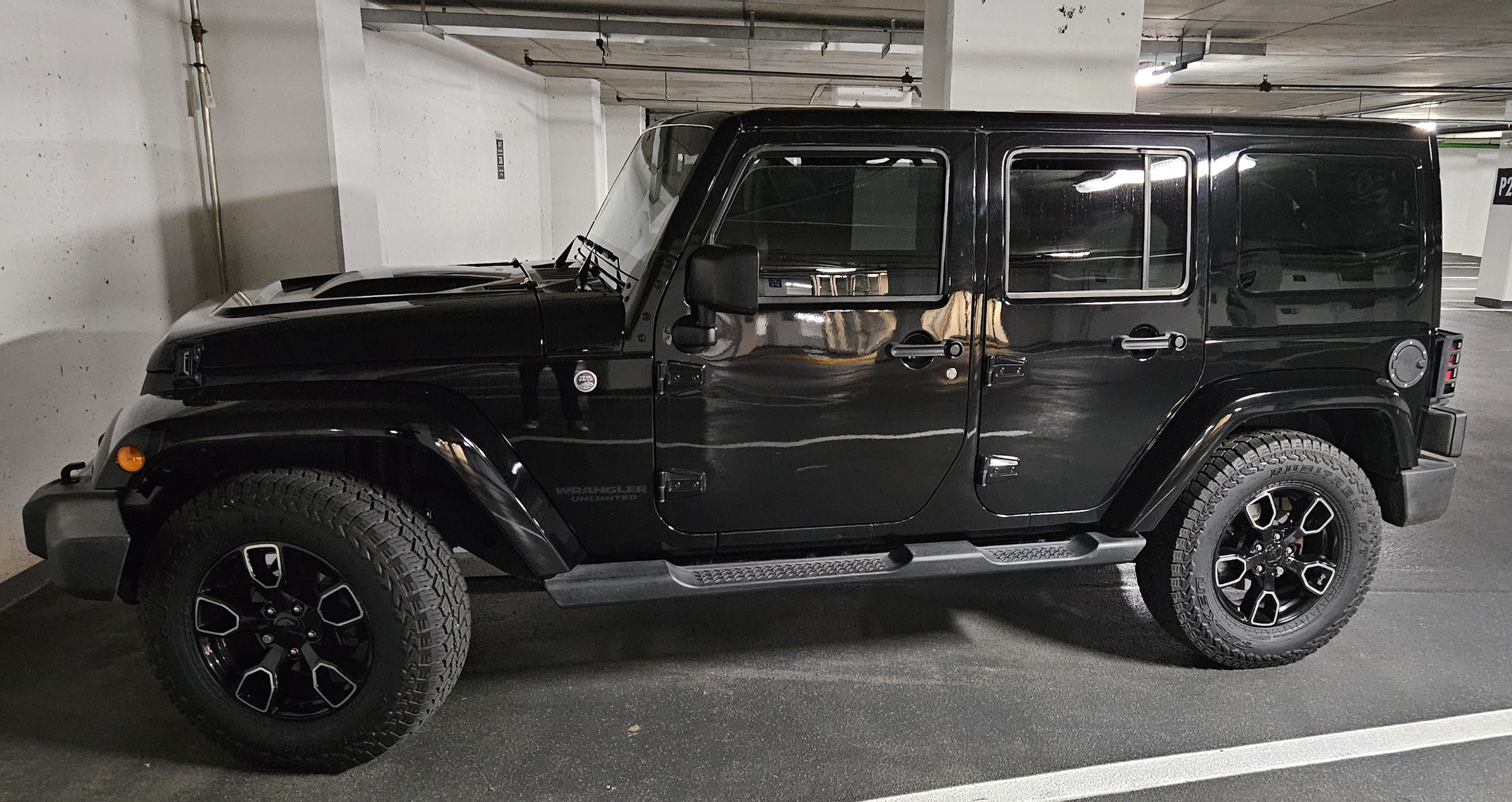

I just ordered the Falken Rubitreks @ $191 via Amazon. A slightly larger diameter than my OEMs and a more aggressive look. I think I'll be happy, and will report back once I get some miles on them.
Quick update on Falken Rubitrek AT 265/70R18 116T (5 tires @ $955.35 + tax) when compared to stock Bridgestone Dueler AT 255/70R18 112S.
Comfort: ride is better on the Falkens, more forgiving when driving over bumps/potholes. This is with both sets of tires @ around 40PSI, but after reading up on this it looks like I'd be better off dropping to 35-37.
Noise: less road noise on Falkens, noticed this immediately. I didn't expect that given the more aggressive tread. Bridgestones would also squeal very easily when turning slowly/sharply, particularly in parking ramps. Falkens are quiet in same conditions.
Visually: I noticed the extra 1/2" diameter/width immediately, and I dig the blacked out look and tread.
I am getting a bit of rub on my sway bar at full turn, so I'll be hunting for 1.5" wheel spacers to addresss this.
Looking forward to playing in the snow in a few weeks. Thanks again for the help!

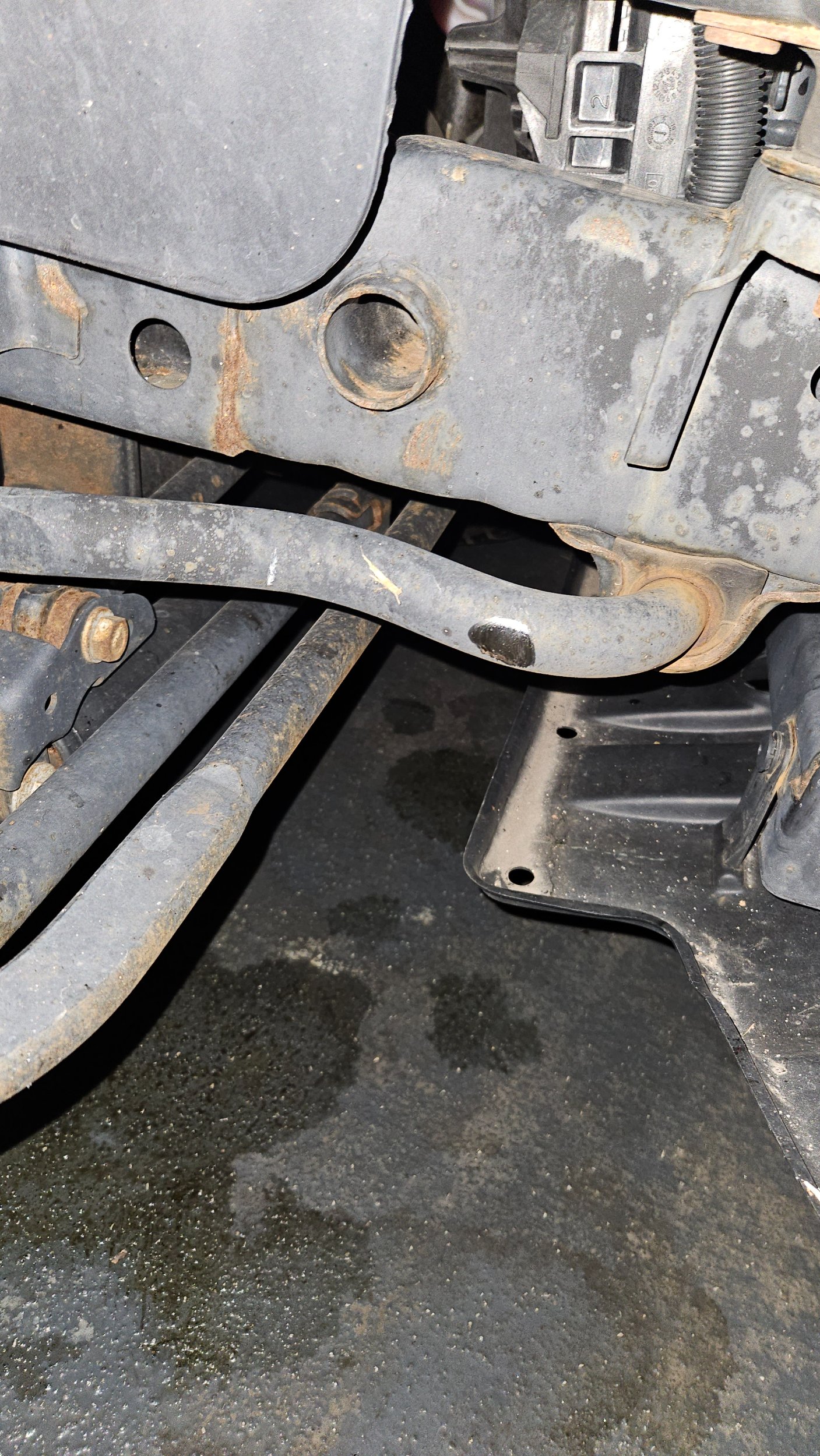

Fronts rubbed against the sway bar as pictured, but I solved that by placing a thick washer under the stop bolt on each side.
I still need to address the TPMS issue.
