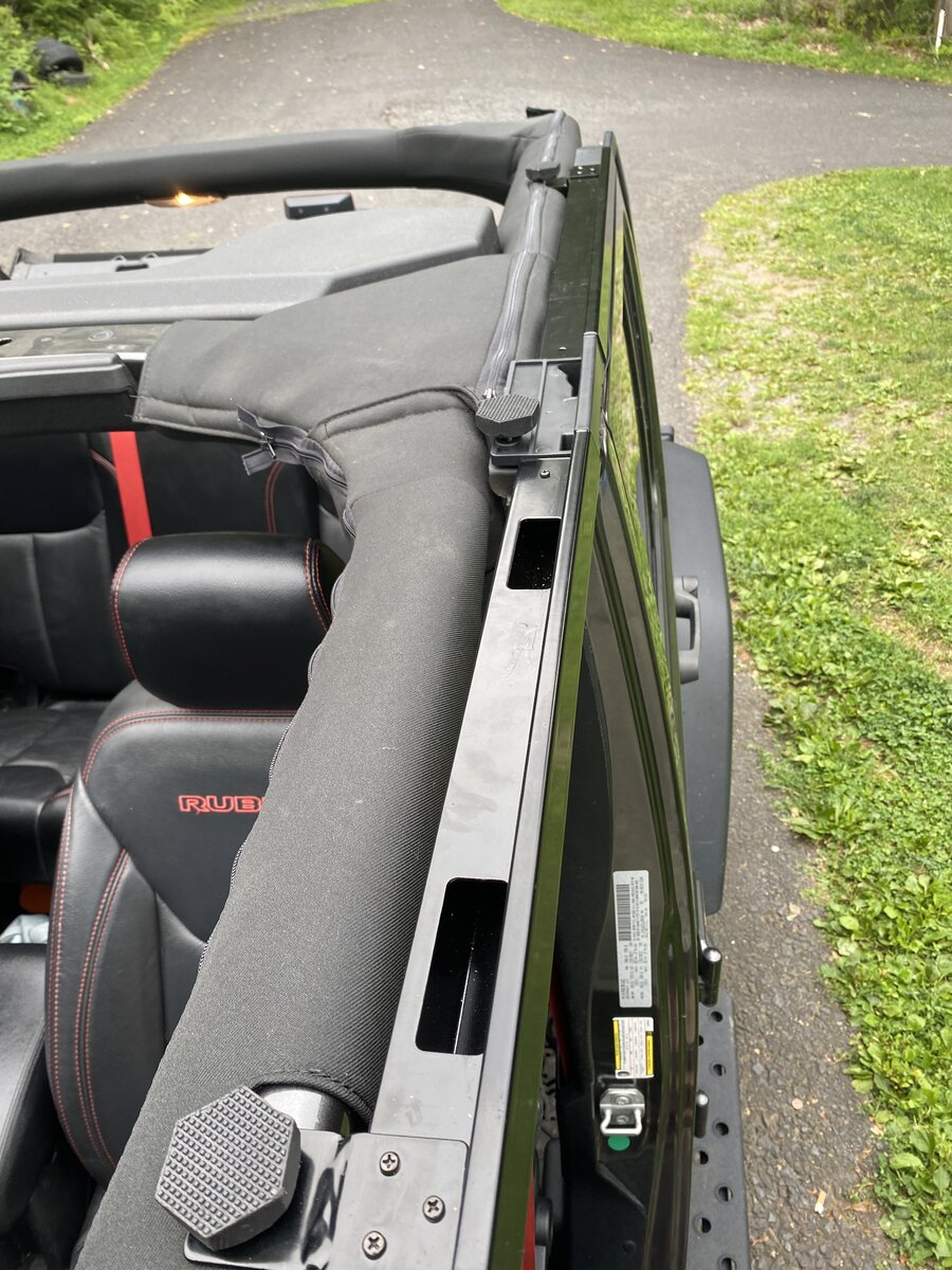

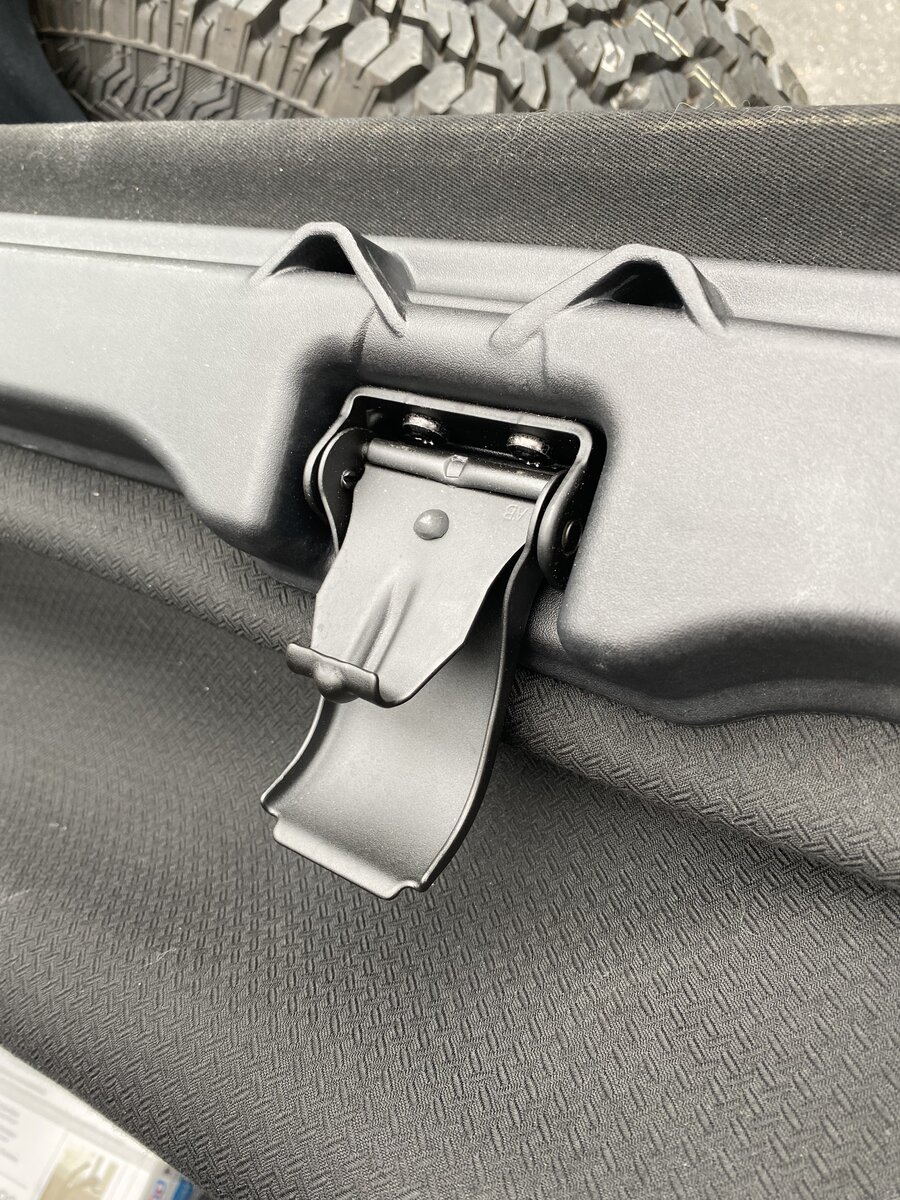

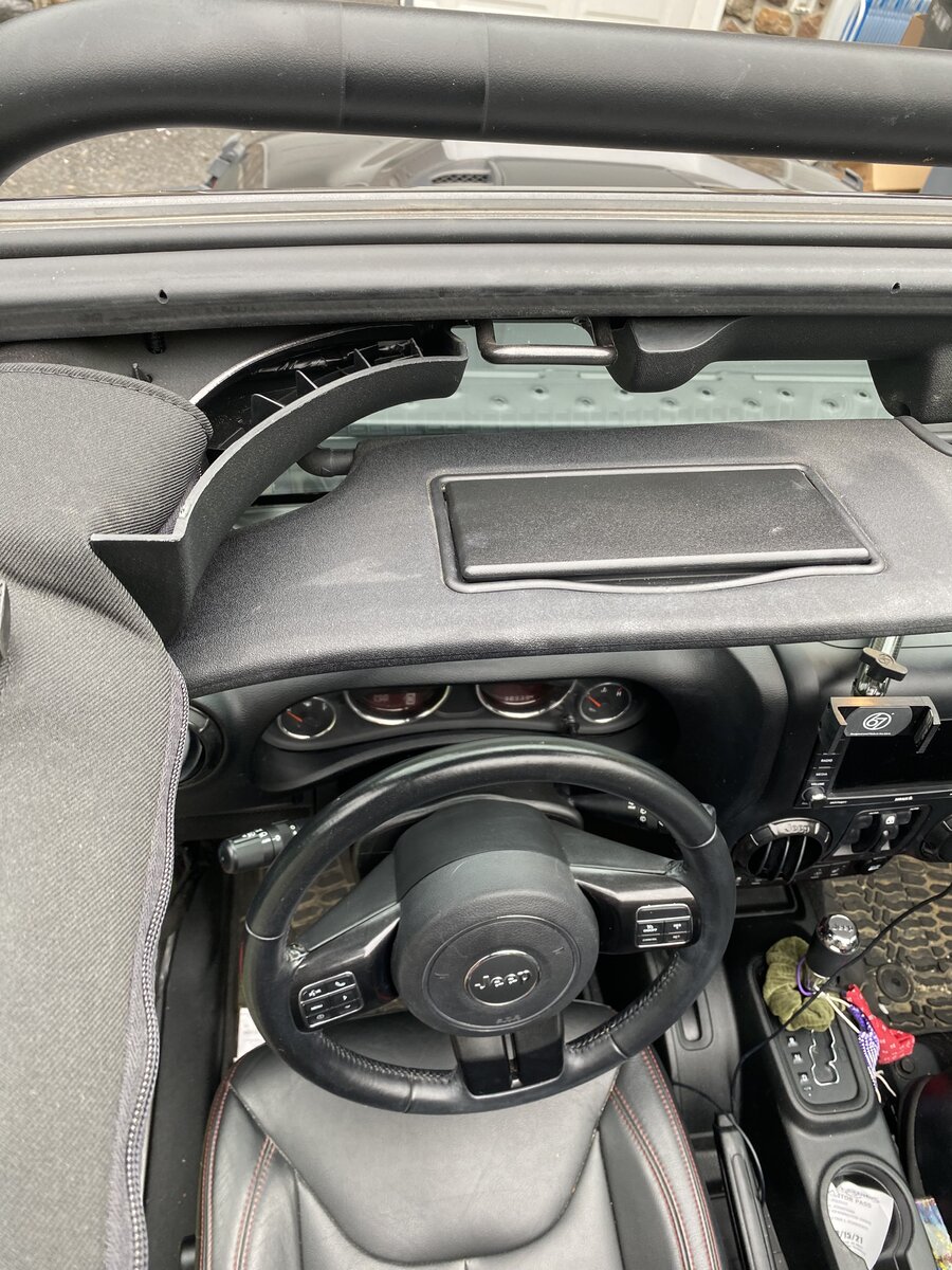

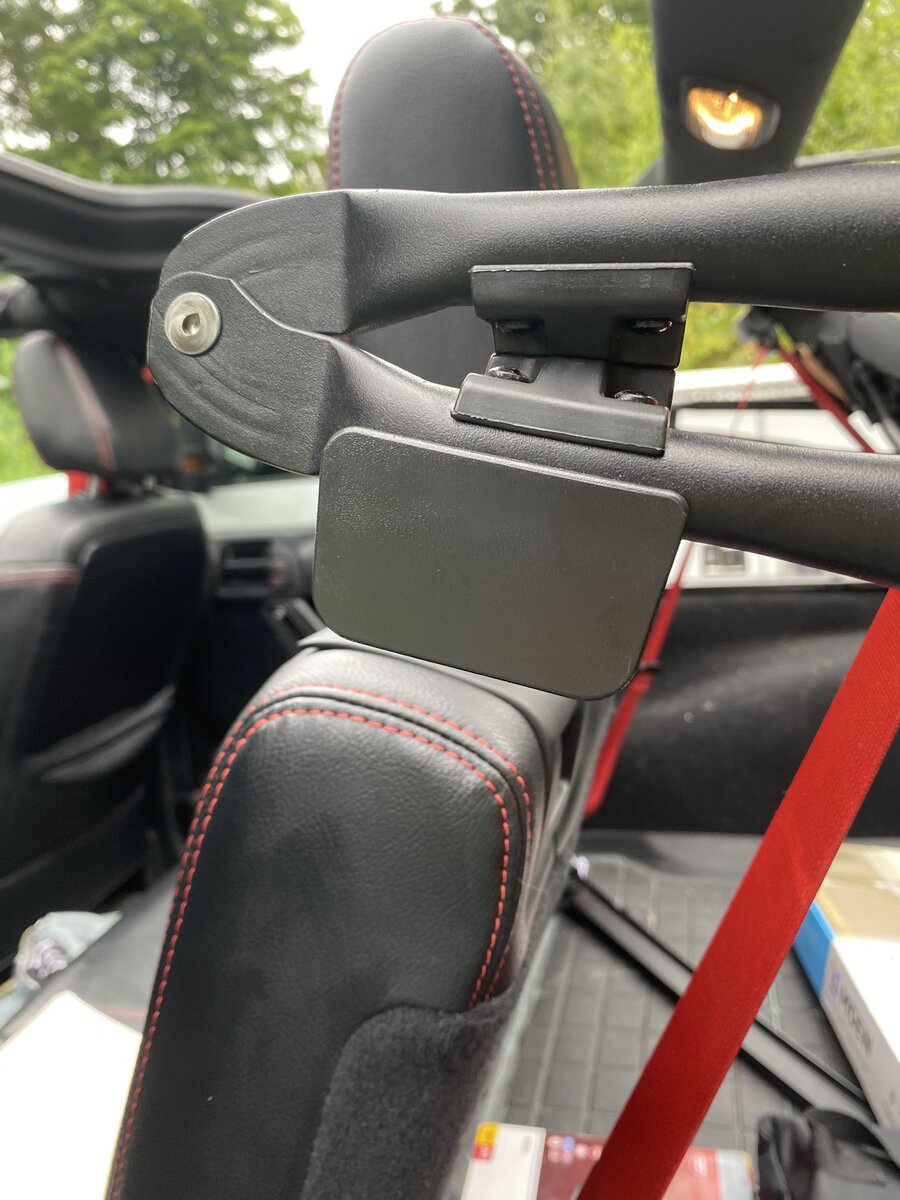

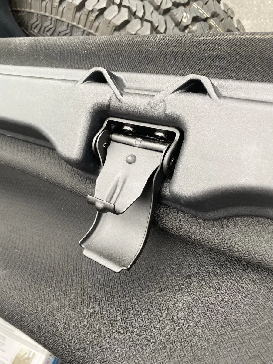

Hello! I purchased a JK Unlimited Rubicon used. It came with a soft top & no door surrounds. I stupidly purchased door surrounds that I was told would work and now I’m not sure if they gave me a top that doesn’t work (with my model) at the dealer or I simply need a different style door surround. I am in PA, I don’t have much longer to ride with the top down and I am so bummed but I do want to get the right piece for the doors to make the top work so I can resolve this and easily put on ans off when I want to. The thing that also makes us wonder if this is the righ top is that there are these little notches where the top latches that don’t seem they will fit at the top of the window header. We haven’t been able to get it to stay to try and latch. I’m attaching photos of all and hoping someone can help me! Thanks so much

Did you get those from Xtreme terrain? If that is the set that I found, then the problem is that they are designed for a top w/out the sunrider feature, which the one you posted has. So keep that in mind. I would demand a refund from them, I've used a number of soft tops and the video was not clear to me that it would not work with a factory top.

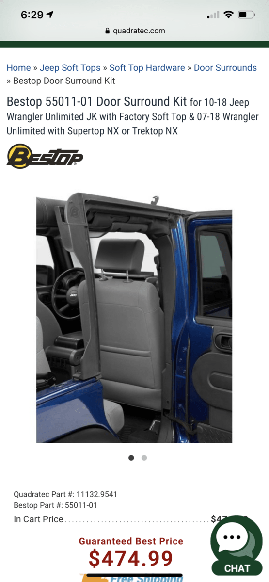

https://www.quadratec.com/vehicle/2007-2015-wrangler-jk/soft-tops/soft-top-hardware/door-surrounds
here are some options. Like I said, the bestop is the one you should a have received, and would probably be the best made.
Just ensure that the one you pick up is four door version

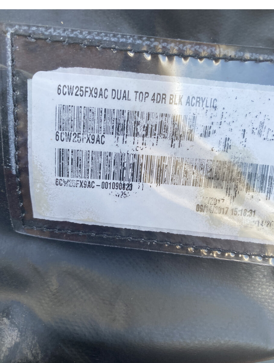

I tried and tried to search the model number on the cover for the dot top but I couldn’t find it online. I even stopped at the dealership where I purchased my Jeep in January and I also included the model number of the top on the bag (cover for soft top).
I just want to be sure this is the set for the link you posted that I would need.

Also- my husband thinks this top isn’t for my model Jeep because it has these two nubs by the latches that don’t seem like it will work. I’m unsure of that part. I don’t know if they’re all like that and it is able to latch down on the rubber or not?
Those tabs are normal. Nothing to worry about there.
The sunrider top feature is the ability to fold back the front of the top. In your second picture, the plastic part runs on a rail that is part of the door surrounds. The other side of the rivet is a peg that locks into the door surround to allow that to happen. You can see the latch sticking up in the picture of the surrounds you posted.
The number you have from the cover believe is just the package number for the dual top group. I've never been able to find an effective part number for soft tops, at least not from the tops themselves.
The surrounds you linked is the proper one as far as I can tell from your pictures. You have the windows right? If you are able, a zoomed out pic of the whole thing will tell me more. But I'm almost certain you just have the OEM top and the previous owner either sold, or tossed the original door surrounds.
Post any other small parts that came with jeep. There are a couple plastic items that clip on either side of rear tailgate that hold the rear window down. The kit you linked comes with the rear window bar.

I guess what I was trying to say is because we bought the jeep used and I made a big stink about wanting a soft top curious if maybe they grabbed a soft top for my 2017 and put it in my jeep to make me happy and the reason I was wondering this was because of those two little knobs by the latches my husband was thinking that it didn’t seem like it was gonna snap in there because of those knobs but because of the other problem with having the wrong doors surround- We weren’t able to fully push down the top anyway where it would reach because it just got popping back because there was nothing for the Sunrider to click into where it bends I’m not sure if you know what I mean but I think you do I will work on getting a new surrounds and hopefully that is it or I just throw the towel in LOL
I guess what I was trying to say is because we bought the jeep used and I made a big stink about wanting a soft top curious if maybe they grabbed a soft top for my 2018 (& gave me one for an older or different model) and put it in my jeep to make me happy and the reason I was wondering this was because of those two little knobs by the latches my husband was thinking that it didn’t seem like it was gonna snap in there because of those knobs but because of the other problem with having the wrong doors surround- We weren’t able to fully push down the top anyway where it would reach because it just got popping back because there was nothing for the Sunrider to click into where it bends I’m not sure if you know what I mean but I think you do I will work on getting a new surrounds and hopefully that is it or I just throw the towel in LOL

My husband says he physically could not latch the top because of those ‘tabs’ near the latch.

it’s so hard to find information on this with an online search. I can’t see to see how those tabs fir
